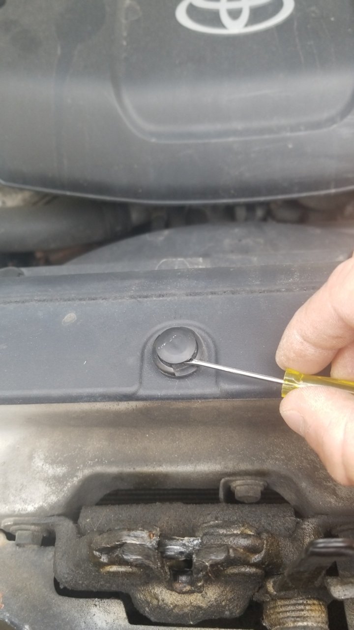

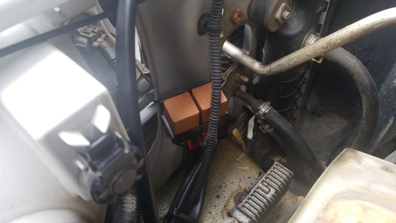

    So I finally installed the harness :)
    Totally second the Headlight Services harness.
    So overall, a pretty simple install.
    Not a video, but some pics
    First, first was to pull the battery out of the way (just removed it completely)

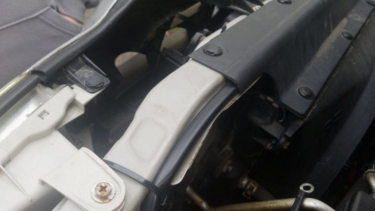

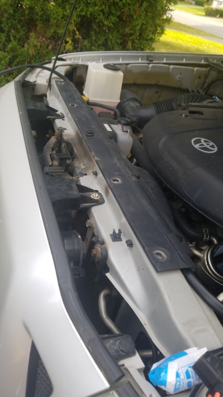

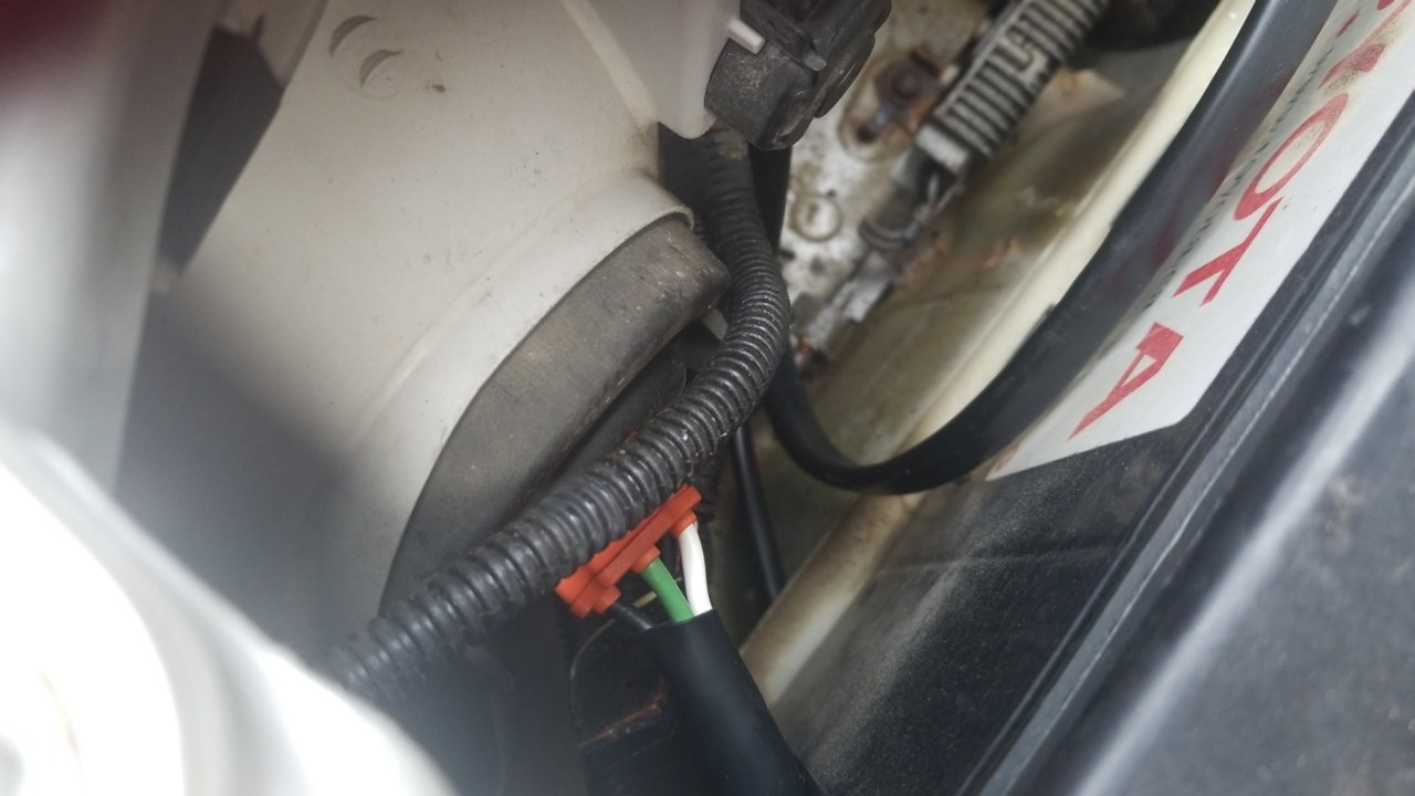

    First was to pop the pins holding the top cover that spans the length of the front of the bay between the headlight Assemblies.

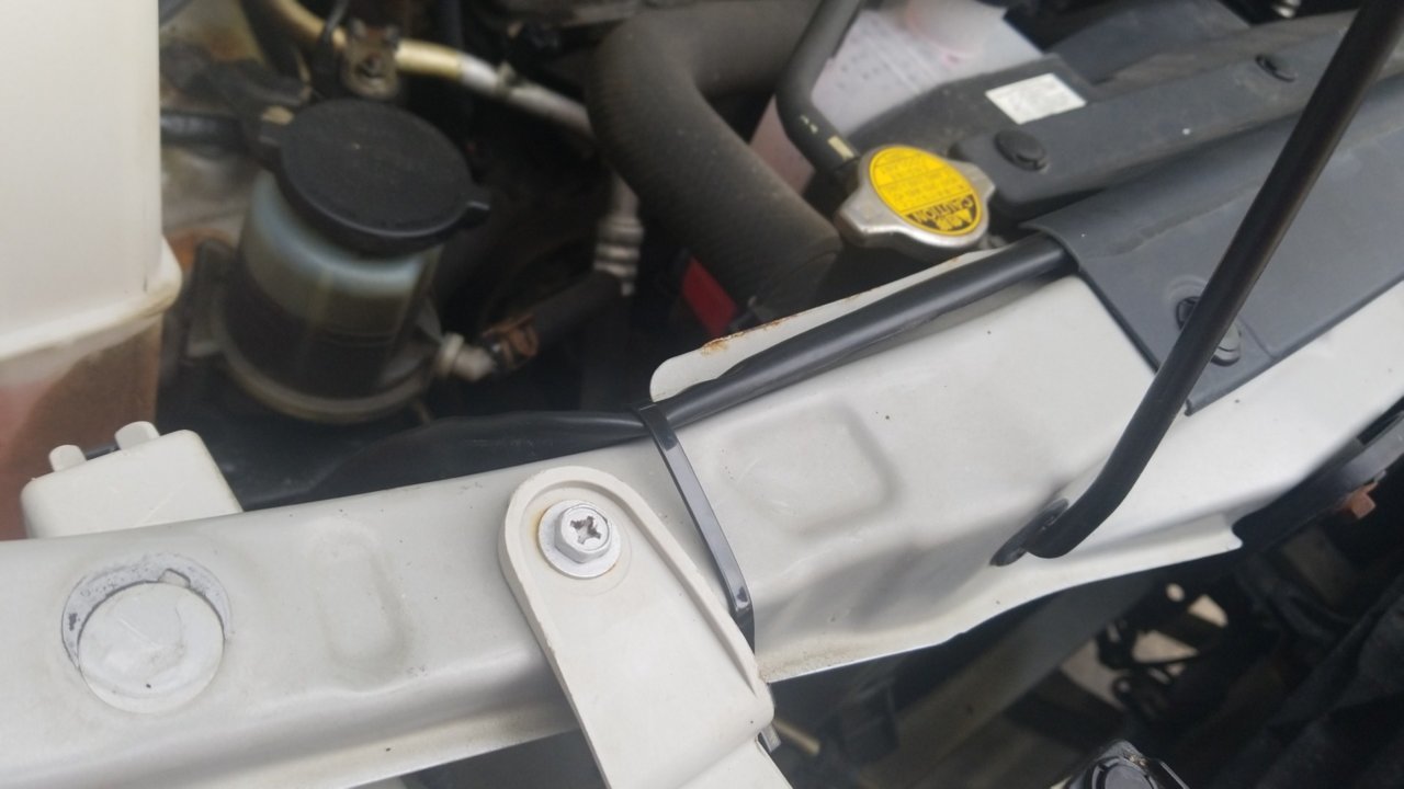

    This gave a beautiful channel to run the longest part of the harness with the two new headlight connectors between the headlights.
    I then zip tied the line in either side so it didn't slip off the ledge.

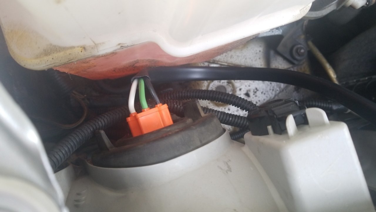

    Here is the rough length I had left on pass side:

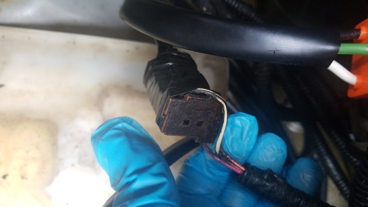

    This left the bulk of the harness (relays, pos/ground, etc in a bundle in front of the battery... Or where the battery was.
    I ziptied the relays in place because I was in a hurry, but the kit came with 2 screws that could have been used for this. As it looked like the relay holders had mount points. (The instructions I got with mine were for a different vehicle strangely, so I just made due).

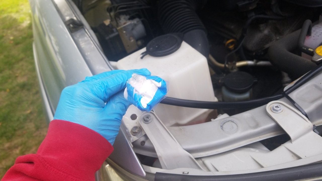

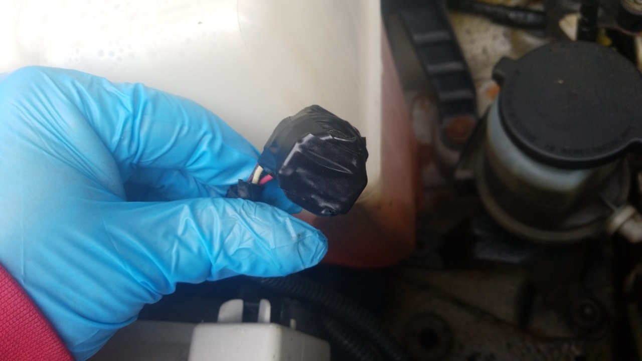

    At this point I pulled the pass side headlight socket and tapped the living jeebus out if it to keep it protected while it sits empty and ziptied it out of the way.
    Then I connected the Driverside stock to the relay input and taped it as well. Again, in a hurry.

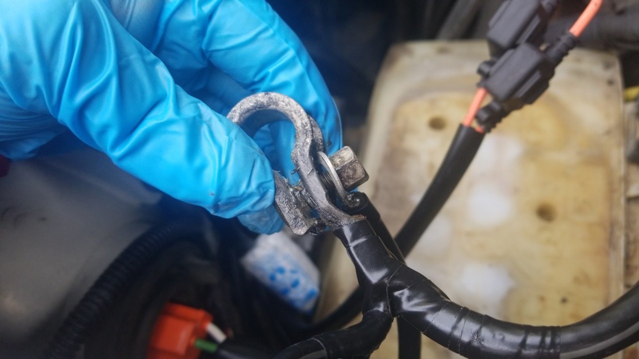

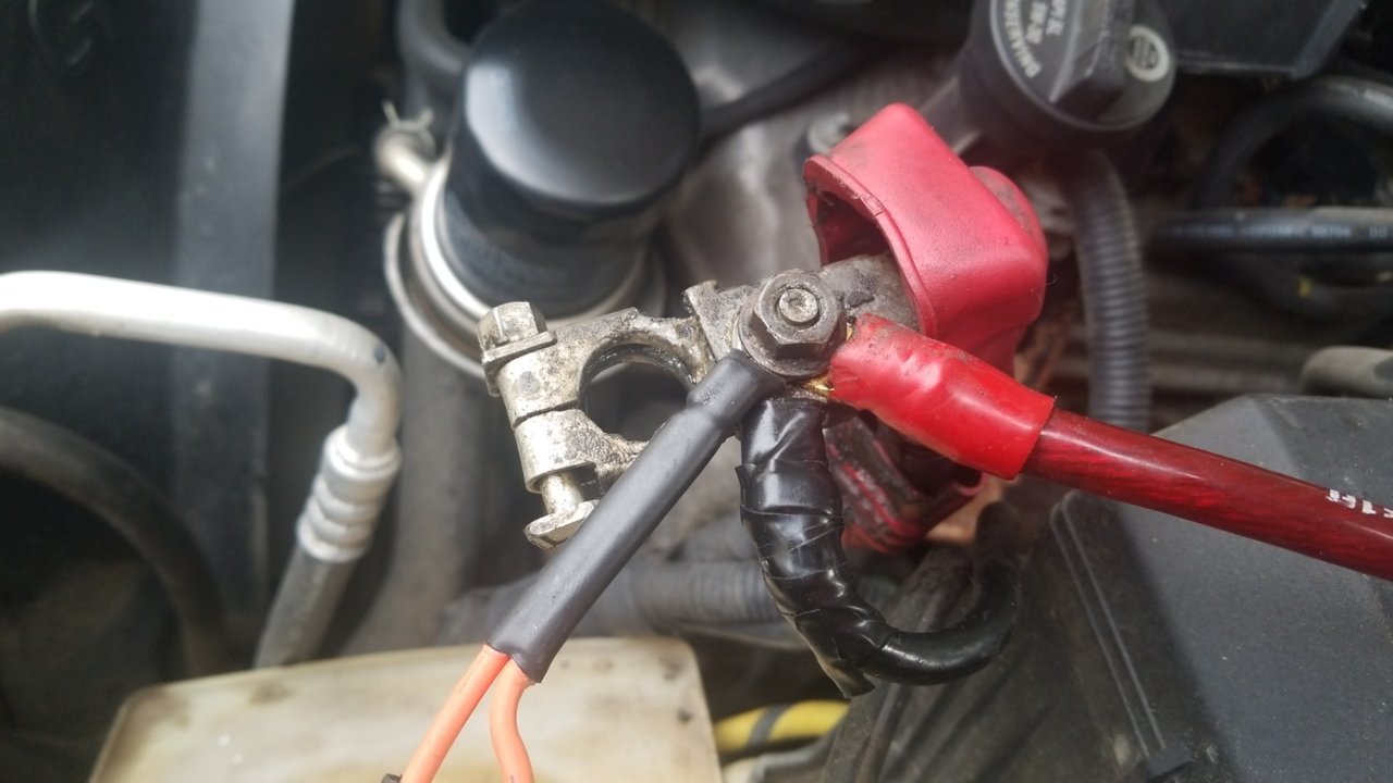

    With that done, it's simply a matter of connecting the Positive and neg/ground to the battery terminals. Mine ended up looking like this. (Had to adjust to get battery back in first. )
    (I really need to get a better terminal setup, I always hate having a stack of wires off the positive terminal... Need a bus bar or something)
    Negative terminal is cleaner, I ended up flipping the bolt in the terminal so I could have it join on the outside.
    At this point - assume battery is back in, plug your fuses in and power is now being supplied to the two new headlight recepticals.
    At this point, I swapped my bulbs.
    Drivers side: Easy, used gloves just in case, swapped it before I put battery back in, as I like extra space :)
    And Finished.

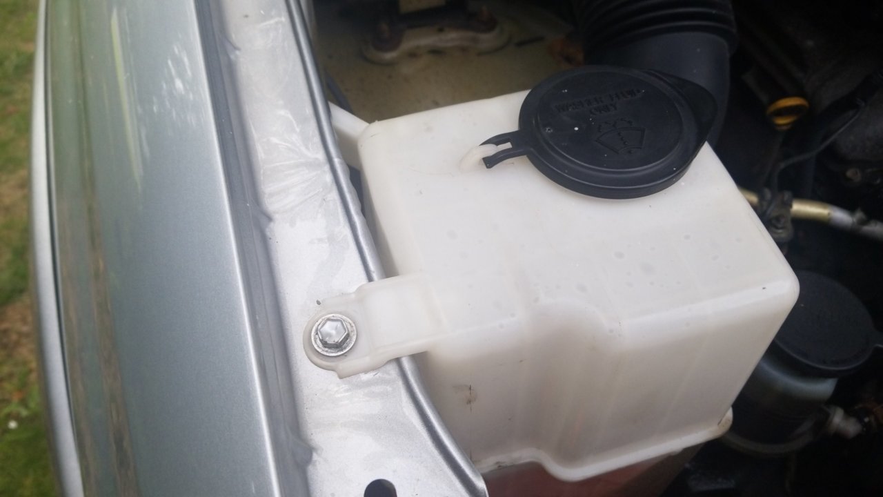

    Pass Side: I pulled the washer fluid tank. 10mm head, mine is missing 1, so I just had one to remove, and then it was easy peasy.
    10mm
    Finished.
