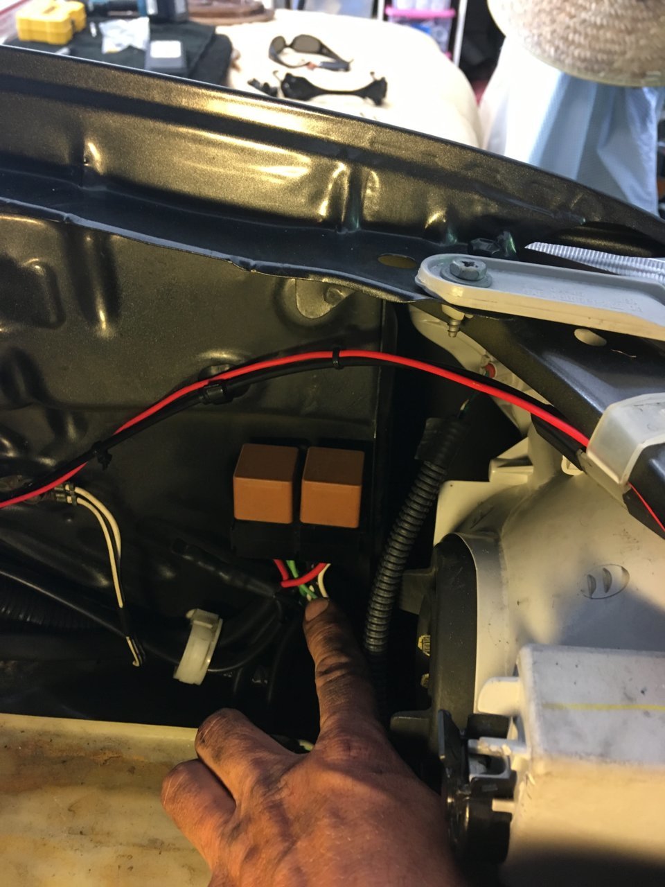

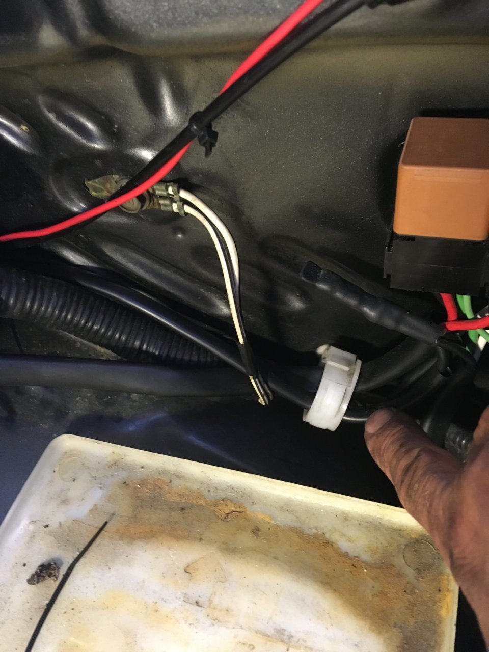

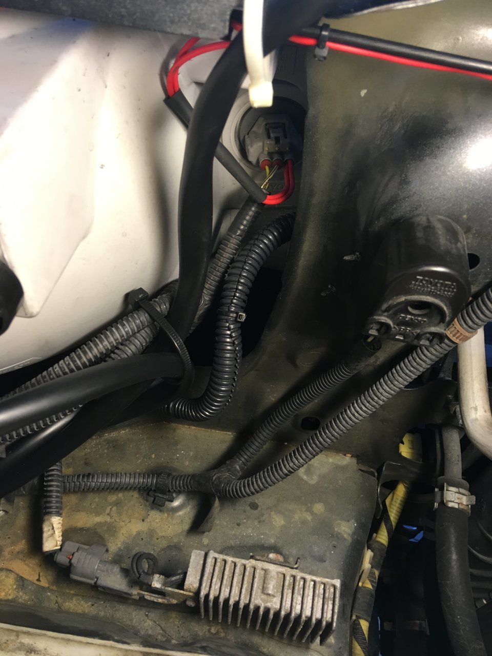

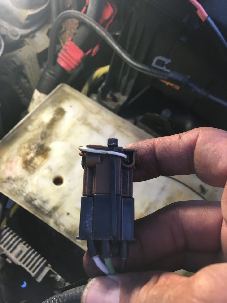

    Just a couple pics of the head light services harness duringinstall. Super quality piece.
    Ran all wiring with existing oem wires. Where the headlight harness plugs into the oem lightbulb plug, I put a tiny ziptie in addition to taping it for a security. The pic that im pointing to the ground on the fender is where the battery grounds and thats where I grounded the harness. I think that should be sufficient. Fired up the lights last nite and although hard to tell a major difference, i am still running the oem bulbs for now. 121C5E8F-E2C9-411E-BA89-1AB87D052CD6.jpg B11DA65B-28C4-4160-B072-09F132B3900C.jpg DEB1769D-D39A-457B-9C44-F3E5DB350A65.jpg

    Nice! The harness will help the output of the OEM bulbs, but the OEM bulbs are a long life low output bulb. To see the benefit more you’ll want to run a high efficiency performance bulb or a high wattage bulb.

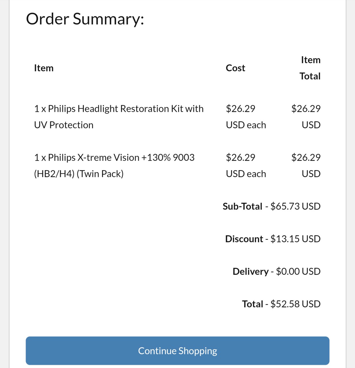

    Just placed an order. I'm not too worried about the blue coating over the high beam since I rarely use them. I went with the Philips +130 over the +150 for the longer bulb life. Also decided to give the restoration kit a shot.

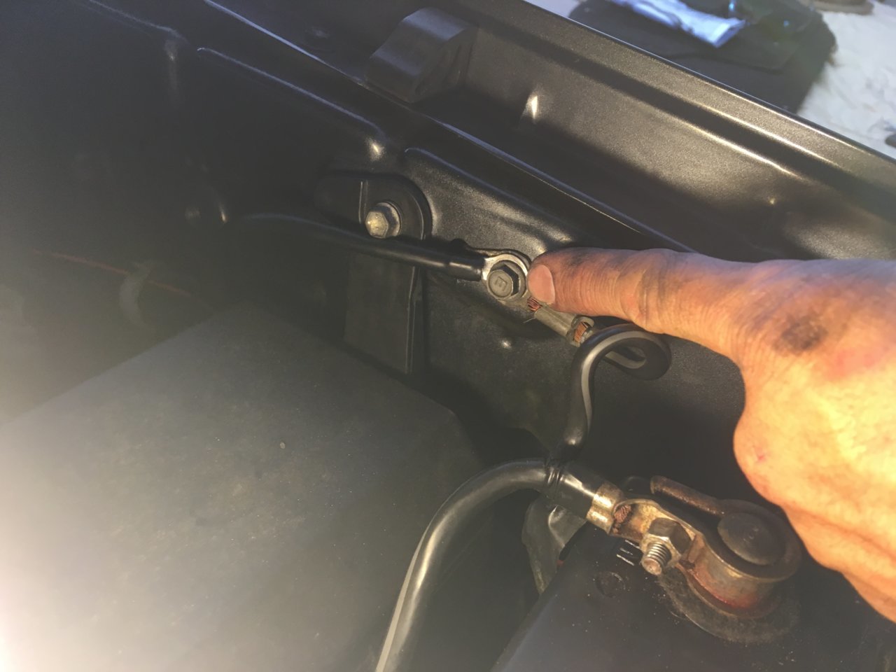

    So I installed the harness today. Very good quality. Followed the directions. Even had the same placement as @slomoe . Turned them on and tested. All good.
    EXCEPT...
    Now my front (after market) and backup (OEM) camera are not working. Radio still works. But no camera. Any ideas??

    Headlight circuit is completely independent of OEM reverse/camera circuit. Did you disconnect your aftermarket front camera power lead in installing the harness?
