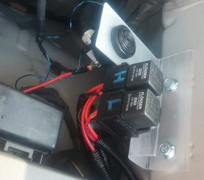

    I finally installed the harness this weekend. Here is the side by side shot, the harness on the left and factory on the right. I don't know if I can tell a huge difference although the right shot isn't focused and both were taken with my phone. This is with the factory bulbs.
    And the mounting bracket I made using plexiglass.

    What's the 'push button' like switch beside your mounting bracket.
    The left is brighter, not sure by how much though. Enough to tell the difference though.

    That is a piezo buzzer from Radio Shack. Wired up to make the truck beep when locking & unlocking it with keyless entry.

    Also where did you get your harness? Those are not the Hella relays that come in the harness I used.

    I got the harness kit from Daniel Stern. It comes with everything except the wire. You have to put it together yourself. Everything was top notch quality. I've never heard of Flosser before either but it's German. The relay holders were Hella I believe.

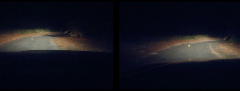

    Here's the aftermath. This is the build it yourself Daniel Stern kit with Osram 70/65w bulbs using 12ga wire. This is low beam without fog lights on. A very noticeable difference.
    This is a screenshot showing side by side. Harness and new bulbs on left, harness and OEM bulbs on right.
    Just a reminder these were taken with my camera phone. It doesn't have the best camera especially in low light.

    Wow, amazing how the new set up on the left actually improves the OEM coverage of the right.

    I see what you're saying now. Definitely. Although I'm sure my truck isn't in the exact same spot.
