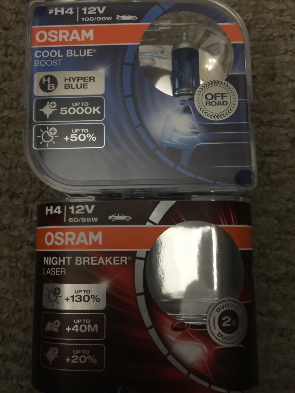

    1A2D5C1A-5DEF-4045-B93A-4BDE5BE74B7D.jpg These just came tonight. Gonna put one set in tomorrow after work. Had a tough time making up my mind with so many choices. Looking forward to more light and and reasonable life span.

    Should be an interesting comparison, the Nightbreakers will project further. You’ll definitely want the harness for those 100w Cool Blue lights.
