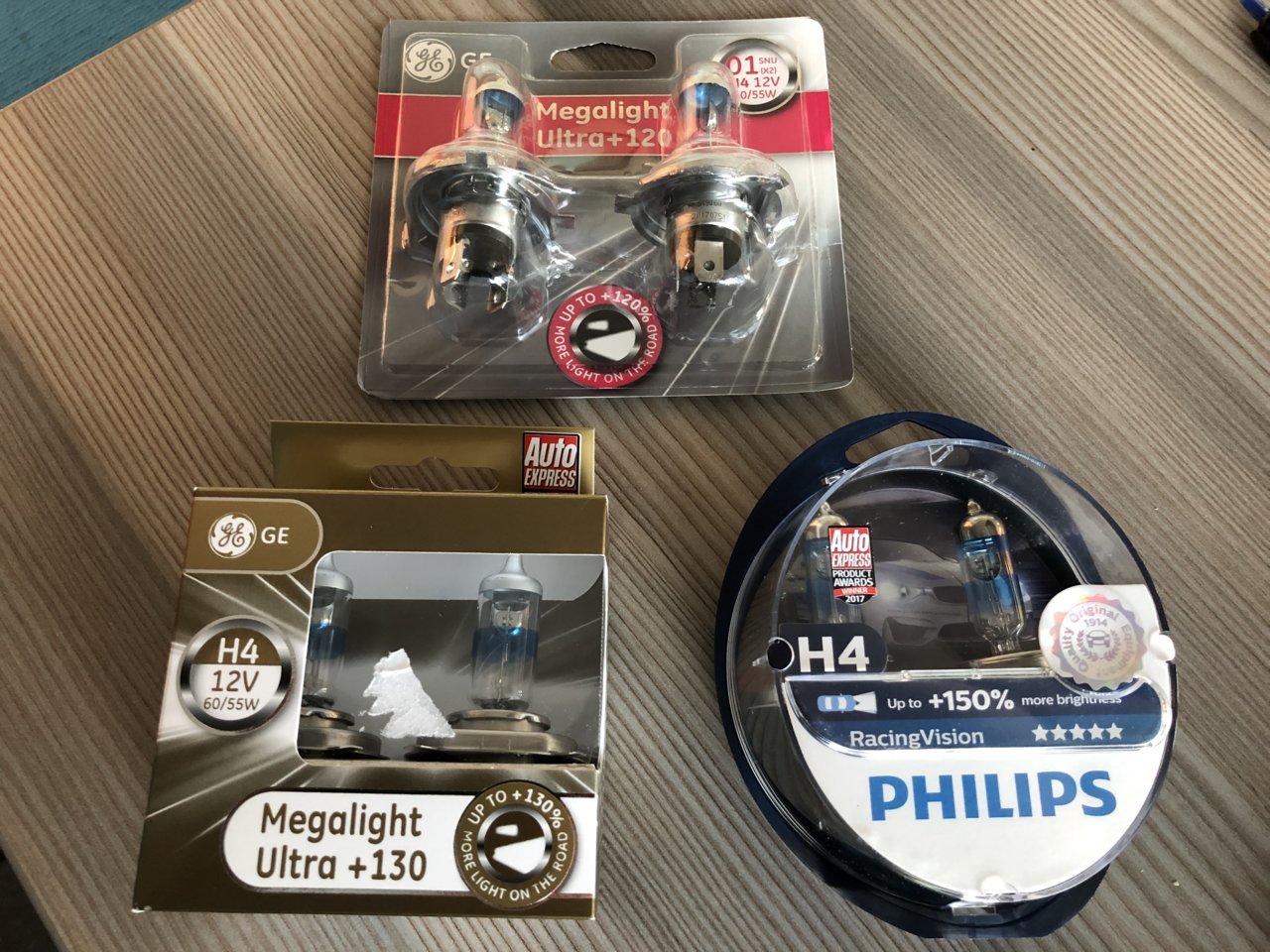

    For completeness I have added the claimed highest performing bulbs from GE and Philips, GE Megalight +130 and Philips Racing Vision +150. Ordered from Europe. The GE +130 bulbs have already been shown to outperform the Osram +150 bulbs, which is why I did not include the Osram +150 However both these bulbs sacrifice high beam performance with a blue coating over the high beam filament.

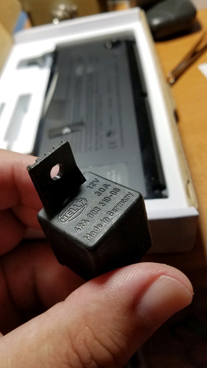

    sitting on my shelf from Hella Supertones Horns from 2005ish. Need to replace the China one that failed on my 4 extra horns added to stock tacoma ones.

    1)Buy the headlight services harness.
    2)Use OEM assemblies. If yours need replacement, go with TRD smoked OEM if wanting something more aggressive.
    3) Use Osram 100/90w bulbs for max output, or GE Megalight +120 bulbs for best distance projection while retaining high beam performance.

    Multiple packages out of Europe arrived today. Powerbulbs shipped reasonably quick, the GE +120s out of Bulgaria took a month.
