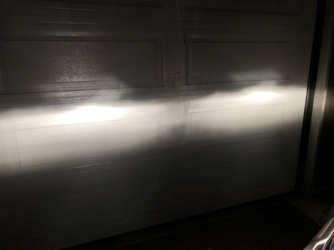

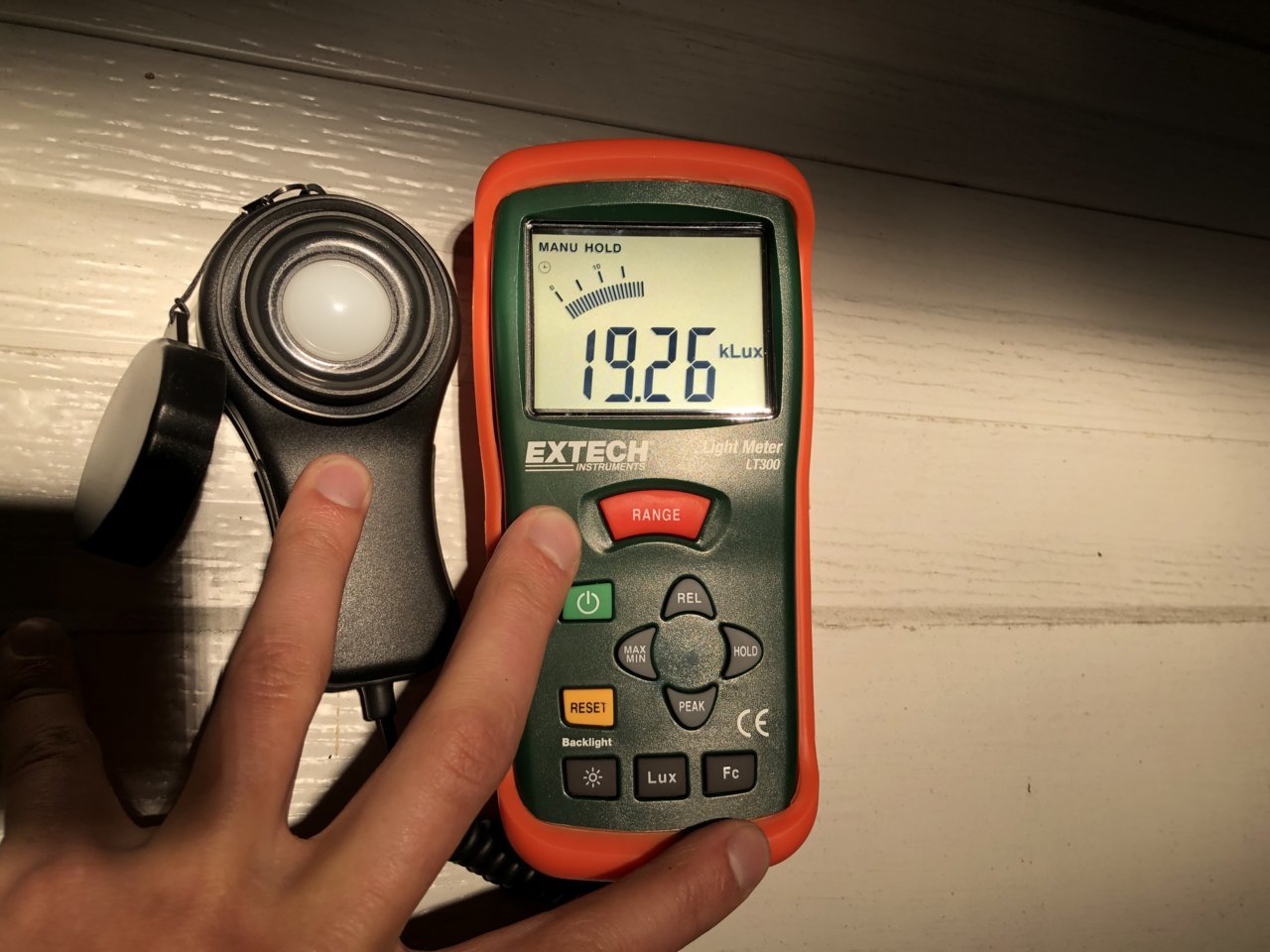

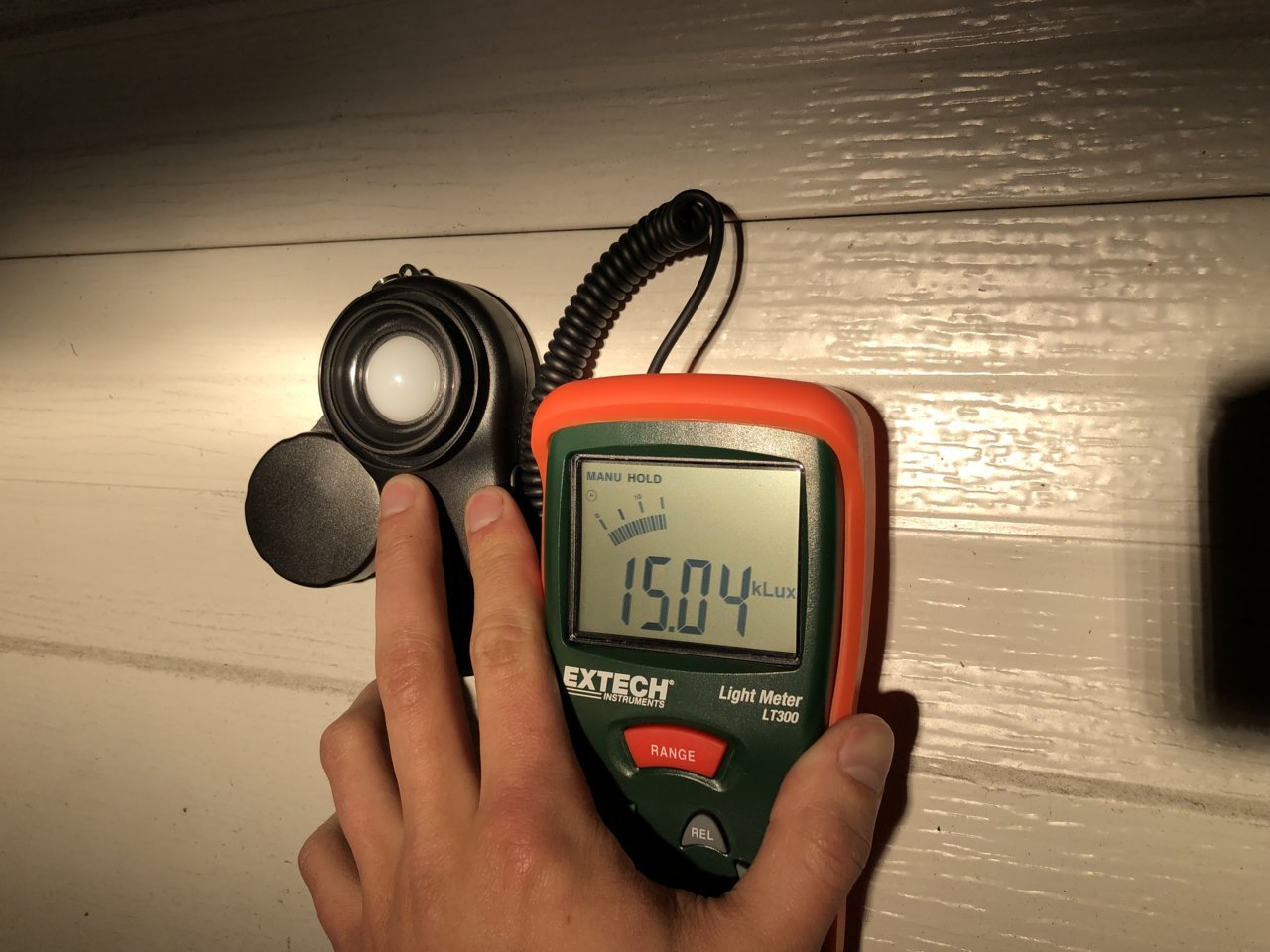

    I’ve posted before about how halogens loose approx 20% of their output over the life of the bulb. Just blowing a bulb and replacing it with an identical new bulb it poses an excellent opportunity to measure and demonstrate this effect. I always replace my headlight bulbs in pairs (you should to) so the remaining old bulb is effectively at end of life, being its companion bulb has failed. I’ll keep the old bulb as a temporary spare, but replace it with a new bulb.
    These pics and measurements are with the 85w Hypers.
    New left, EOL bulb right
    Pics don’t quite do this justice, even trying to focus in on the hot spot. The new bulb is noticeably brighter than the end of life bulb.
    End of life bulb
    New bulb
    New bulbs are about 28% brighter than the old bulb near end of life. 28% is a substantial gain.
    Always replace your headlight bulbs in pairs, it performs significantly better and if one fails the other is not far behind. I recommend keeping the used still good bulb as a spare for temporary use for next time a headlight goes out till you get a new pair of bulbs.
