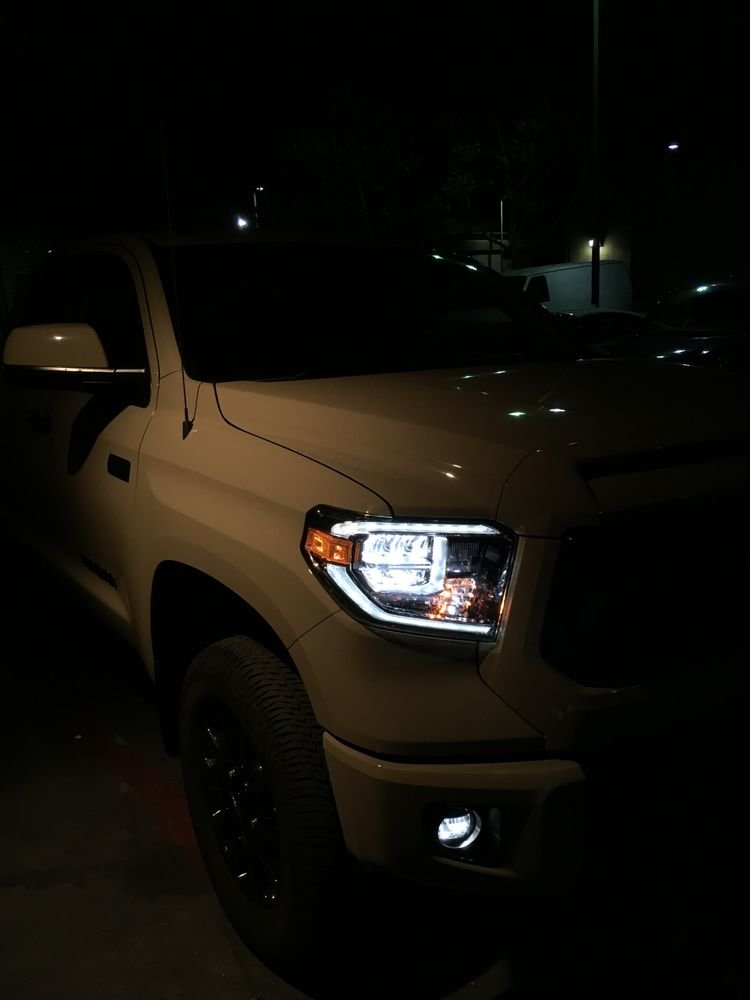

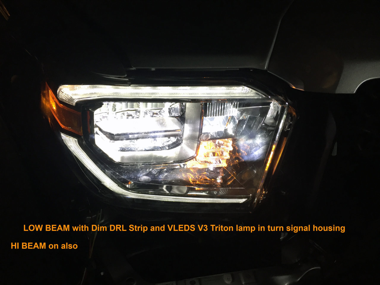

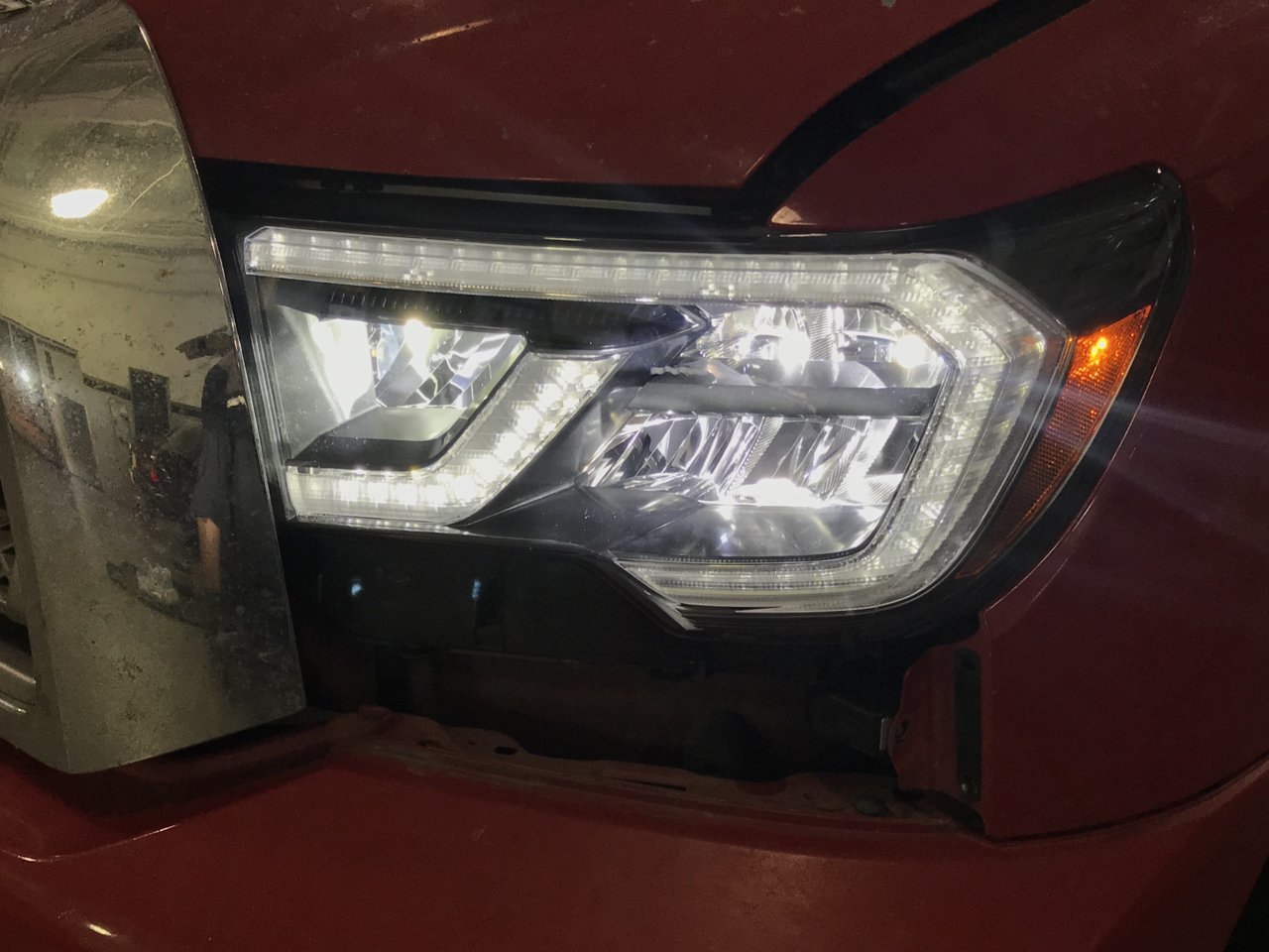

    Are you going to tell me the technology behind all new car manufacturers and their projector/led setups are less advanced, visually, than decades old halogen technology?
    What about the new tundra and sequoia led setups? They’re different in a way I’m not familiar with. They don’t use projectors. Are those setups any good?

    Please explain this lighting concept to me. They use leds but without projectors. Pros and cons? Are they any good? Are these along the lines of those new morimoto led designs? 9308E29A-4ACB-4B52-A614-526170D21ED1.jpg

    Those have lighting systems designed specifically for LEDs. Putting an LED bulb in a halogen housing design scatters the light. Why? Angle of refraction, beam concentration, etc. simple physics. Scattering the light will blind oncoming drivers and there's nothing worse than some asshat with bright, poorly aimed, blinding lights.

    You do not need projectors for LED lights properly designed from the ground up for LEDs. The only reason Projectors are important is when you stuff improper hack LED products into a halogen housing and fubar the optics so bad that you rely on the projector cut off to try and clean Up the mess you created.
    Take a look at KCs LED products specifically the G4, they produce world class results with proper cut offs using reflector technology with LED light sources, because they build their reflector based products from the ground up for the LED light source.

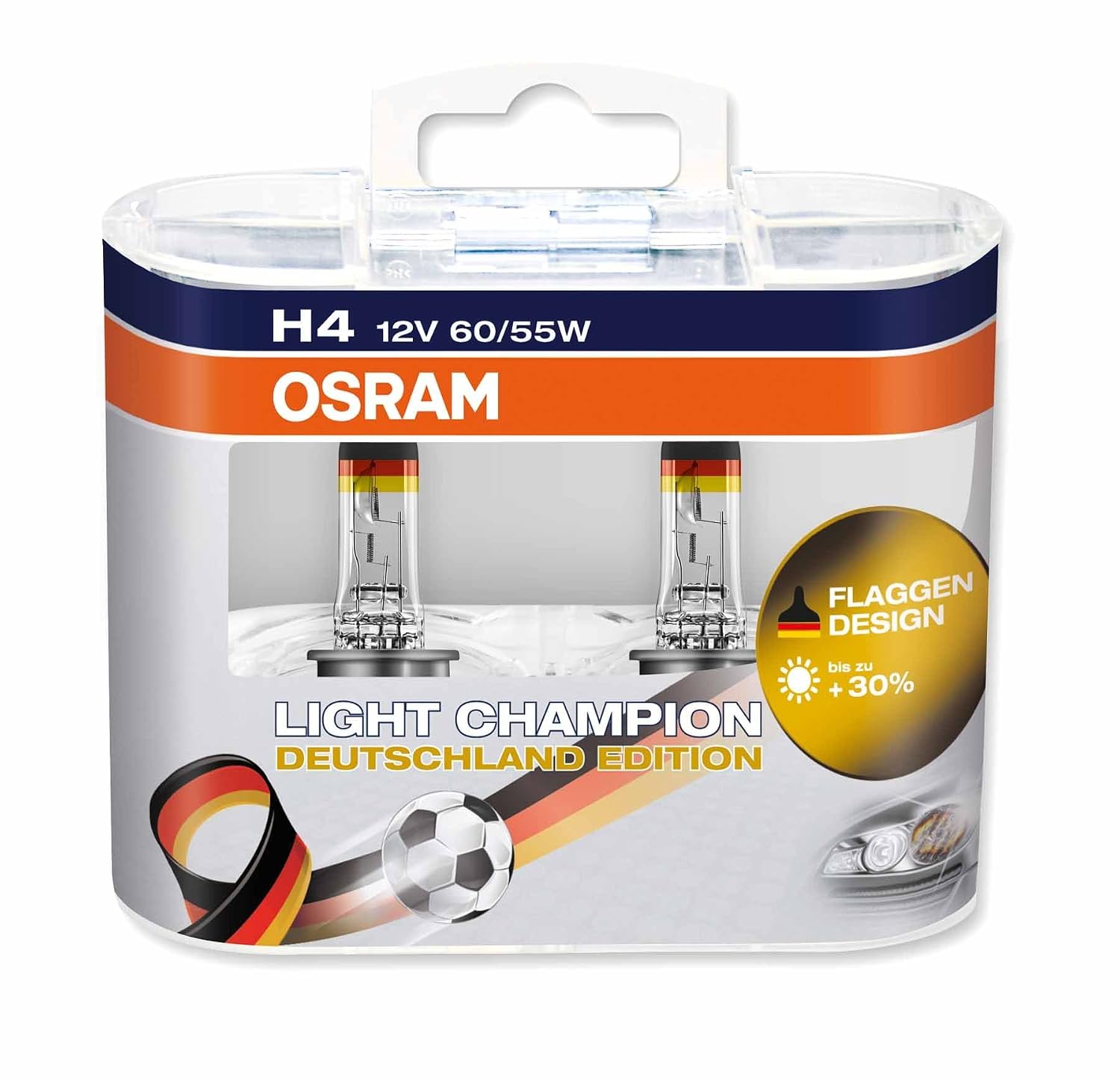

    Since I always seem to be driving across the pass at night in the snow, I decided for the next time I will try using the Osram 85/80w All Season bulbs. These are a yellower version of the high efficiency 85/80w Hypers specifically for poor weather use. While Amazon in the US does not sell them, Amazon.co.uk does, and for a much better price than anywhere else I've seen even with the most rapid 6 day international shipping option.
    https://www.amazon.co.uk/OSRAM-6420...000&sr=8-1-fkmr0&keywords=osram+h4+all+season
    While looking on UK Amazon, I also found these... the Europeans are really over the top with their soccer...
    https://www.amazon.co.uk/Osram-H4-H...UTF8&qid=1545338951&sr=8-54&keywords=osram+h4
