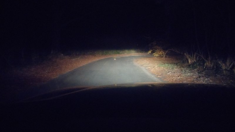

    So, just finished up this last night. I was in need of new housings so I opted for the tinted OEM housings from Camelback Toyota, which I installed last week. Light output and pattern was already a heck of lot better than the cheap aftermarket BHLM housings that I was replacing.
    I installed the 85/80w Osram bulbs using the harness OP mentioned.
    Light output now is damn near what I would call fantastic. Light is whiter and much more intense. I've yet to drive in a rural area, interested to see how the brights look.
    If you have OEM housings that are in good shape, I'd recommend getting the harness and bulbs. For $150, it's quite an upgrade.

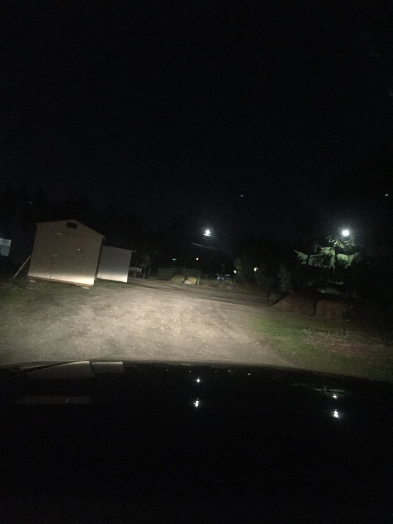

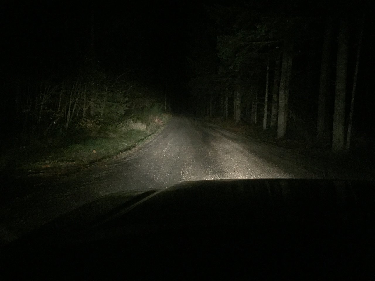

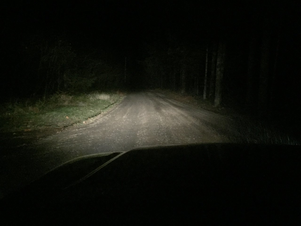

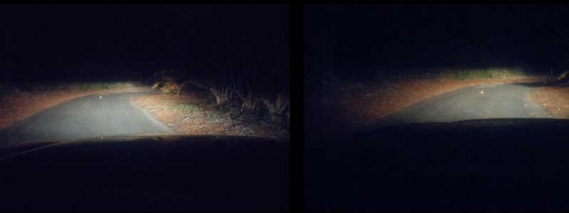

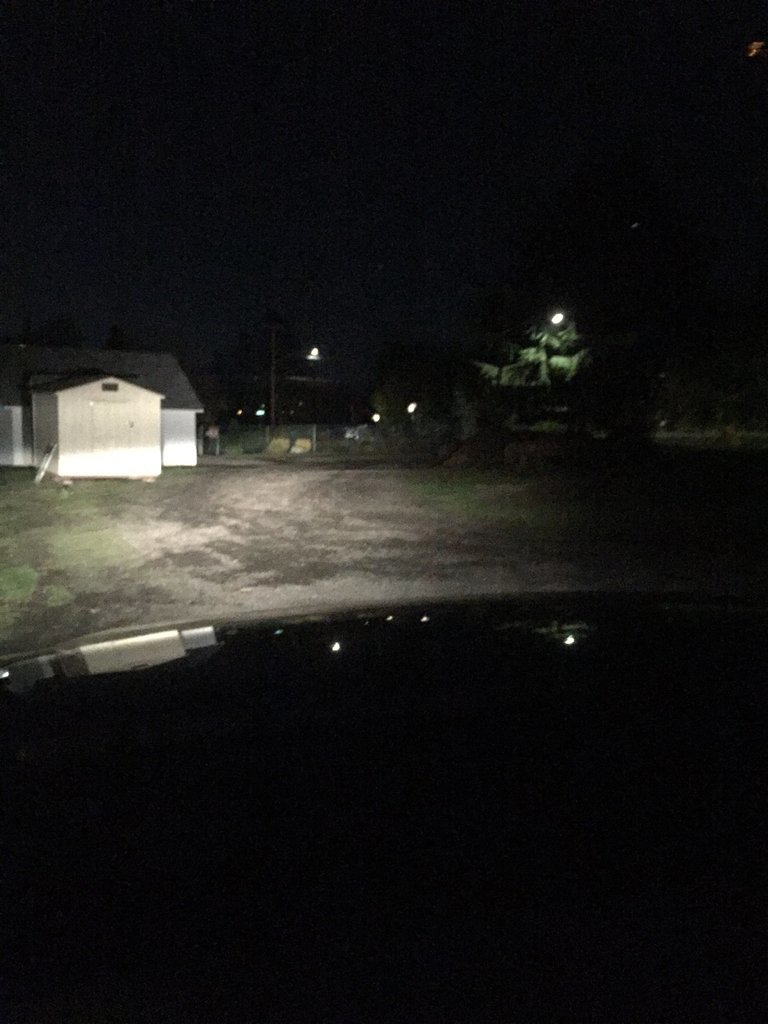

    Thanks Crashnburn80 for doing all the leg work for this upgrade. I completed it last week and am really impressed. I was concerned about the heat output before doing this mod. The first night I drove for 2 hrs and the housings were warm like you'd expect but not even close to being hot. I have not been flashed either.
    Before
    After
    Low beams
    High beams

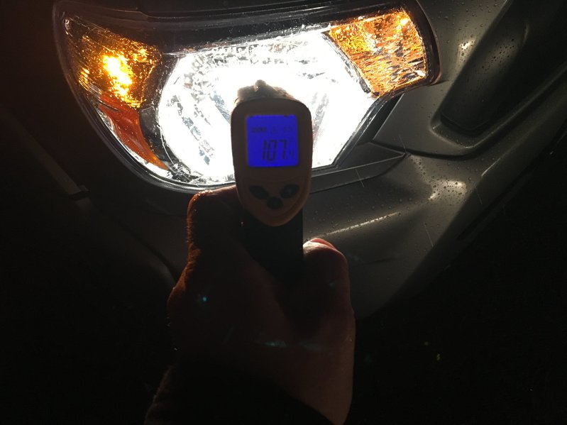

    I don't get my bulbs and harness until Thursday, but I'd thought I'd at least get started on the baseline (control) of the lens temperature. Even though this is not the internal temperature of the bulb as it connects to the housing of the light, the outer lens will provide us some consistency. Many who have done this upgrade have reported no burning, melting, or deformation of any kind, so it seems the heat is within the boundaries of the headlight housing.
    The baseline and subsequent test with Osram 85W and relayed harness will consist of the headlight being on for 30 minutes prior to testing. The truck was running, but not driven, so no cooling from the air passing the light. I took 5 readings, 30 seconds apart from each other.
    Of the 5 readings, they averaged 107.2 degrees, (This is just a pic of one of the readings) Deviation was no more than +- 2 degrees. The lens was easily comfortable to the touch.

    Good post. I was curious how much the reading varied if done from an angle on the lens, as I am unsure if the temp reported by the IR is that of the lens surface, or the reflector inside the lens. If that makes sense. Also if you could get one of the back of the housing as a control point that would be great.

    The back of the housing from the front or the back? Never mind, I will do both! I will get you the readings tomorrow.
    I was trying to get the angle so it would hit the outer lens of the headlight at the hotspot of the light. If I was off and I saw the red laser pointer hitting the inside reflector, the temperature was actually lower, by 10-15 degrees.
