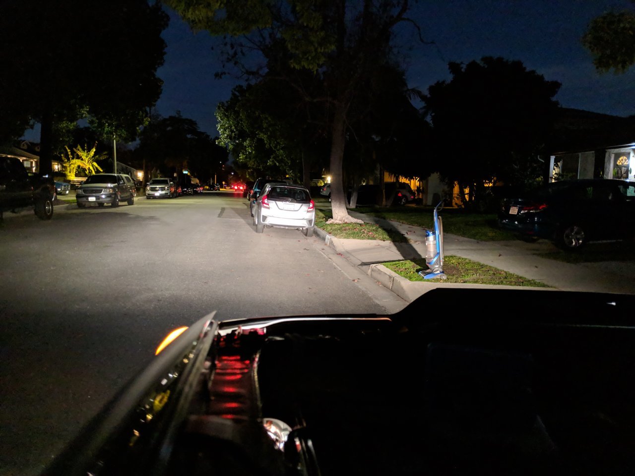

    So light output on my street of the mtecs pretty similar to the Osram Rallye bulbs

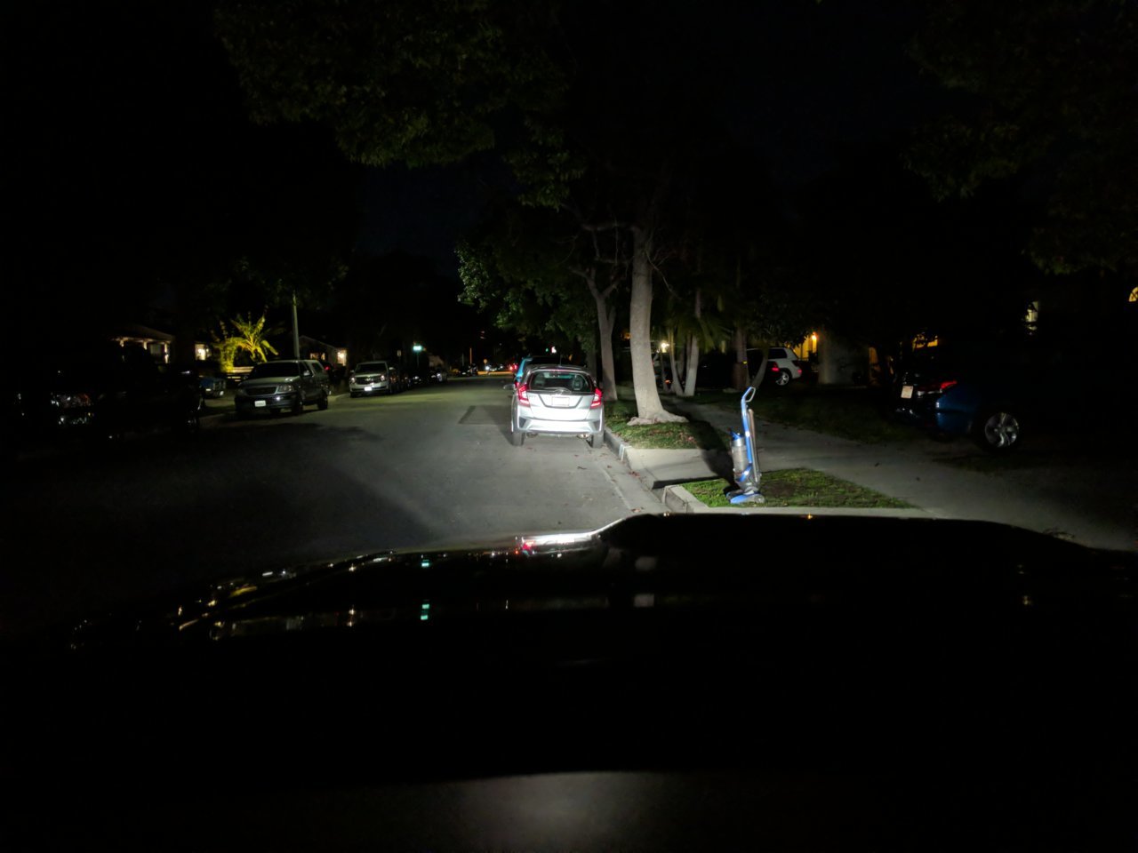

    High beam output doesn't compare to Osram bulbs though
