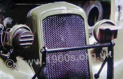

    Random, but interesting headlight related.
    The Germans in WWII were worried about being picked off by planes at night, so they came up with "black out headlights" to allow them to see without drawing attention from Allied aircraft.
    Bravisimo, lo2hi, Tsinajinii and 4 others like this.
