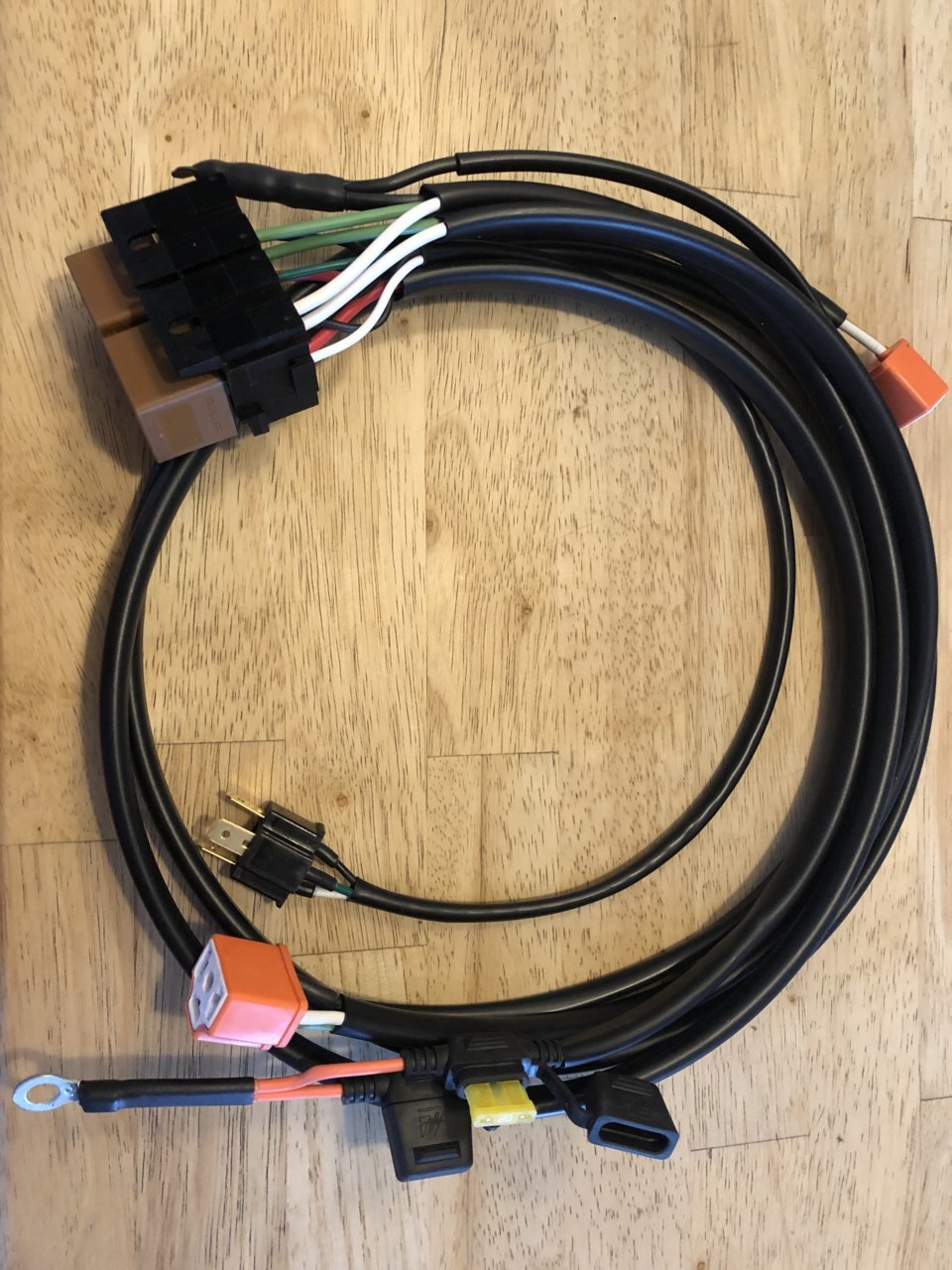

    Just received and installed my wiring harness and am waiting for darkness for a test rip. I can attest, as can the photo that this wiring harness is amazingly built. The connections are bulletproof which is most important, everything is heat shrinked and sleeved, separate 20 amp fuses one for each headlamp, more than adequate wire to reach. Couldn’t be more happy with spending that 104.xx dollars.

    And! Bosch relays made in Portugal, not China. :)
