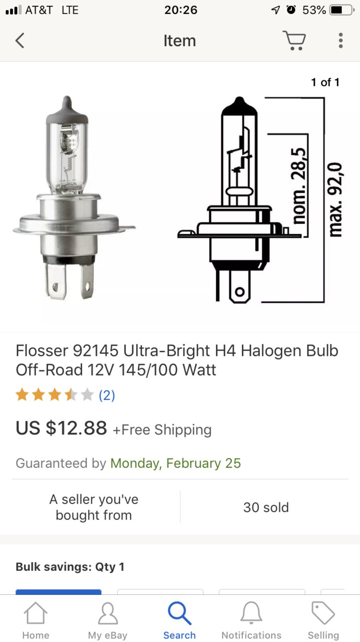

    Does anyone have experience with the flösser 145/100?

    Not something I'd use on stock wiring

    I currently have the wiring harness and osram 100/90.
    If no one's used them I'll buy a pair and do a side by side
  16. Feb 16, 2019 at 5:41 PM
    #1716
    Too Stroked
    Too Stroked Well-Known Member
    Jan 24, 2017
    #208501
    3,924
    Tom
    South shore of Lake Ontario
    2021 4Runner SR5 Premium
    Agreed, unless you want to use it as a heating element.

    Might want to see if @crashnburn80 has tested them already.

    I have not. There are two things to consider when going to overwattage.
    1) The higher over wattage you go the heavier duty the filament needs to be to handle the increased load. Thicker filaments don’t focus as well and lead to reduced hot spots which may not project as far, is why the 85/80w bulbs were so great as they were increased focus high wattage.
    2) Bulb life. The 100/90w Osrams have a best in-class bulb life of 200 hours. Competing bulbs by Philips are at 150 hours. Going even higher wattage will further reduce life. Flosser does not publish specs but a similar bulb from Hella is down to 40 hours. If the Flossers has a similar life span that would mean bulb changes every 2.5 months based on 200hrs lasting a year for my use.
    So the low beam may not be as good and the bulb life may be drastically shortened. High beam performance will be exceptional though. But without specs it is hard to definitively say.
    Also be sure to check the fuse rating for high beam, they will pull 25A. IIRC the fuse is 30A.
