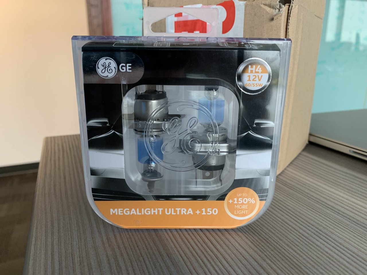

    The GE +150s arrived today! I plan on testing these out tonight and will share the results here.

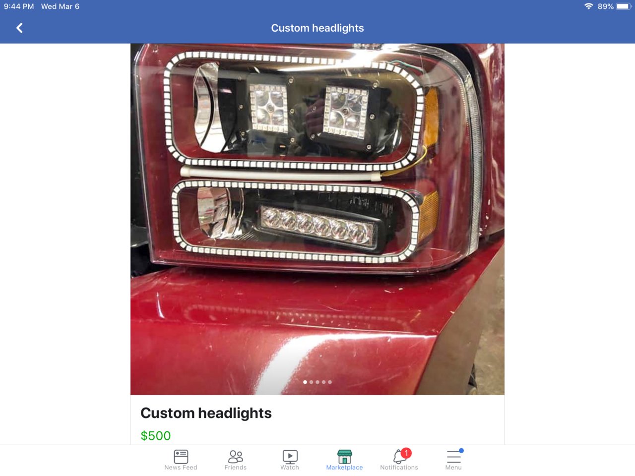

    Ok, throw out everything @crashnburn80 has said! These are on Facebook Marketplace and are the lights of the future!

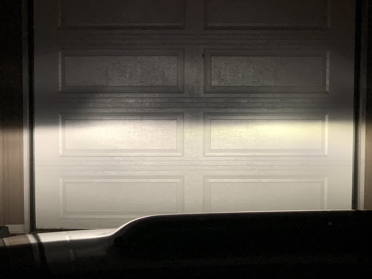

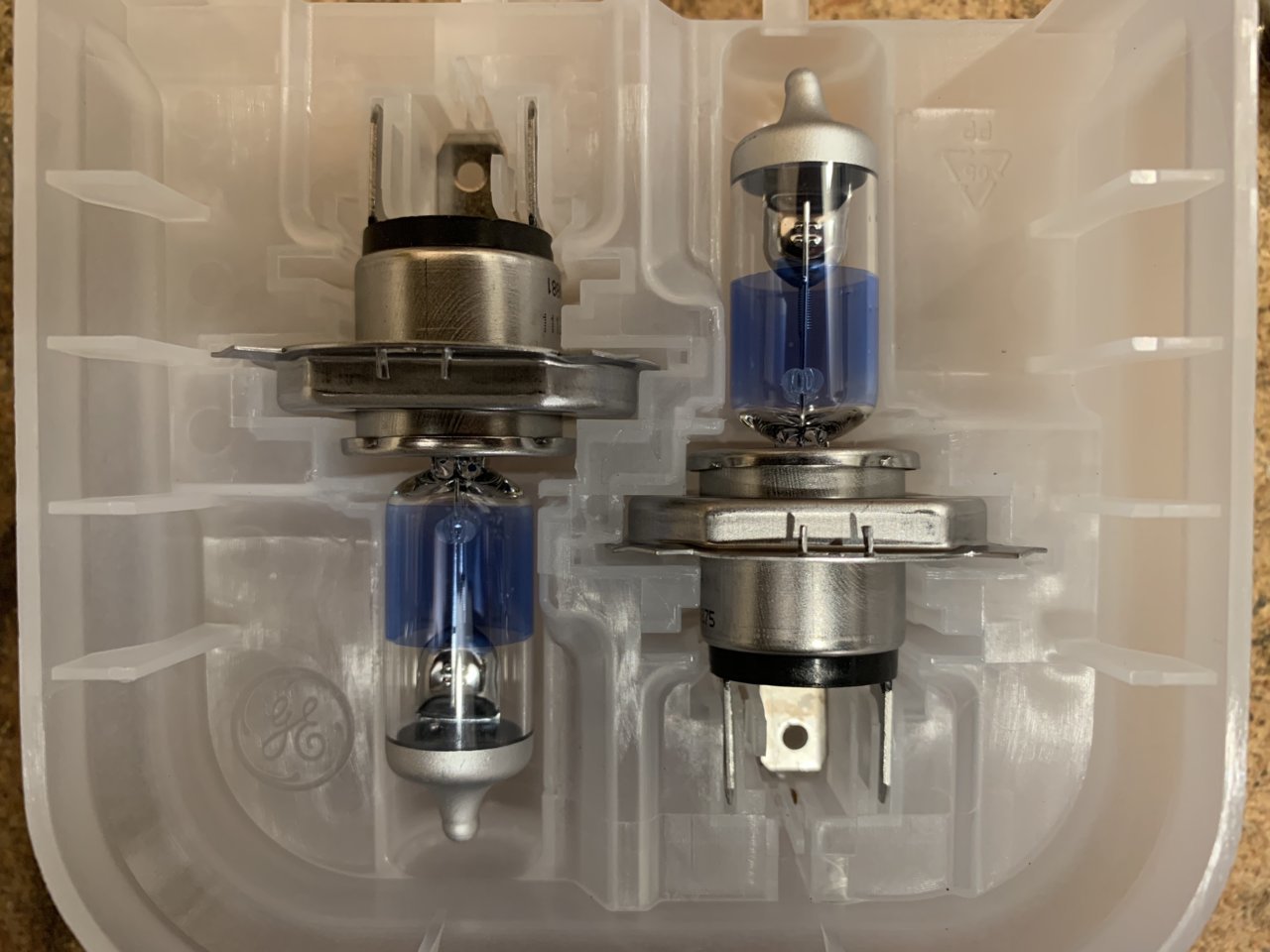

    Disappointing results.
    Packaging is truly awesome, there is almost no chance in the bulbs being damaged from international shipping in their latest packaging update which cocoons them in a polycarbonate shell. Far better than their earlier paperboard containers.
    Sloppy manufacturing, precision is completely unacceptable. Ultra high efficiency headlights bulbs require near spacecraft build precision as that is the basis in how projection performance is magnified to achieve their claimed performance increase. While the high beam filament is precision aligned, the low beam filament is cocked to the side, out of alignment. This reduces low beam projection focus and intensity and will reduce the low beam performance of the bulb. Both my +150 bulbs looked like this indicating this seems to not be a one off occurrence. For a company that seemed to excel in precision bulb builds in their +130 series, this is a surprise to see such flaws in manufacturing.
    GE +150 Left vs Osram All Season 85/80w +30 right
    Lux readings: GE 1310 left vs Osram 1850 right
    The GEs look good on the wall, but color is so deceptive in wall shots. The Osrams are significantly brighter than the GEs as measured by a digital spectrometer. I have hope the GE +130s will actually do better, as they do not appear to suffer from the same sloppy build quality.
    For a more thorough analysis of options we are going to have to wait for the bench testing, there are just too many options and variables to try and test in a scientific way in a vehicle. Late model OEM headlight assemblies are on the way to add to the bench test rack so that tests can be better standardized, better data will follow.

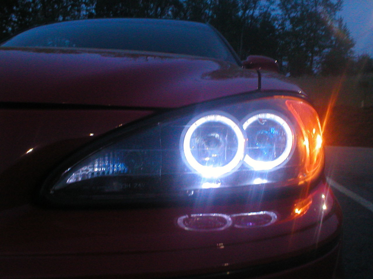

    I made my own headlights once, and I'm glad they turned out better than that.
