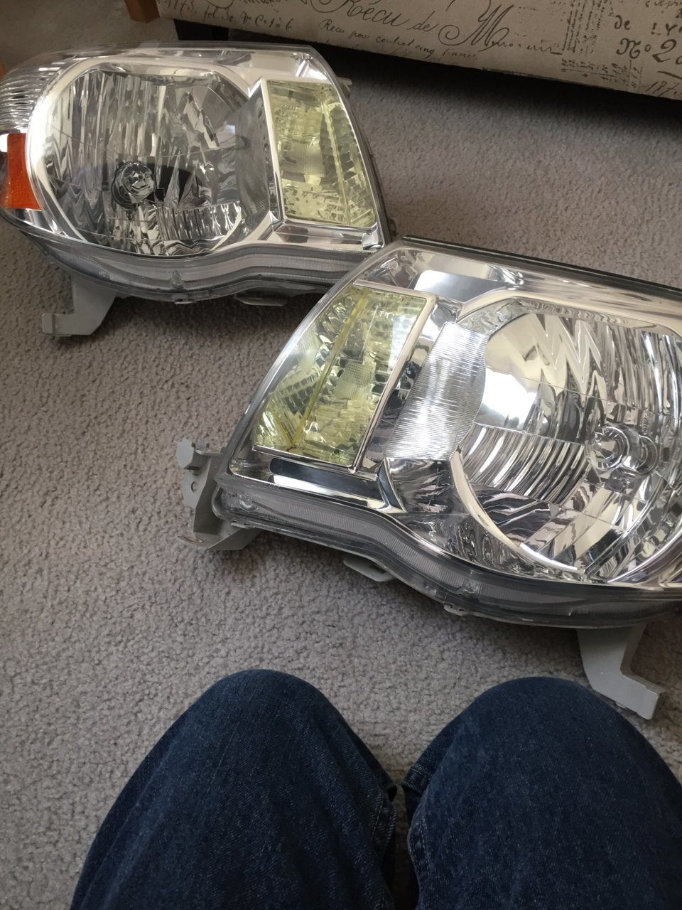

    I’m getting my harness this coming week
    Now to figure out the bulb situation
    I have some OEM lights I picked up on CL for 50$
    May do BLHM on them
    I did my old headlights, but they’re a bit hazed over

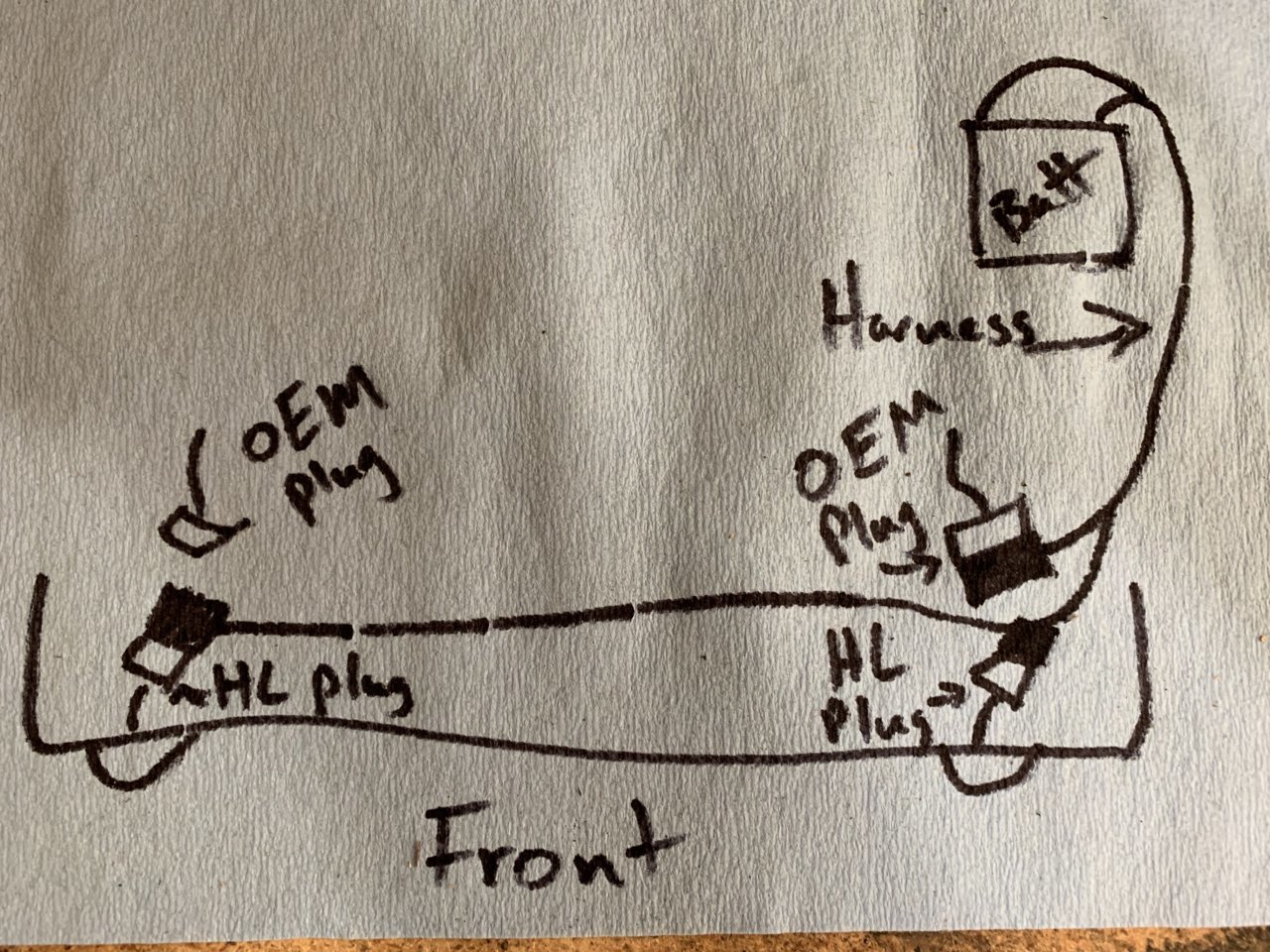

    Just got my harness from Headlight Services. Is there a video or guide on how to install this? I've never done anything electrical in my life before.
    Thanks

    While it may seem intimidating, it is really simple plug and play. See my highly technical engineering schematic:
    Unplug both headlights. The harness (shown with black plugs) plugs into the OEM harness headlight plug, then the harness plugs into both headlights. Then connect the black wire to the negative battery terminal and red wire to the positive battery terminal. The passenger side OEM headlight plug remains unused. You can optionally wrap the face of the unused plug with electrical tape if you want to keep the socket clean.
    Now when you turn on your light, the OEM plug, feeds the harness, which activates the relay, which then draws power directly from your battery to the headlights boosting voltage for higher output.
