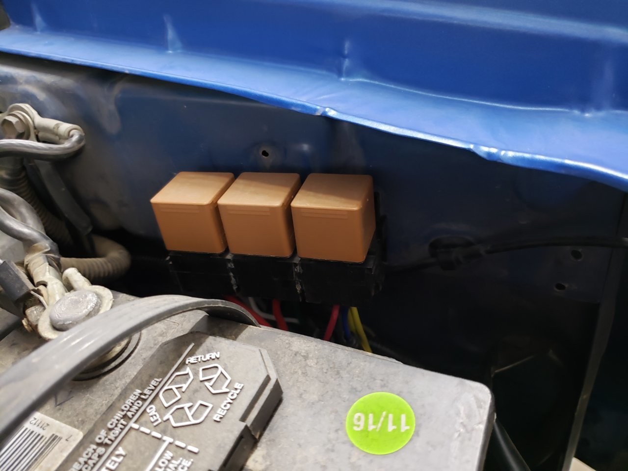

    Trying to install the harness today. What did you guys do with this big relay thing with brown caps? Where to put and do I need to remove the brown caps?

    The brown things arent caps, they are the relays. I made a little bracket to mount it in front of the battery. Made extra to give away here but they're gone. Search my posts in this thread to see what I made and how I mounted it.

    Mine is just tucked in between the battery and fender. I’ve hard mounted them in the past but I didn’t bother this time, I also have 2 since I have relayed headlights and fogs.

    If you remove the relay from the base you can screw the built-in bracket directly to the inner fender well

    i would need to pull off the brown cap from the base in order to screw it into the fender well right?
    i tried pulling pretty hard with my hands but it wouldn't come off. didn't want to break anything.

    The relays can be really stuck in there, but they do come off. When I changed mine out on my fog harness from Hella to Bosch I had the same problem. I took a small screwdriver and gently started prying up under it back and forth from opposing sides to work it out of the death grip of the relay holder.

    thanks ill give this a try this week - probably end up trying to screw it to the fender well.
