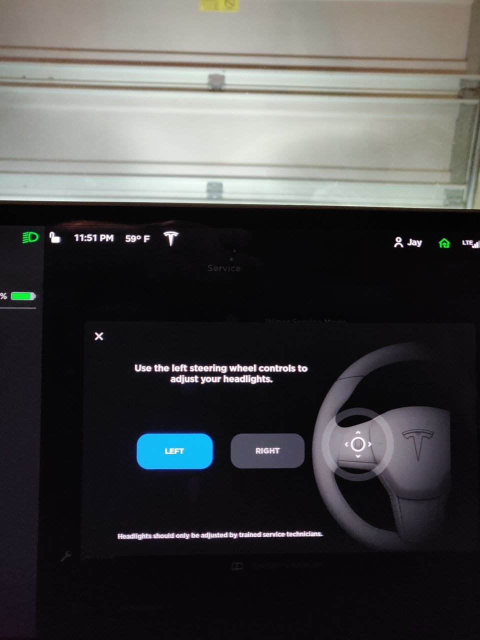

    Tesla makes headlight adjustment stupid easy. It also has a vertical adjustment setting.

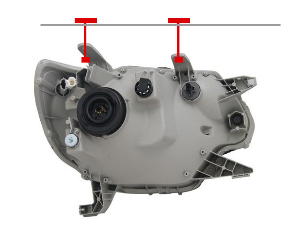

    Pardon the poor quality, but would a jig like this make sense? Having a solid bar across the top with threaded rods dangling down to mount into the screw holes? Would that give you enough solidity for the test bench? They don't appear to be in the same plane so that may complicate the adjustment unless you had angle iron that could bend between the top bar and the threaded rods.
    crashnburn80[OP] likes this.

    I’ll post some pics this evening. Something like that could be possible with some long enough threaded rods so that I could secure them with screws. Potentially wouldn’t give me much side to side adjustability though.

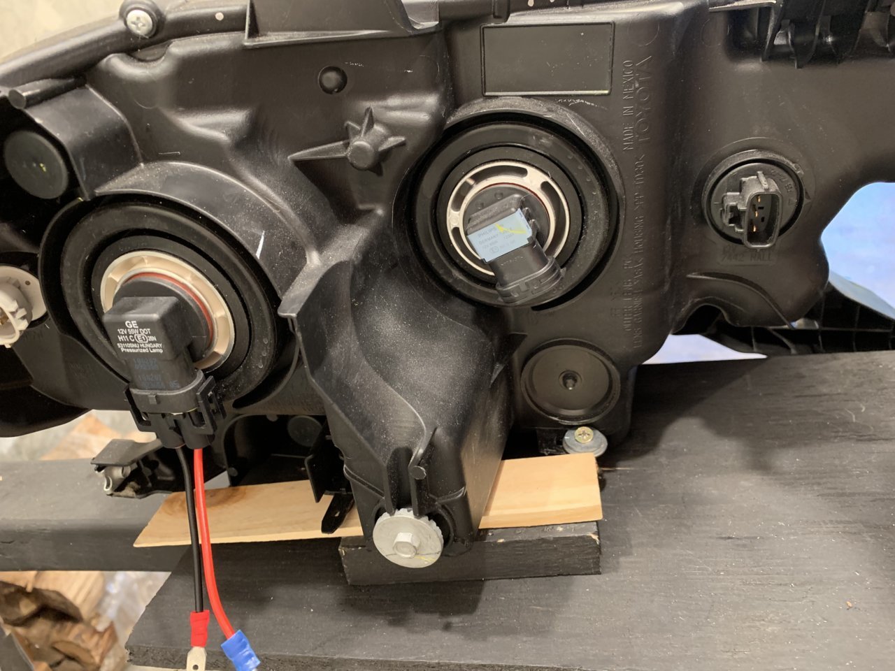

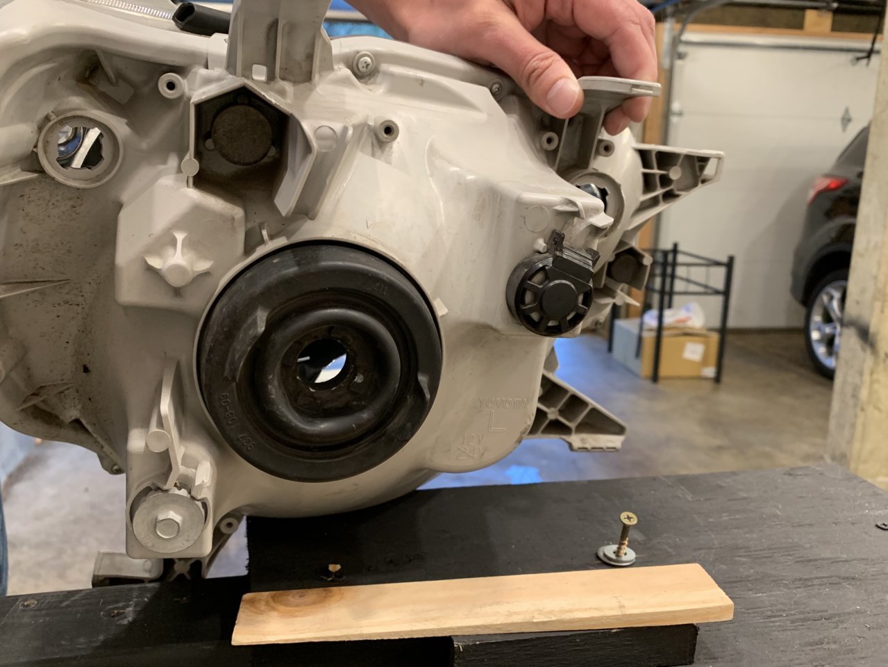

    Ok, here is my 3rd Gen rack setup, like I said it applied the KISS principle.
    It has a flat base, is secured with a single screw and washer setup and I use block and shim to level and aim. It works very well.

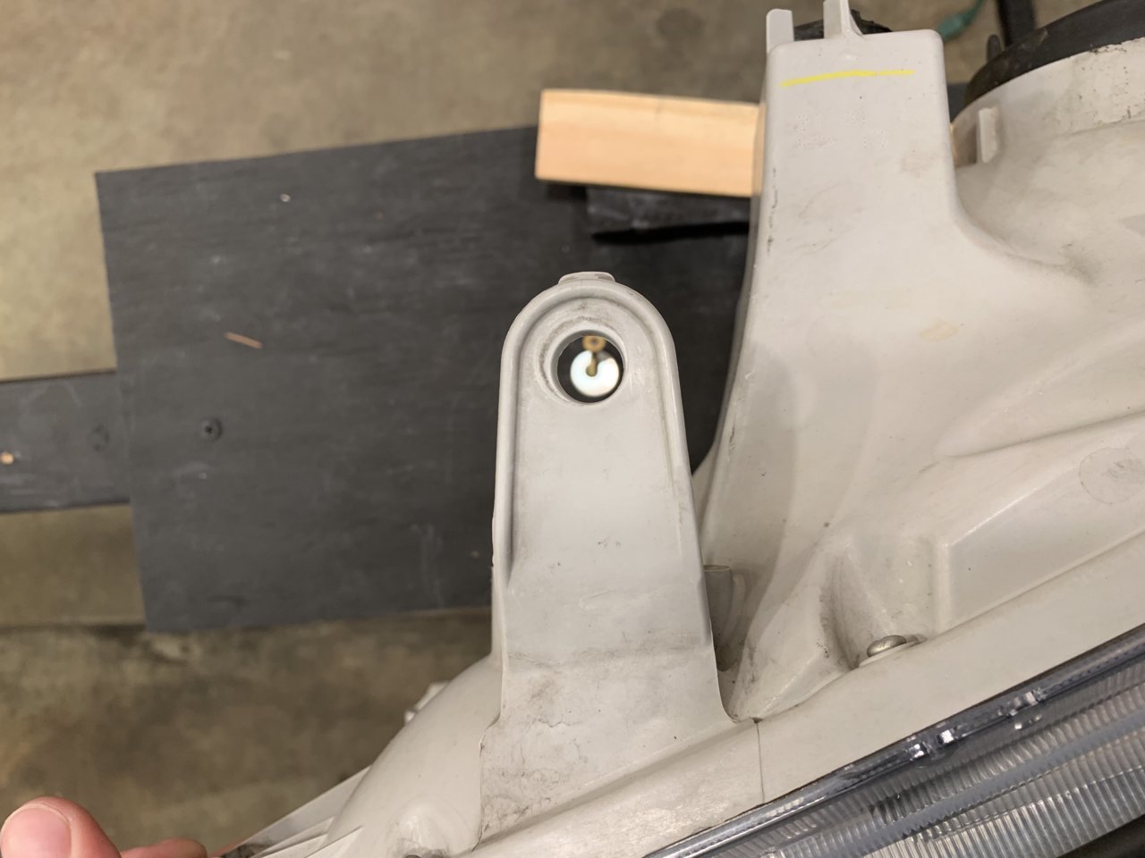

    Here is the 2nd Gen light.
    No flat surface making this much trickier, and the lower bolt mount extended arm isn’t doing me any favors. Also no easy securing point at the base.
    After looking at it again, I could do a 2x2 going directly down from the mount I’m holding in the above photo. Then use a screw with a washer to secure it. I’d ideally like one mount point to give me 3-axis of freedom for aiming/adjustment. I could then shim it similar to the 3rd Gen light though not quite as easily.
