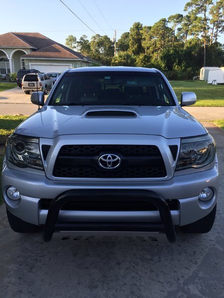

    I agree, put spyder led's and had to upgrade because other bulbs sucked

    IF they are perfectly adjusted, and you're both going straight down a perfectly flat road, yeah. But when that lifted 4x4 is in the back window of my normal sized passenger car, I beg to differ. when that HID headlighted car is cresting a high spot, massive glare.
