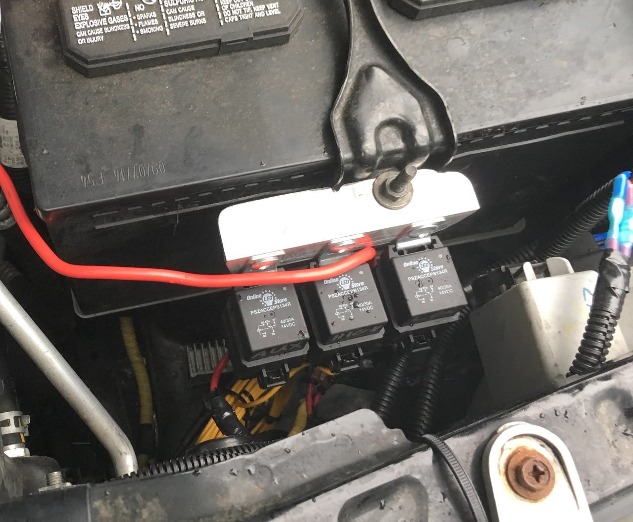

    Out of curiosity, where/how did you all mount your relays? I found a little grey thingy at the base of the battery and with a little finagling they all screwed down to it just fine. No tape or extra hardware required. I used the battery holder too for the positive leads.
    Greenbean and crashnburn80[OP] like this.

    I made a simple aluminum bracket that attaches to the batter hold down. Just a temporary solution till I install the pelfrey size 31 battery cage. (Note the bracket is electrically isolated or grounded technically, the red pos wire isnt connected to it, just kind of looks that way)
    Norton likes this.

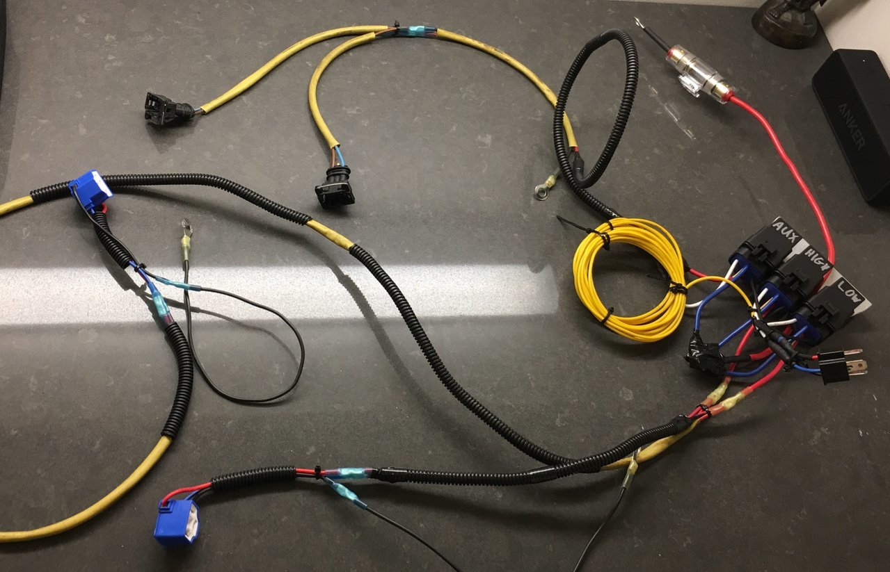

    I made my own harness cause I wanted to tie my aux grill lights to the high beams (hence the 3 relays instead of 2, and the extra long loop of wire to run into a switch in the cab so I can disable them and run just the regular high beams for some reason). Also I was trying to do this mod as cheaply as possible and I already had all the wire/tools/etc. Only thing I didn’t have were the ceramic H4 sockets, which were a little hard to track down by themselves, and I’m not too happy with. Have a hard time getting the bulbs to actually plug in, like they’re not 100% the right size/shape.
    The relay bracket is just 50 cents worth of 1” aluminum angle and an hour with an angle grinder, drill, and rivet tool. I could take some better pics, but probably won’t have time to make copies of it anytime soon.

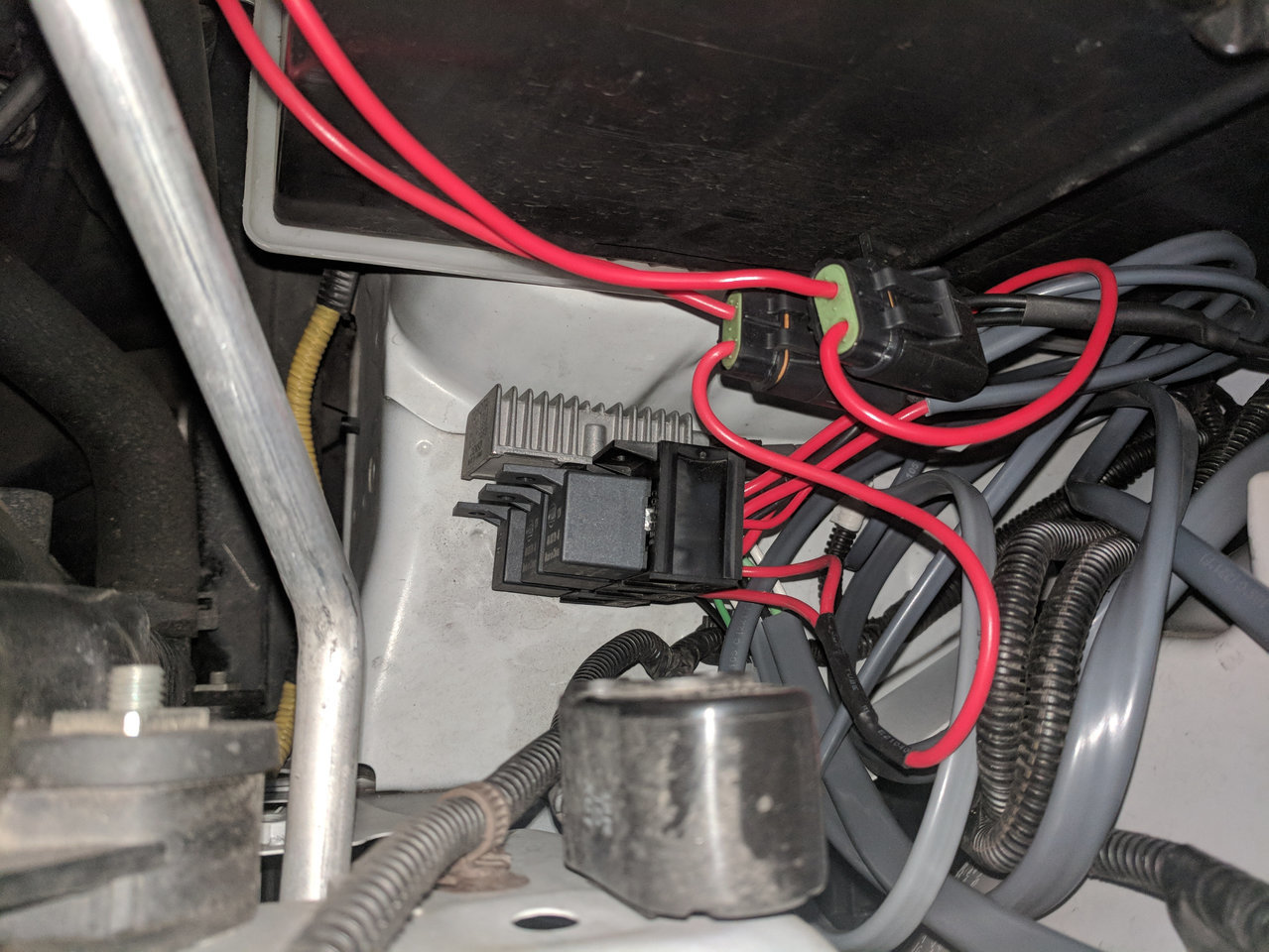

    I’ve hard mounted my relays in the past when doing this upgrade, but this time I did not. I’ve got 2 harnesses (headlights and fogs) I’ve just tucked the relays with a little extra wiring between my fender and battery. They are cozy and not going anywhere.
    Nicely done! I’ve thought that if I were to get some aux lighting LED pods I’d do similar and wire them into the high beams.
    Norton and Unchained 5150 like this.
