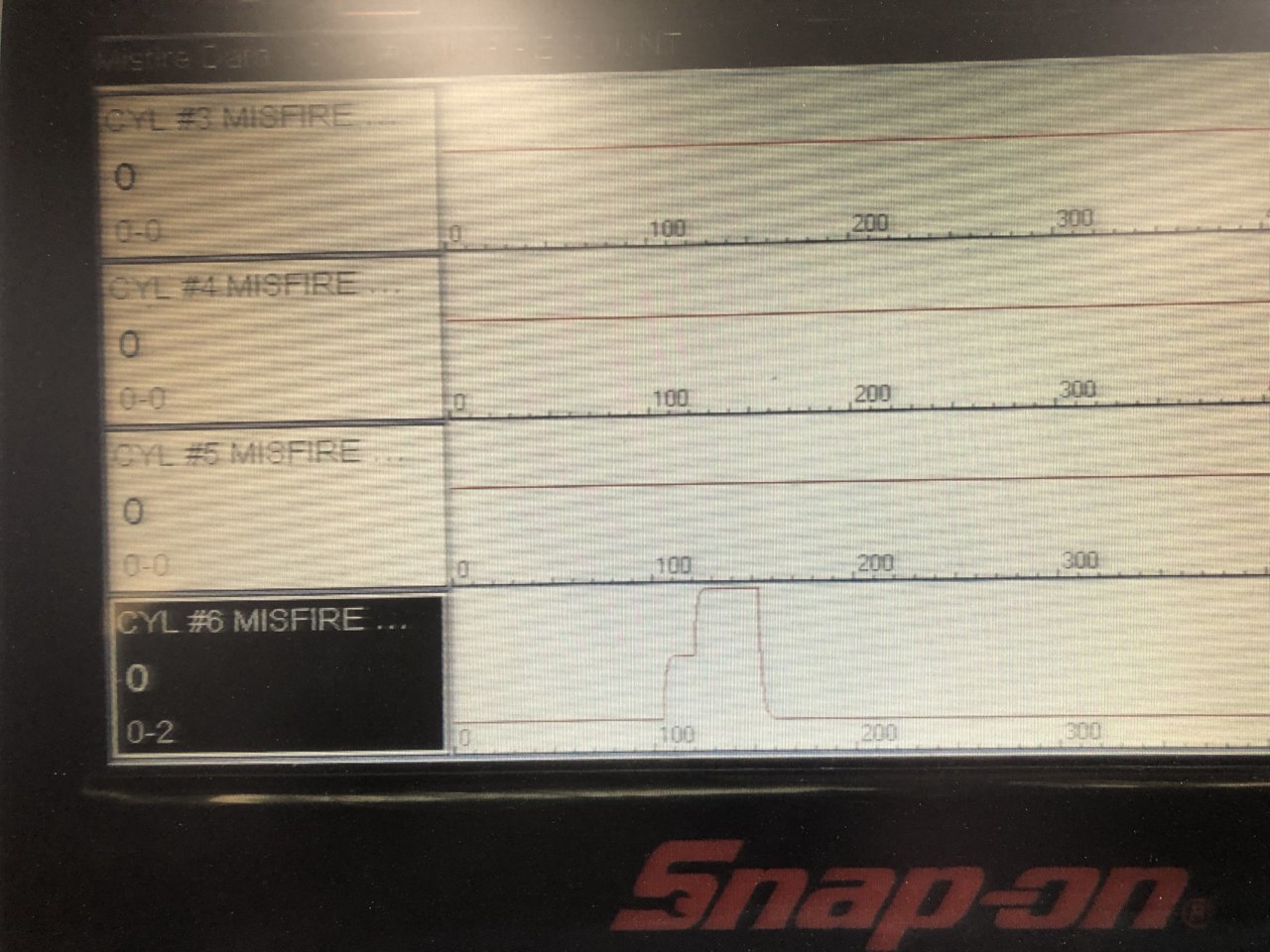

    Cylinder 6 is misfiring, not constantly- but twice every 500 seconds. (Picture attached)
    I find this extremely odd that the misfire isn’t triggering the check engine light, and when you do the “tick test” on coil #6 IT TICKS?
    If the coil was bad it wouldn’t tick at all!

    Is that two every 500 seconds? That’s twice in 8 min 20 seconds. That’s not your mileage issue.
    Twice in 500 milliseconds may be an issue.

    @rnish Yeah the snap on scanner reads it in seconds, kinda weird.

    Not seeing much from the image as it is only showing about 380 milliseconds... and only one firing pulse.
