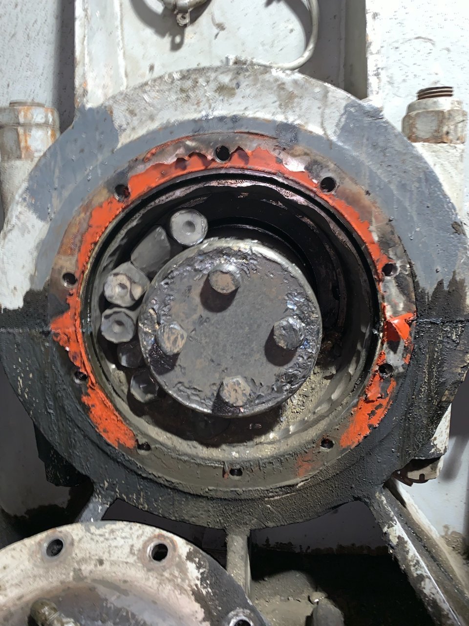

    Well that's gonna need to be fixed. Don't think the oilers doing there job.

    Not sure what piece of equipment Red is working on but he is in a mine site, looks like the bearings failed due to no oil / grease.

    Drag drum intermediate shaft in a Bucyrus Erie Dragline. The shaft is +/-13” in diameter where the 4 bolt retainer is on the end of it. Basically it is one of the 2 winch gear boxes on a winch drum just about the size of a one bedroom apartment.
    Ding ding ding.... we have a winner! Some how the air got shut off to the auto lube system.
