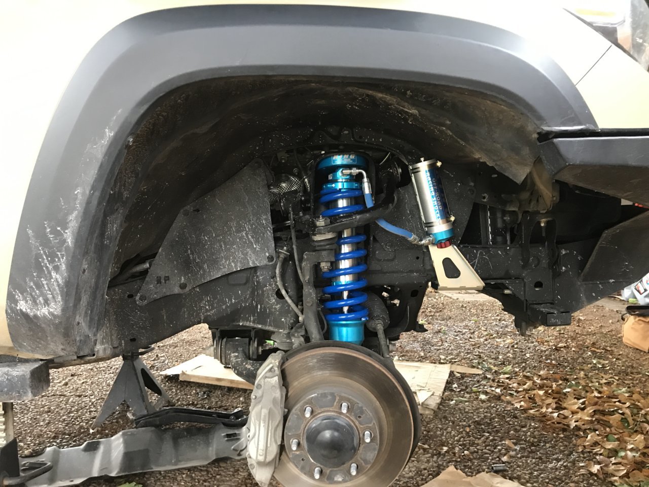

    35 minutes in one side done...

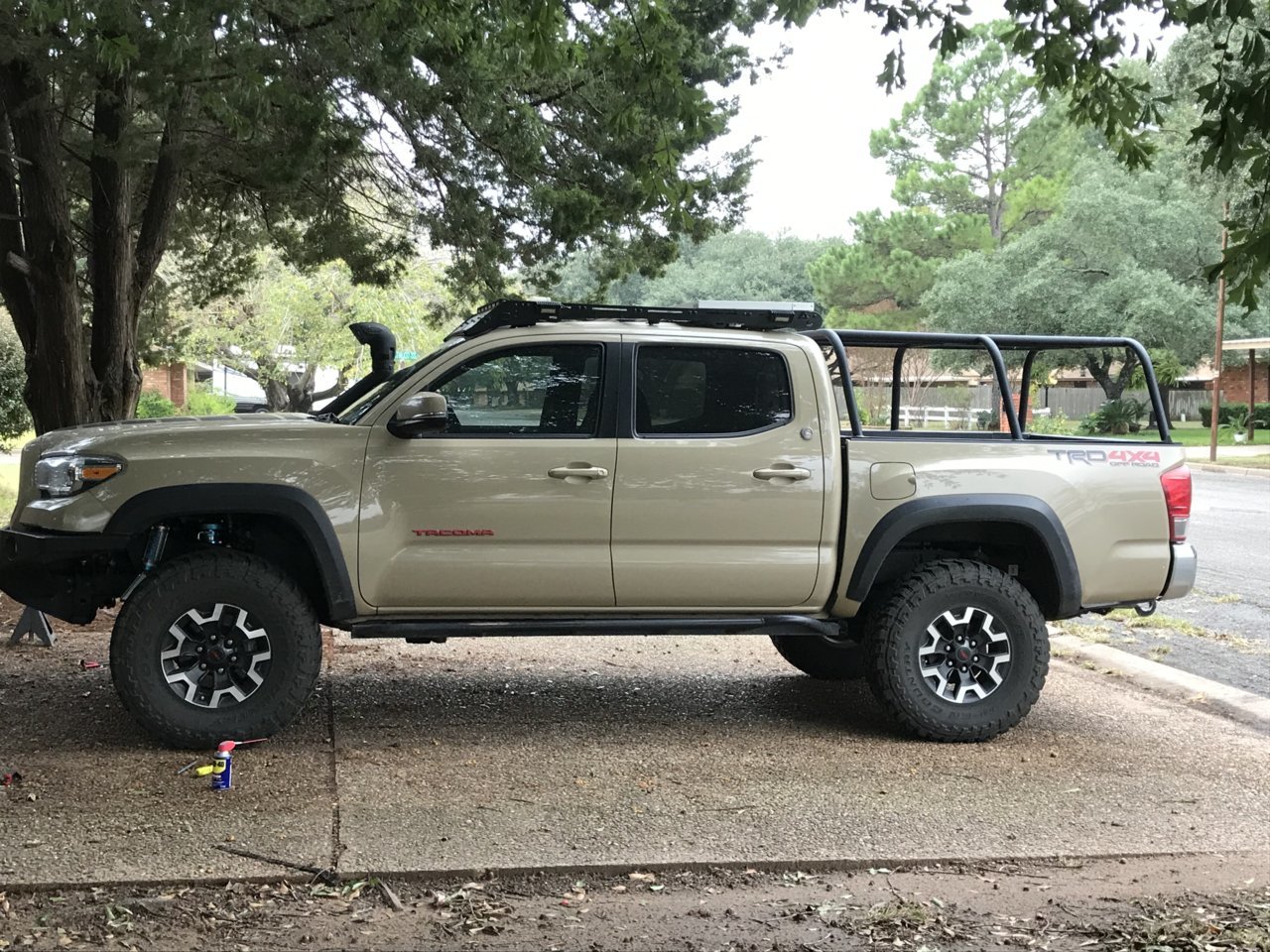

    And a ride height shot before I clean up.
    21.5” pre to 23.25” post front hub measurements.

    65-70 down a washboard white rock road smooth as butter. Wound up at 20 clicks on the adjusters to balance them with the rear shocks.

    Dang that max stiffness I keep mine set at 5 click from softest.

    I am actually supprised how well the OME keep up on the short go. They did build a lot of heat though. Kings were still cold after 15 miles OME tears were at 90*.

    Mine have 30 clicks so I’m about 2/3 in.
