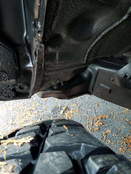

    Still rubs at this point so you must go at least this far back. I don't have any measurements unfortunately

    Hopefully. You can always cut more out and buy a plate to make a stencil from home Depot. That's what I did. And I have left over steel to mess around with. Think I'm going to make a cb antenna mount.

    When you had your alignment done did you have them push your caster as far out forward as possible? That could possibly help the rubbing issue. I had my alignment shop do that.
