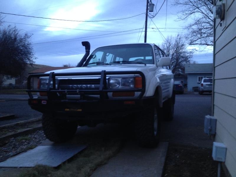

    The new chapter in the life of a '91 Landcruiser. I picked it up from a fellow member, Idaholandho (thanks again dude!), yesterday in Boise and made the trek home to Oregon through some nasty weather. The White Dragon surfed through the heavy rain, wipers on panic, hydroplaning at times but doggedly marching forward. At the summit of Deadman pass there was a couple inches of slush on the road and it did fine, and even pulled the mountain at a respectable 65mph.

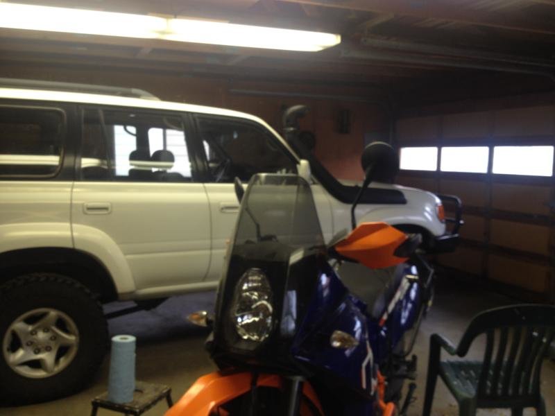

    KTM 990 Adventure. It has almost as much horsepower as the Landcruiser. :eek:

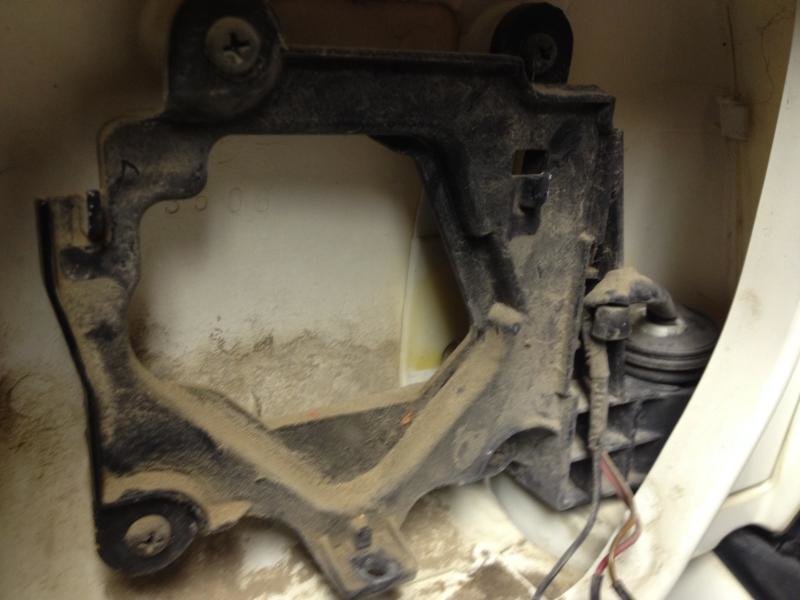

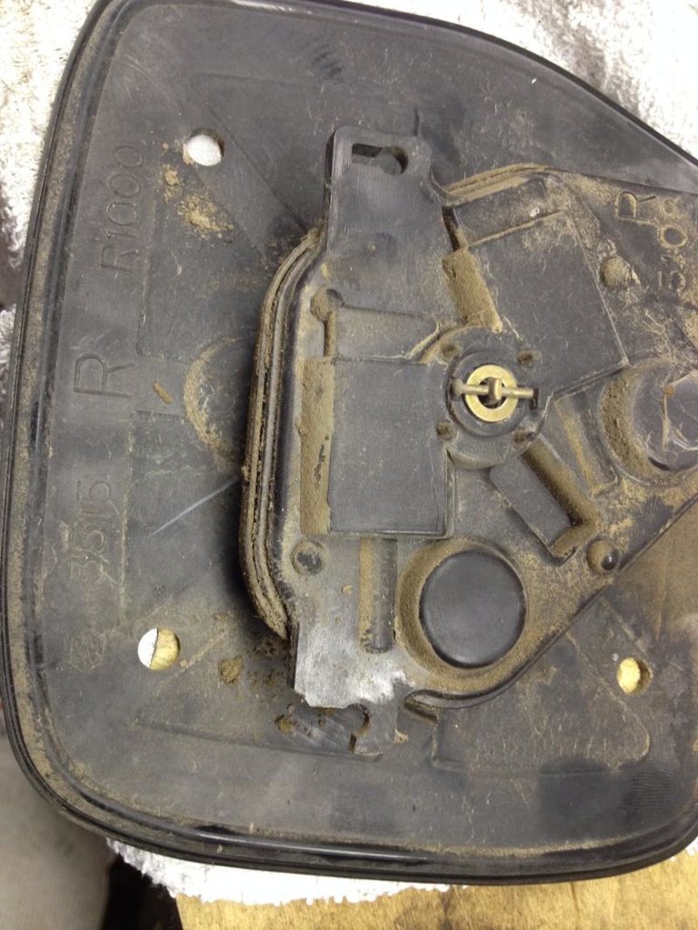

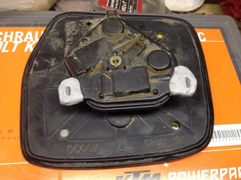

    Tonight I fixed the shaky mirror problem that plagues virtually every FJ80 on the road. Inside the housing, the mirror is hung with two undersized tabs and a single screw. When using the power adjuster the tabs often crack, leaving that single screw to hold the glass in the mirror while it flops around like Ron Jeremy doing the helicopter.
    The broken tab (the keyhole looking thing)
    689865C8-FE7C-46C6-8B24-15DDE5776F7C_zps_c0d7abf71cce61e9879f548d2c79d8067bf32086.jpg
    The repaired tab. (used plasti weld) I pressed the soft plasti weld back into the housing tabs to leave indentions, then used a small flat blade to work out slots.
    02B97670-FB46-4E2F-8C1A-6450D0B12D47_zps_d9d242eb0156afcd04f2367002037dddddadeb9b.jpg
    The housing
    1D251BE9-E67E-4257-8830-125ED711FCE9_zps_525899a3e3209f6e9b3fa17432b31c1d1554b4ce.jpg
