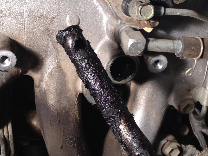

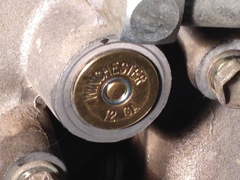

    In an effort to smooth the lumpy idle, I removed the EGR system. It smoothed the idle some, but it's still not as steady as it ought to be so I'll remove and clean the intake tract next, then come up with some sort of PCV catch can to keep all of the oil out of the intake.
    Grungy like Nirvana in the '90's.

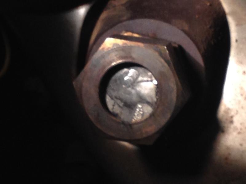

    E1D13D49-B998-4C4C-BD6B-7DC127B43025_zps_5c6ebac68de3b54efcc60821bf1e060f8e23895c.jpg
    Exhaust side. Found the quarter in the truck, so technically free mod.
    99AE06E7-1DE4-430D-B745-9F8EDFB64269_zps_0f1547a2b25f7457ad9d464de67c545a857e76e6.jpg
    I was hoping .50 BMG would fit, but went with 12 gauge on the intake side instead.
    D49B386E-66AD-493C-9F4B-357EE4CA9123_zps_60023b38f87b046b366bb1550b80b29a2182ef23.jpg

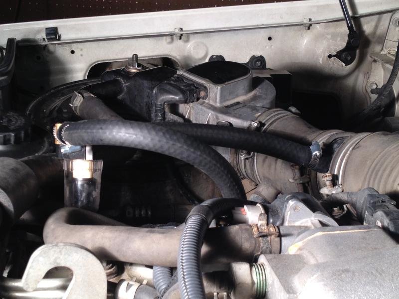

    Made a catch can out of a spare air compressor water separator I had. We'll see how it works. The old hose was split, that must have been where the vacuum leak was as it idles much better now.

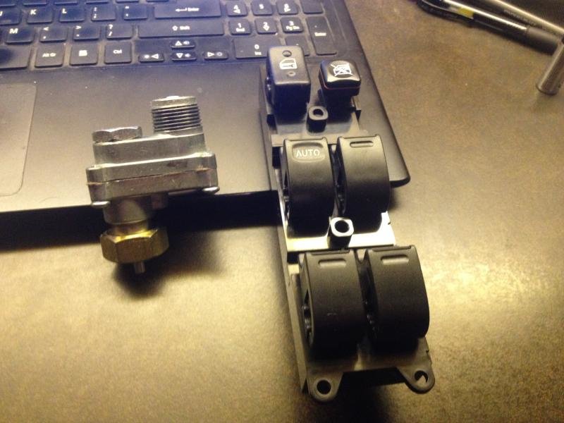

    Speedometer correction doohickey and new window switch panel came in today. I'll install this weekend, and I might delete the smog pump jungle too.

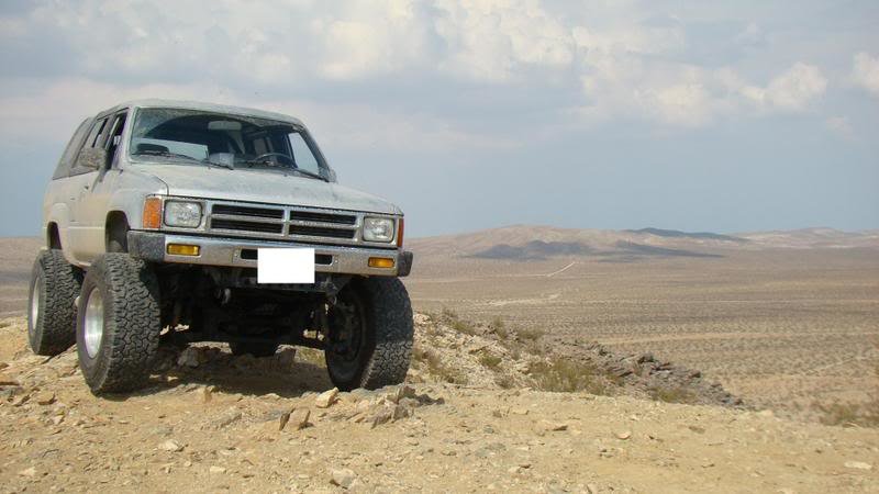

    Thanks man. I like 4runners too, this was my last one. '87, IFS, but it took me all over the west. People complain about the lack of power in the FJ80's. They have never owned a 22R 4runner on meats before. :D

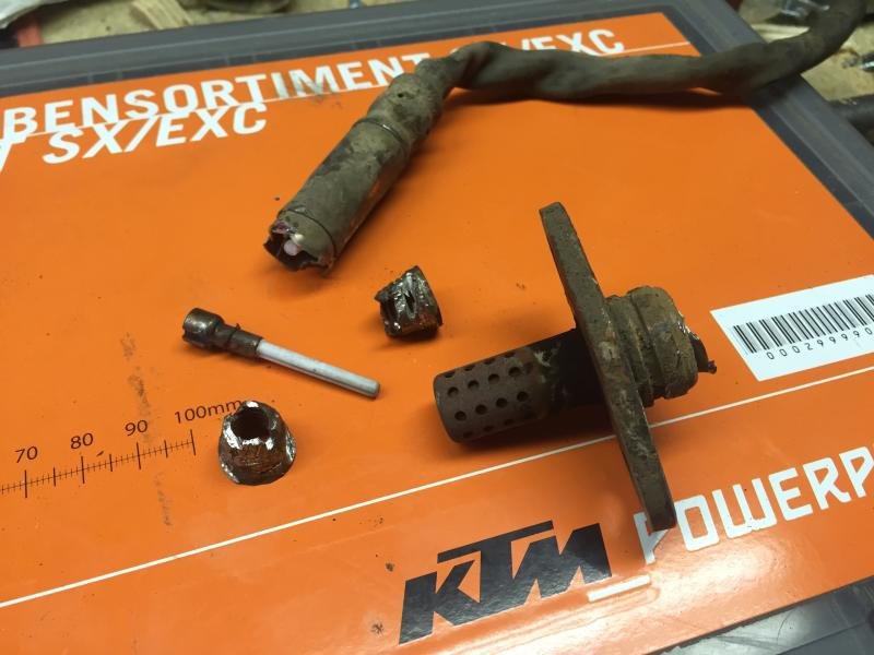

    O2 sensors took a little longer than expected. The nuts were rounded off and with the little heat shield in place you couldn't fit vice grips in there. I would estimate 8 man hours into swapping those bastards out. I kept getting intermittent faults for both a too rich and too lean condition. How can that be? Bad oxygen sniffers that's how. It runs like a Swiss watch now.

    Yeah, and the FJ80 has the old school style o2 sensors held on with two studs instead of the new style screw in sensor (yours will be much easier!). This sort of thing is to be expected when wrenching on a 25 year old rig. I was to the point I considered cutting that section of the exhaust out and just welding in new bungs. It would have been faster.
