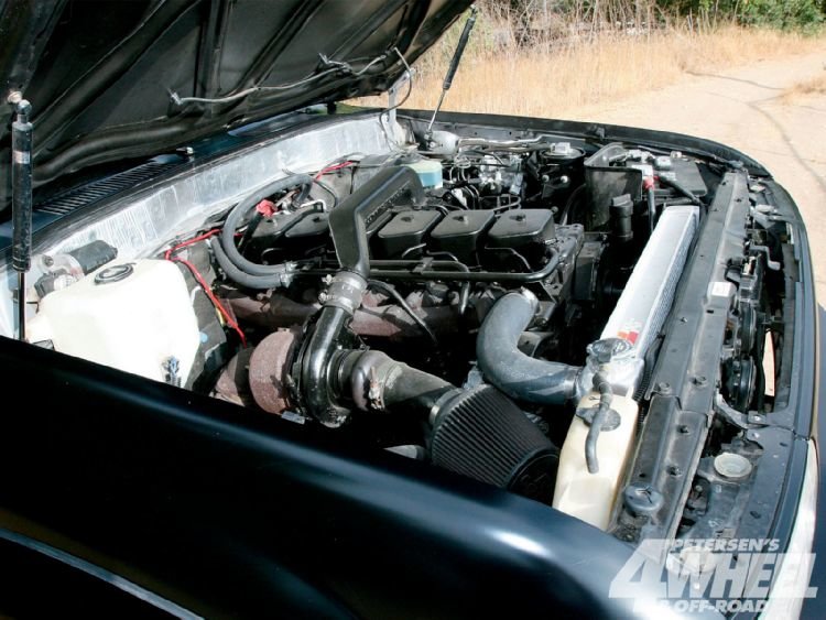

    There is plenty of room for the 6BT too. They are just difficult to find for a reasonable price.

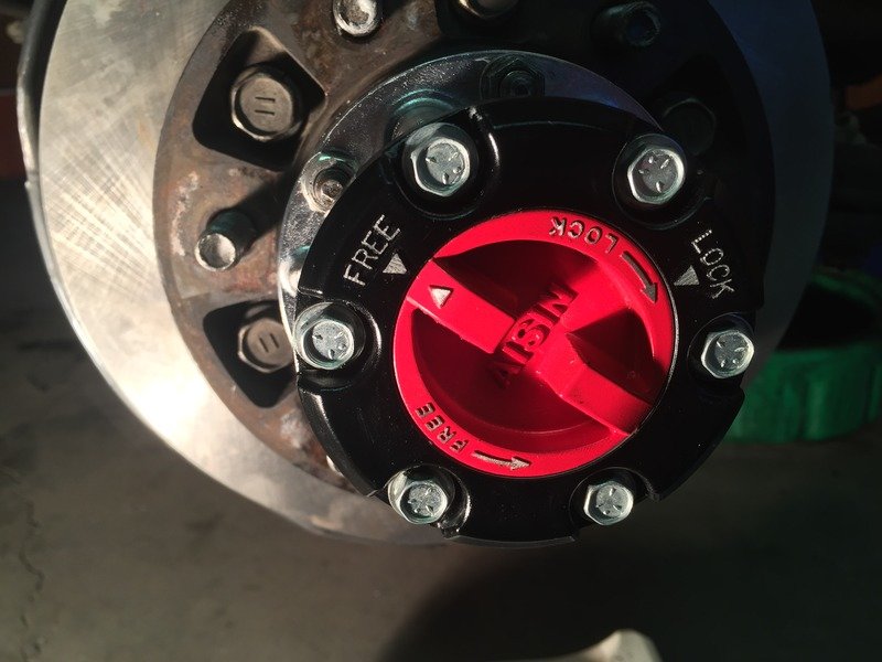

    One side is almost done. I underestimated how much fun it would be. New bearings, seals, and of course the part time hubs. I was only able to get one hub. Apparently there is some union strike going on with the longshoreman and my other hub is sitting in a container on the docks. Fuck unions, and I pity anyone forced to pay the bastards just to be able to go to work.

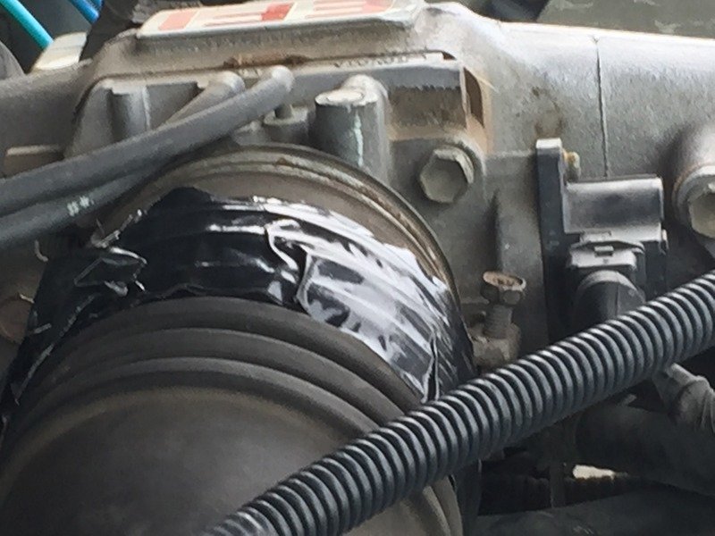

    Spent the last two weeks in the dirt with the dragon. She was beat up on hundreds of miles of washboard roads and no squeeks or rattles developed. These are solid machines. I did have a strange issue arise which took some hillbilly engineering to repair. I was in BFE, 40 miles from pavement on a two track when I tried to turn around. As soon as I put it in reverse, the idle would jump all over and it would die. That makes it impossible to turn around on said road. It took me a while to figure out that the intake boot was torn on the bottom (hidden) side, and when I put it in reverse the motor would flex, expanding the crack and allowing a large vacuum leak which killed the motor. I've been saying I could fix anything with duct tape for years, and for once it was true.
