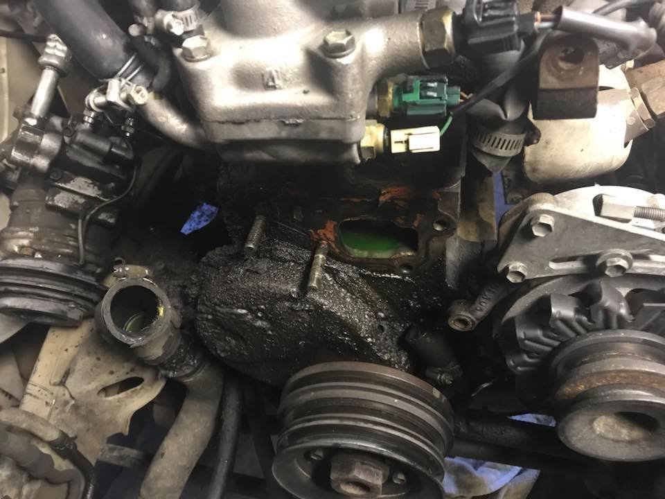

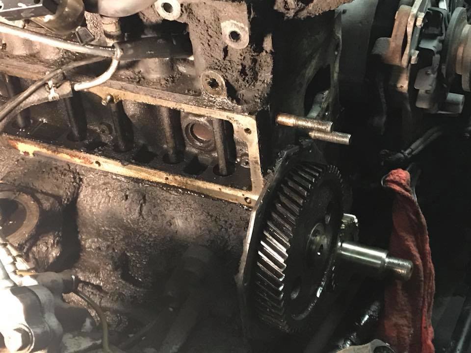

    Ended up fixing the ARB compressor I had, and bought a portable Viar for airing back up at the trailhead. Also did all new gaskets, water pump, power steering pump, pressure hose for power steering, and coolant/radiator hoses. The timing cover gasket was LOUD EXPLETIVES followed by busted knuckles. It's done though, and for the first time since I've owned it, she will idle for twenty minutes and not leave a drop of any liquid beneath her! Judging by the caked on mess on the frame, she has been leaking oil for many years before I got her.

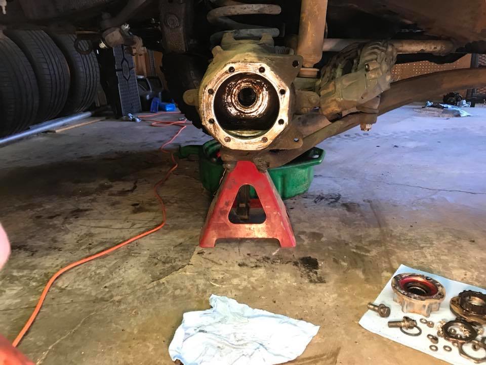

    Fixed the front locker. Broken X-ring. Also put a new driver side spindle on. The original one was worn juuuuuust enough to allow the outer bearing race to spin on it, which ate the thrust washer and would loosen the wheel bearing even though the nut never moved. Took me a while to figure that one out. Did new wheel bearings and inner axle seals while I was at it.
    Do you know why mechanics get paid so much? Because they're worth it. I'm tired.

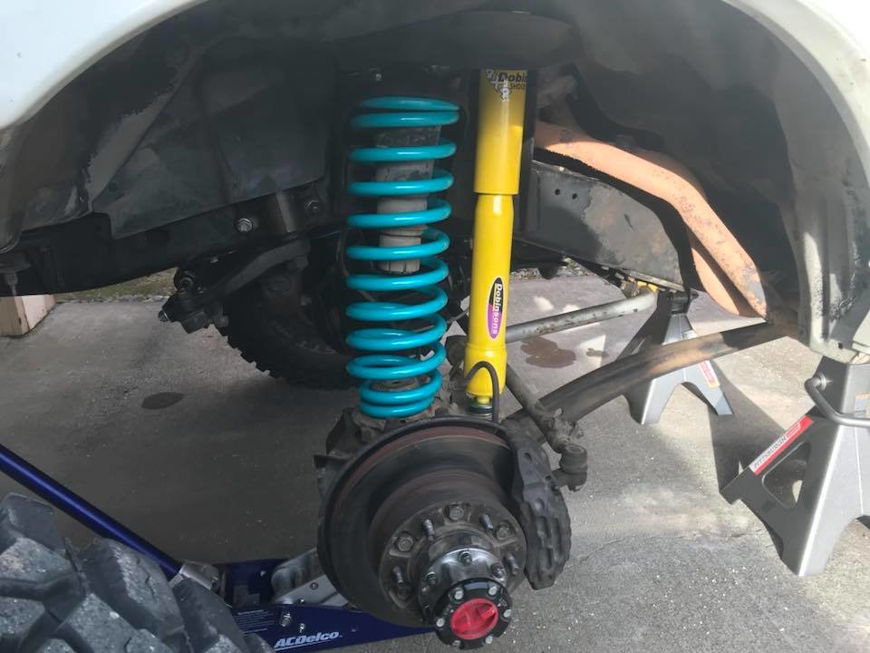

    New boingers. It rides much better now, and sits level instead of being stink bug.
