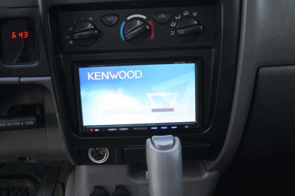

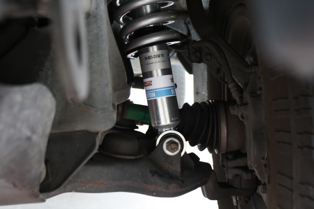

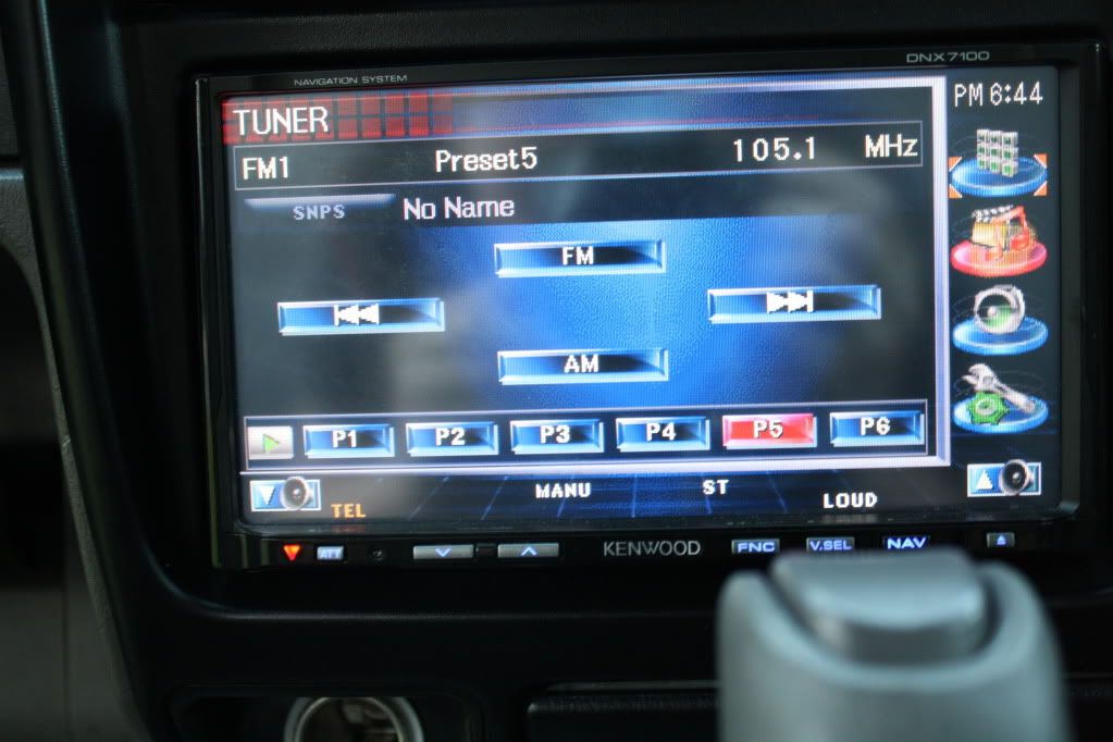

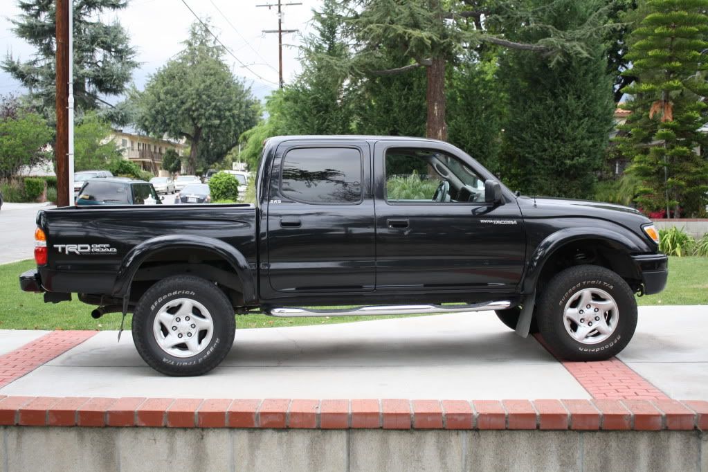

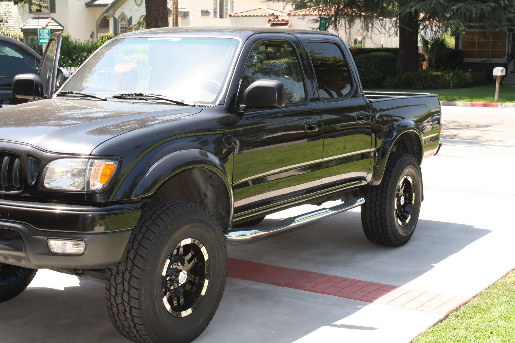

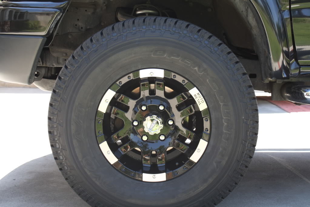

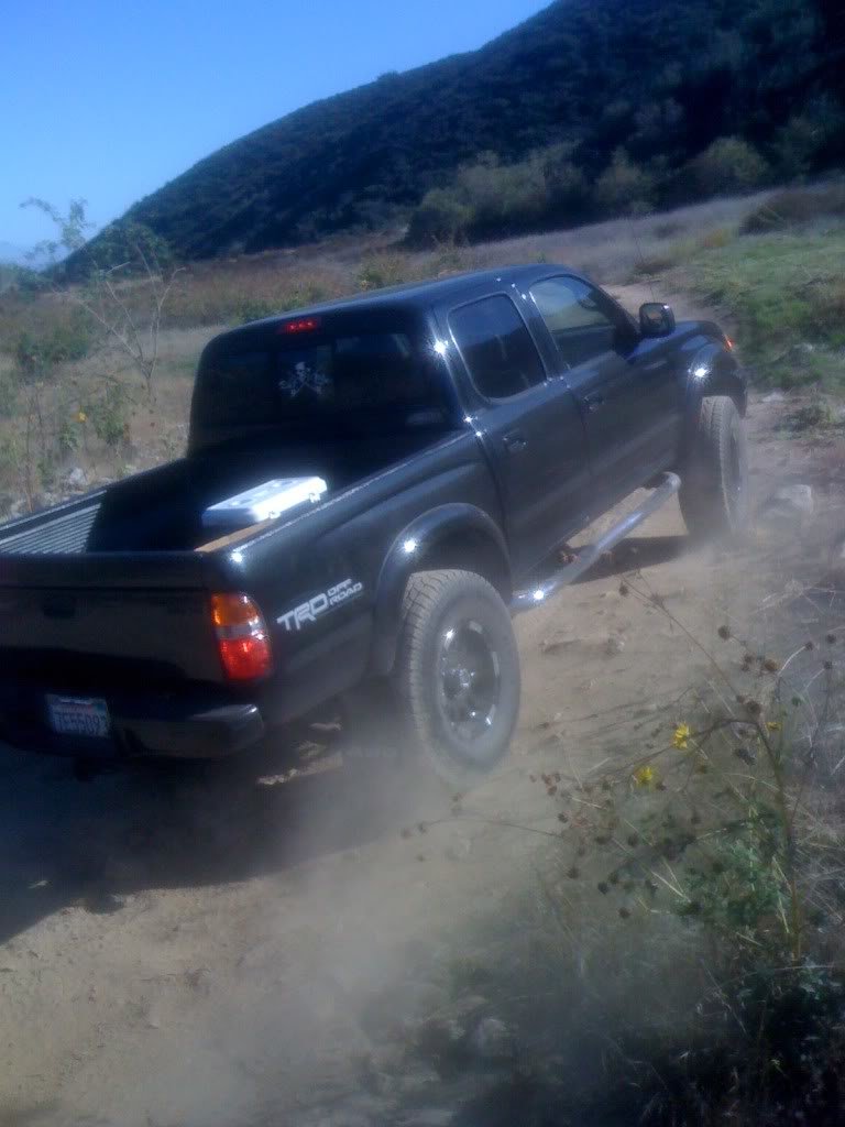

    Well here it is My truck is a black 2003 TRD SR5 4x4 DC. It has a 3" Eibach/Toytec coil spring with bilstein 5100's all around and a 2" AAL in the rear. Toyo open country A/T 285/75/16 wrapped around some Moto Metal 951's. I'm the original owner and it runs just as good as the day i got her! I have a Kenwood DNX7100 installed with Navigation

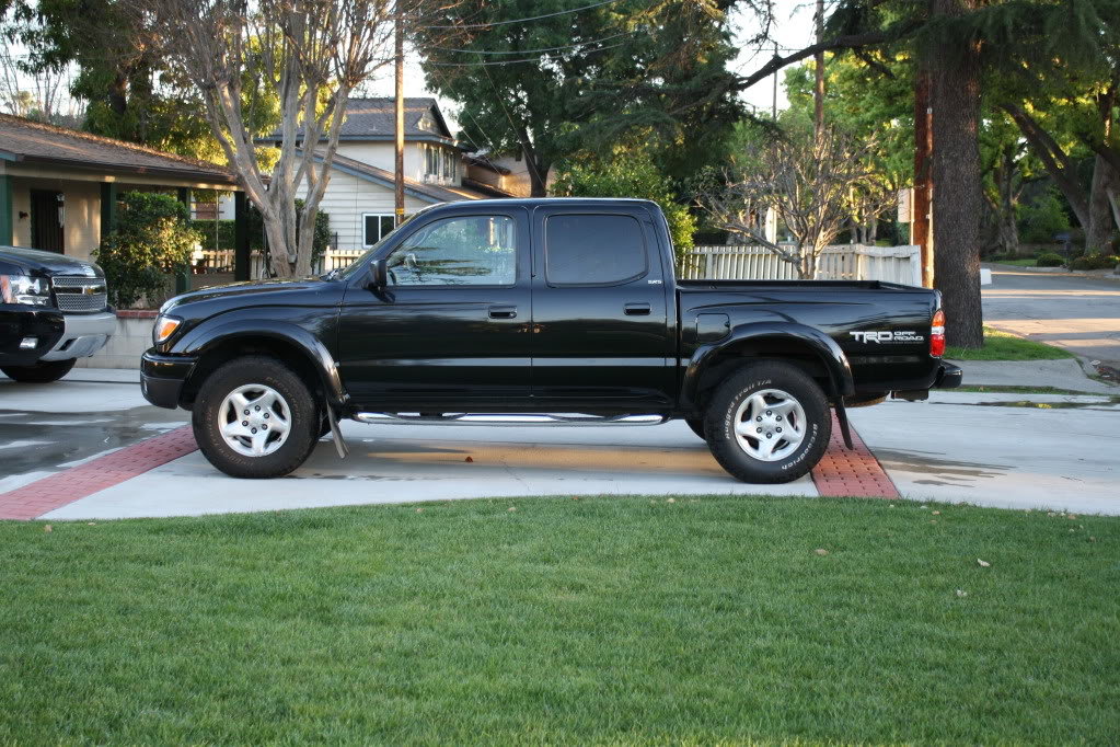

    How she sits Now

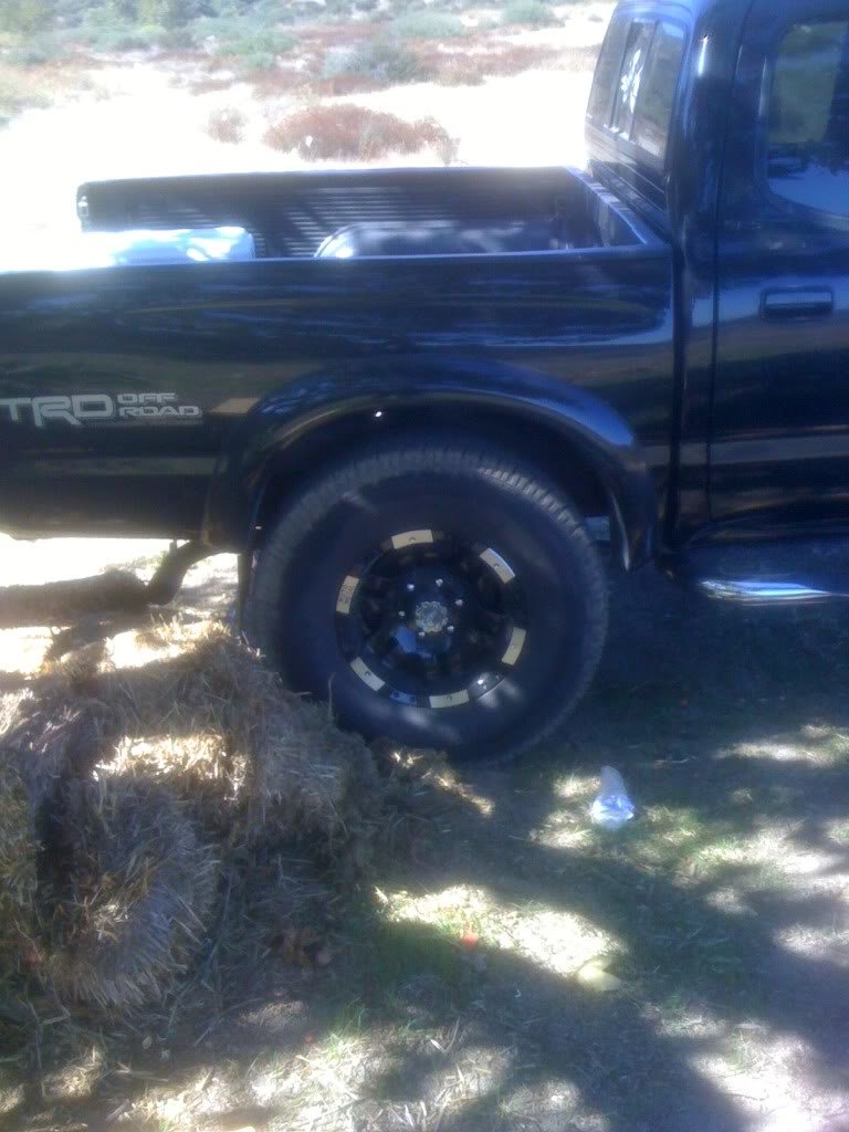

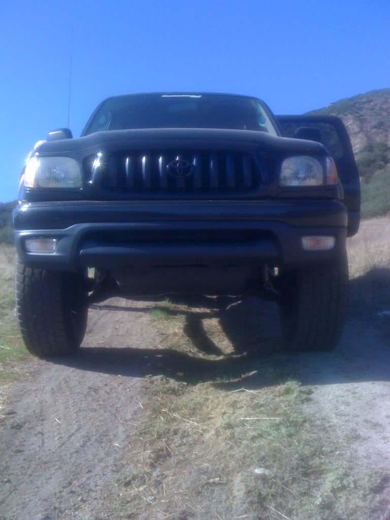

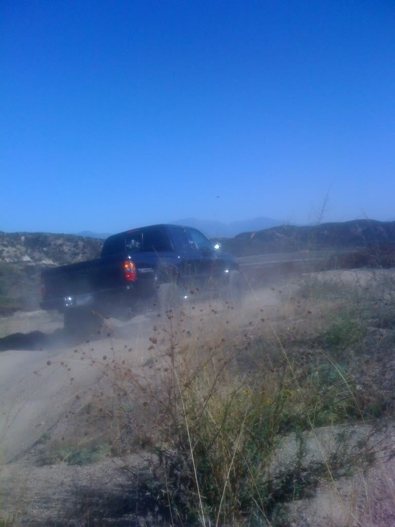

    Some wheeling pics 10/22/11
    baby flex
    I have a Salt Life sticker on the rear window:D
    Kenwood DNX7100

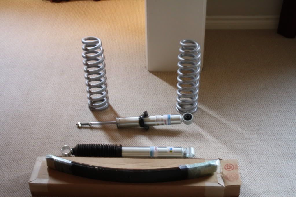

    This is the lift kit when i got it in the mail
    Got the kit on:D

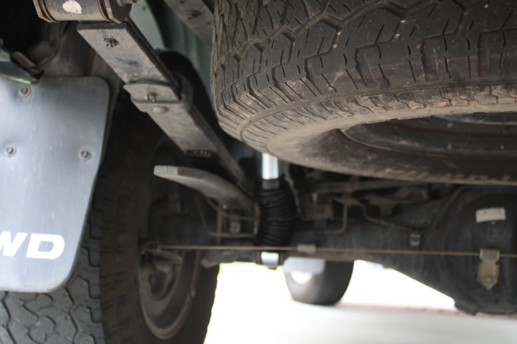

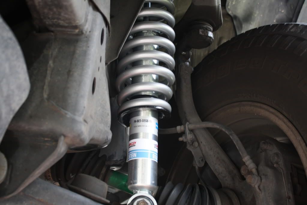

    front and rear suspension
    CV shot
    Before
    After

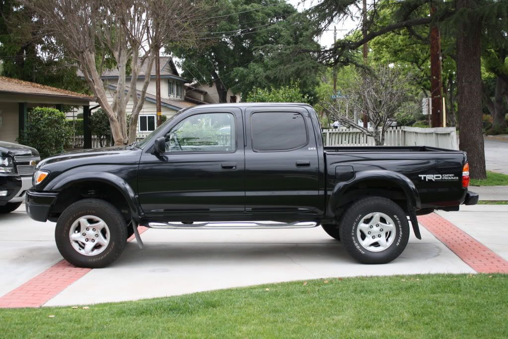

    My measurements before lift= LF:34.5 RF:34 5/8 LR:35 1/4 RR: 35 1/4
    After lift: LF: 38 RF: 38 1/4 LR: 37 3/4 RR: 37 3/4

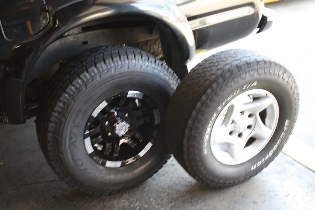

    Got new tires and wheels!
    Got my TW sticker!
    Thanks TCbob
    Future Mods:
    Subs
    exhaust: Flowmaster super 44
    Hope you like it so far

    Hey I just noticed something, why do you have one side de-badged and not the other? Just curious

    i've never had any badges on the drivers side

    the driver side must have been repainted at some point in time.

    nope, its never been repainted. i'm the original owner and theres never been a badge there. but i do plan on debadging the the whole truck and painting her matte black

    I think your rear billies are upside down

    Lil - My billy kit is on the way, been reading a lot about how on many first gens the rear's are meant to be shaft-down as the reverse of that causes the shock body to rub the leaf/may not even be able to install. If memory serves, this isn't an issue on second gens, and the shock itself will still function normally.
    *edit and there's also debate about the benefits of shaft down as while yes it will see more road debris, the shaft is stronger then the body so having the body higher up, away from rocks etc. helps keep it clear of dents and dings. Also, debris will have a tougher time sticking to the seal area due to our friend gravity.

    Thanks i appreciate the comments. and i asked a buddy of mine who used to own a lift installation shop and he told me rears go shaft down body up(but then again he went out of business). I met a killer dent remover and hes gonna remove all the dents in my truck!!:D

    Also, I forgot that the 1st gens had the difference with the rear billes. Oh well mine are boot up but thats just me. I've always though that the boot goes up and thats for any make. My dad's F150 is the same and so is my bro but thats also Ford so IDK :D
