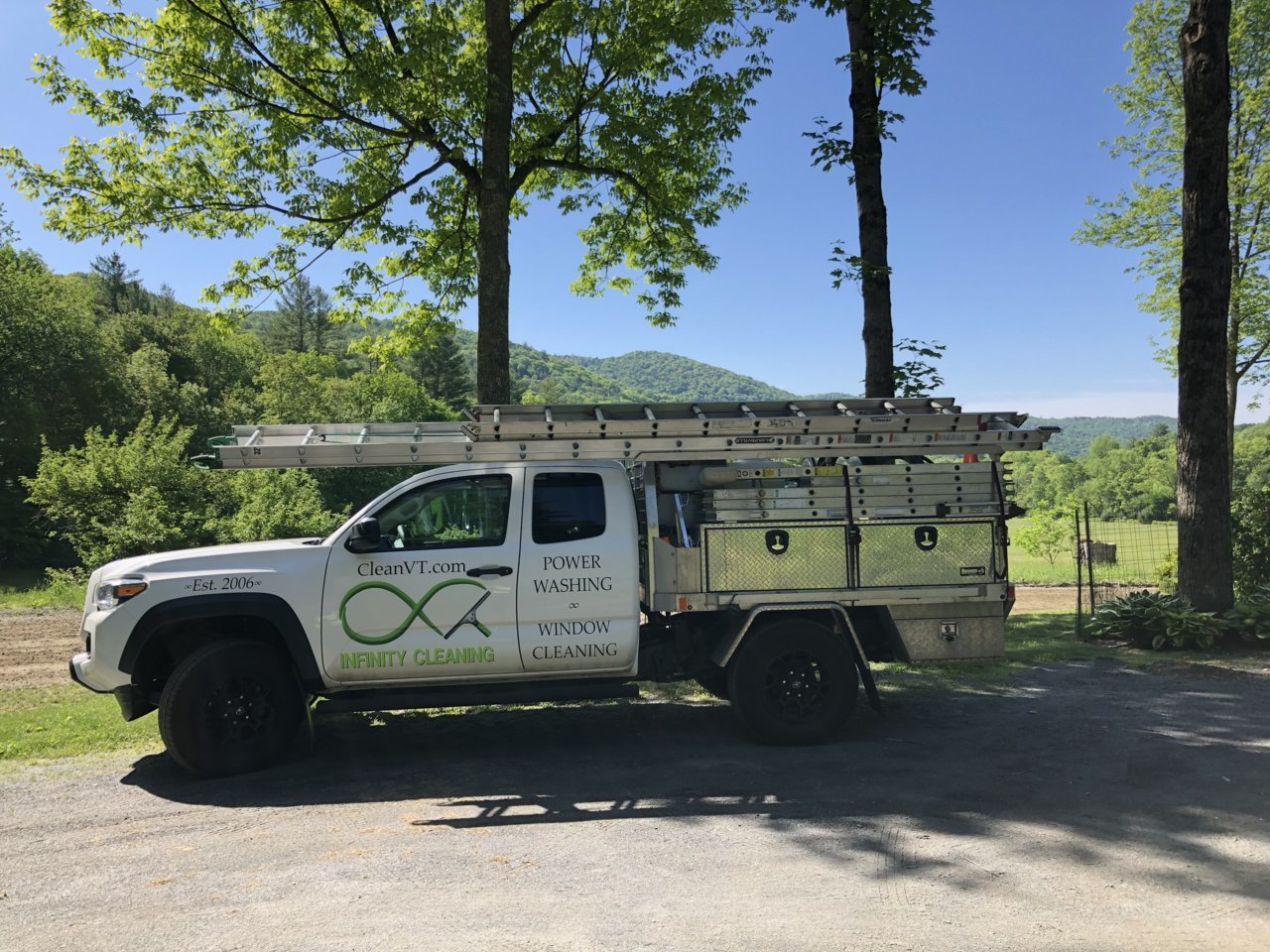

    A couple pics:
    A7EC0D5C-E7AC-4846-95DD-5BE3C498A497.jpg 8614FFE5-E6B7-428A-B366-33D46CB9E913.jpg
    Truck is going in to get re-lettered tomorrow (we rebranded). Then I’ll be reinstalling equipment that was in winter storage. So I will have some fresh, close up and detailed pics sometime next week.

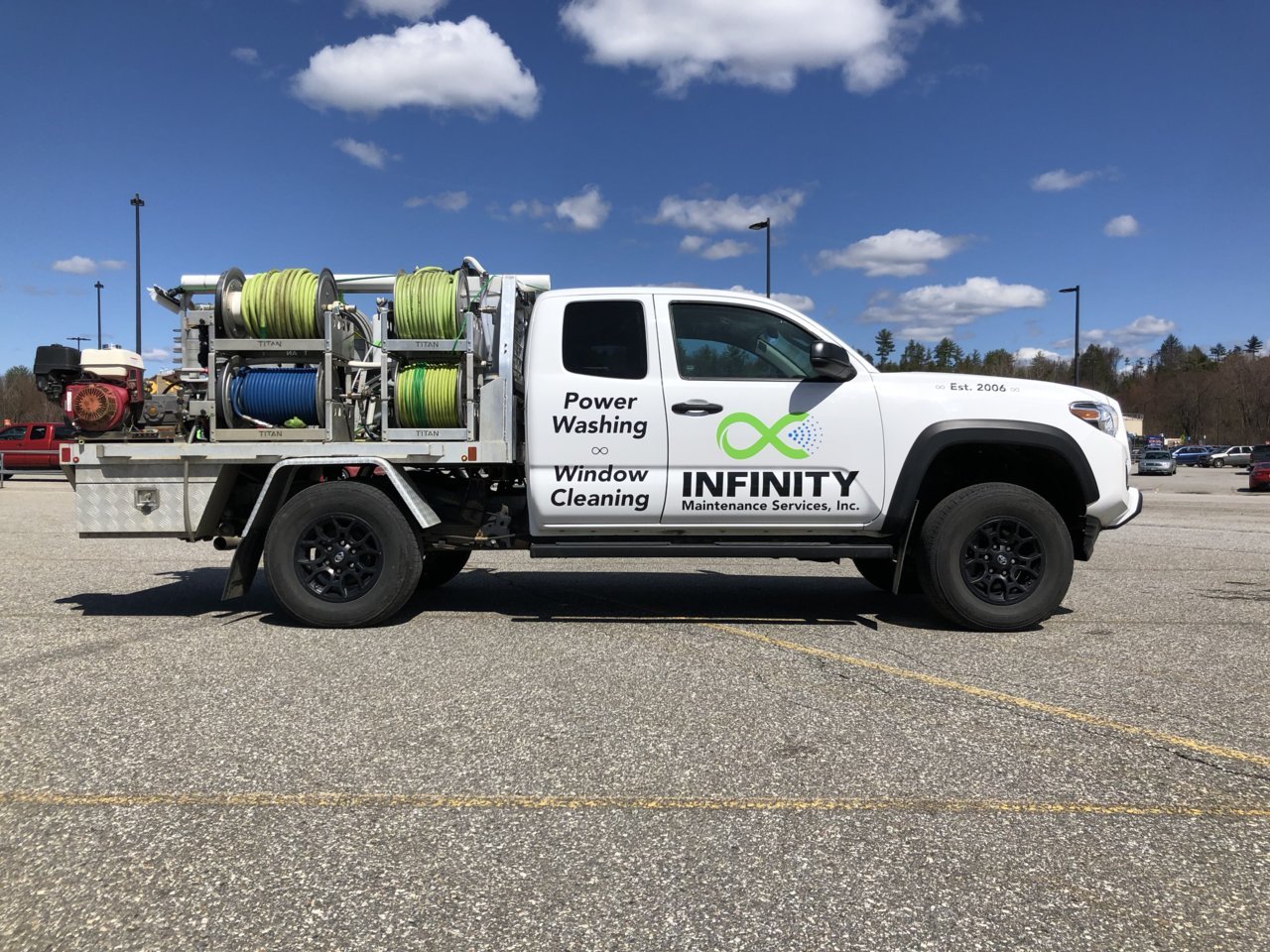

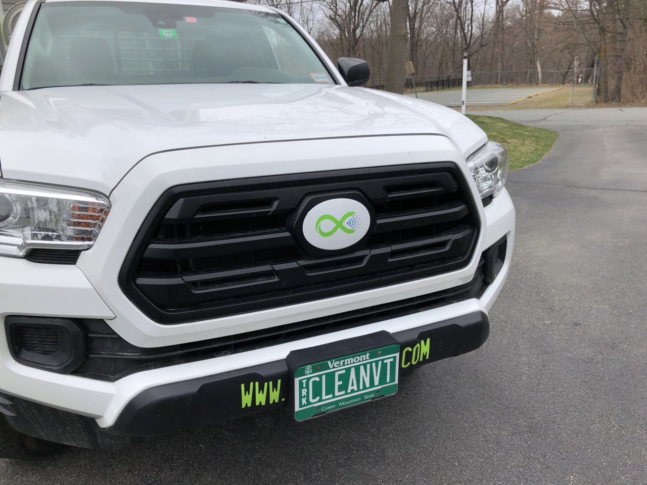

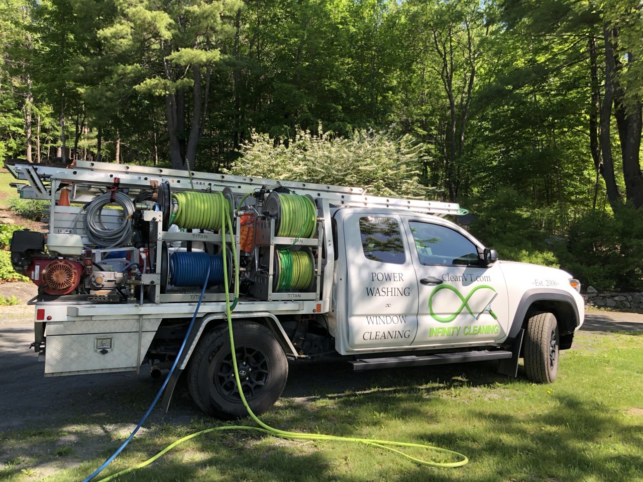

    Lettering went on this afternoon. I love my sign guy. Even did my window cleaning bucket, and did a logo for the grille emblem, too (no interference with the TSS radar system on the ride home).
    2EF9BD72-9F2D-4BAE-B929-DD0F3574E375.jpg A5075542-15B4-4600-B034-08C61A18F4EC.jpg

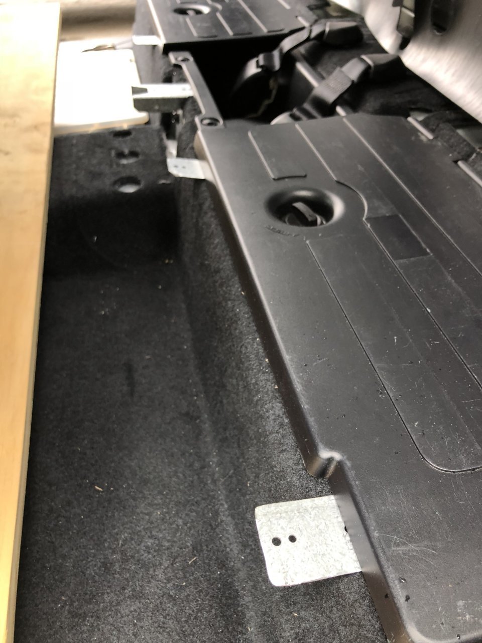

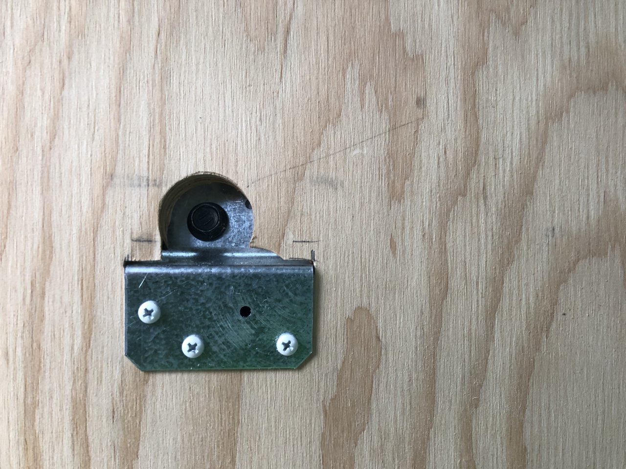

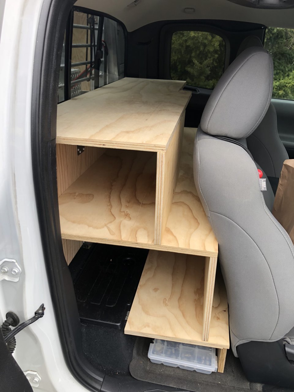

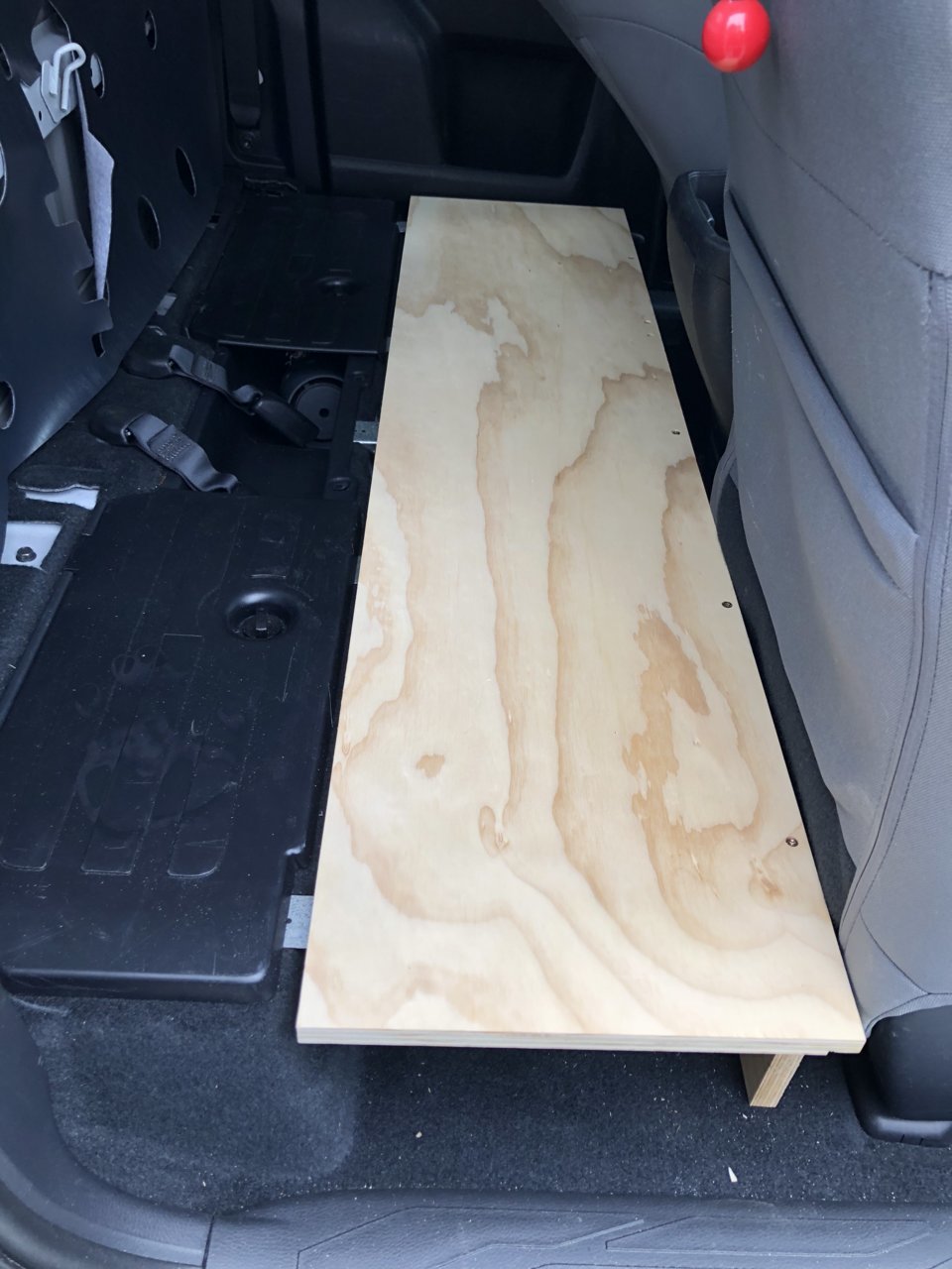

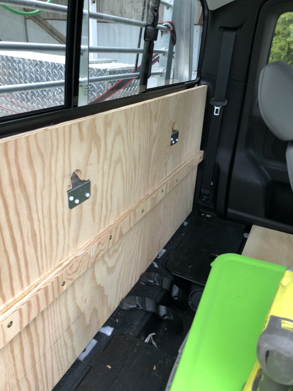

    Been working on a shelving system for the back of the cab. This is just the preliminary dry-fit:
    The edges will get rounded over with a router, then everything will get sanded and painted high gloss white. (Seats will not usually be that far back.)
    Maybe I can get a bit of modding cred for my fastening methods...? I could’ve just used self-tapping screws and been done with it
    Simpson StrongTie angle braces with an added 90° bend, slipped through a slot in the plywood, and bolted to a couple of the headrest mounting points:
    Small thin guage angle brackets slipped under/behind the plastic trim of the underseat storage bins:
    Bottom shelf supported by the angle brackets. I used an angle drill to screw into the underside of the shelf.

    I got my SR5 for a 'personal' work truck but not anything to make a living with like yours, so... dayum, kudos to you. I like your signage: tasteful, easy to read, and to the point. I hate looking at these 100% wrapped commercial vehicles where I have to 'read' the whole blasted thing just to find the company name that has ended up being completely overwhelmed. One suggestion tho, you may want to consider adding a phone # and web address. Are extended mirrors and/or rear-view camera mods in your plans?
    For the interior, I would suggest filleting the two lower front plywood corners, heavily round them over, fiberglass over that, and then paint.

    Thanks, @rick carpenter. Yes, I’ve really enjoyed working off this truck. I think it’s fair to say that its already paid for itself!
    I have progressively simplified my signage over the years. My previous vehicle wasn’t a full wrap, but it might well have been with how much reading it required, like you mentioned.
    I did have a web address on the last layout for this truck. People would confuse it with our business name, since it’s not the same. E.g., “Should I make the check out to CleanVT?”
    I ran an experiment last year with yard signs, and found that I got a higher response rate when they had *no* contact info (wasn’t an entirely scientific study, since there was no trackable contact info; I relied on customer feedback).
    We’re in a small market, so I think we’ve built a little brand recognition. I think it’s less for people to remember/read. And, it forces people to google us, which brings up all our reviews and photos, and that basically does the selling for us.
    It’s counterintuitive, but I think dropping the contact info might help the truck bring in more leads, as well.
    I’m not sure I follow what you mean about “filleting the corners”. Could you elaborate?
    Fiberglass would probably make for a more polished look, but it’s sure to add more weight. I’m pushing the GVWR with this rig as it is. I already regret going with all 3/4” ply for the shelves. Could’ve done some of it at least with 1/2”.
    But my eventual plan is to bring the truck into the fabricating shop that built the ladder rack and some other stuff for me, and have them re-create the shelving out of aluminum.

    Awesome, thanks for the explanation! And that’s a good point about it eventually getting rough.
    The seats will probably only get pushed back that far once in a blue moon. I very rarely have a passenger, and when I do, they’re not usually tall enough to put the seat back.
    Driver’s seat will get leaned back for the occasional jobsite nap (yeah, I really do that from time to time. You wouldn’t believe what 10-15 minutes of shuteye can do for a day that’s dragging), but I will be careful not to jam it back against the plywood.

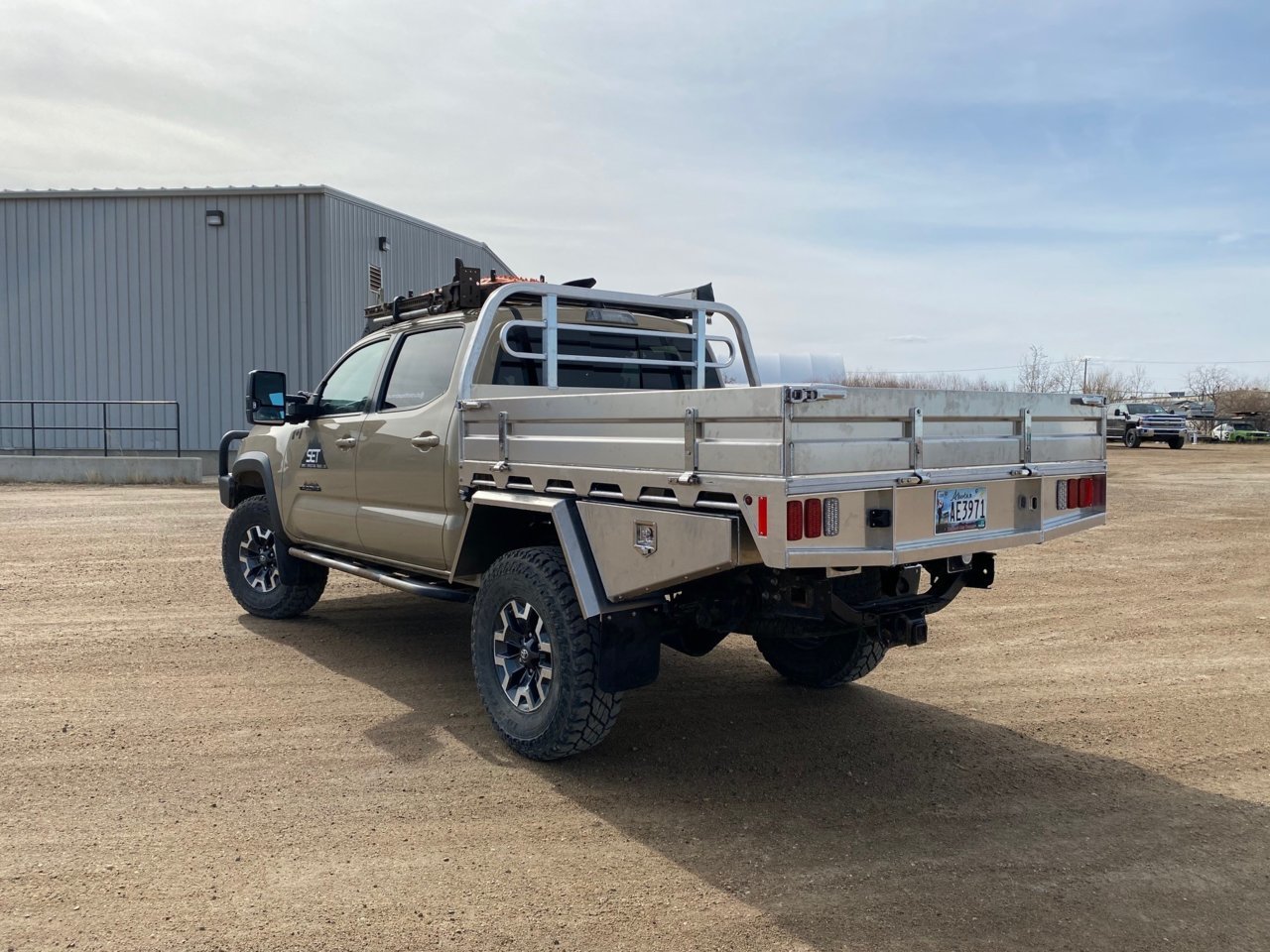

    I used a Dobinson heavy load rear leaf spring. Truck will ride even better once the canopy is on!
