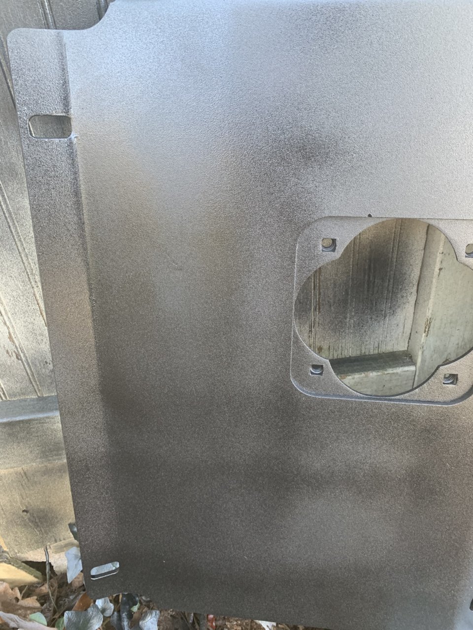

    Skids cleaned up and the first primer coat is on the expensive side.
    Here are some cleaned up shots and details.
    IFS skid
    Mid skid
    TC skid

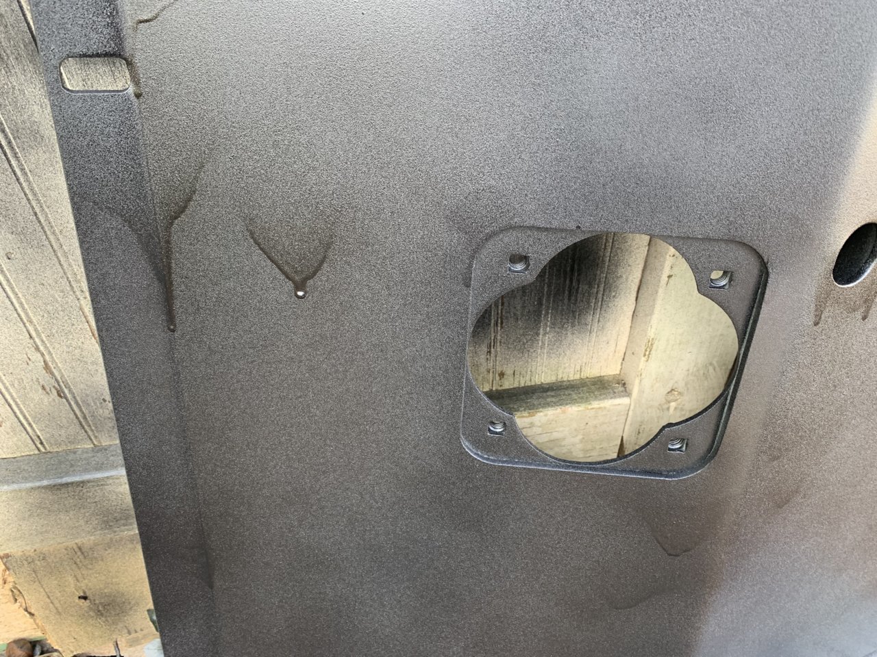

    OK, so if I had to do this again I'd likely choose to use roll on, at least for the skids. This took six or seven cans on primer (two coats) and eight cans of bed liner. And the bed liner isn't going to stand up to much, as I was having to touch up just from it touching the ground. However, it is pretty easy to fix even when you do all the wrong things.
    Here is my screwup where I put it on too thick and it dripped. Some sandpaper, mineral spirits, and a respray fixed that.
    What really irritated me was that the spray can dripped badly. As a result, I'd get droplets on (usually) key areas where it would require fixing. As I was finishing up the final coat (for now), I'd get drips on a few spots and it pissed me off. One section of the driver slider made me sand back down to bare metal, prime, and rebuild because I tried to sand when it was still wet. It was a rubbery mess. I have a couple of spots on that one on the tubes where it isn't perfect, but then these things are made to take punishment. I'll just have to stay on top of of retouching.
    At least I learned how to repair, so that won't be daunting.

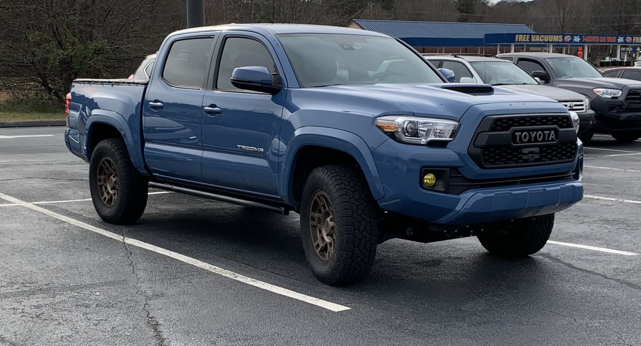

    Got a compliment from a dude in a Lexus SUV at Home Depot today. Couldn't think of any response other than thanks because I felt so shitty.
    Also, the reason for a shitty pic getting lunch. Hopefully I just strained my neck.
