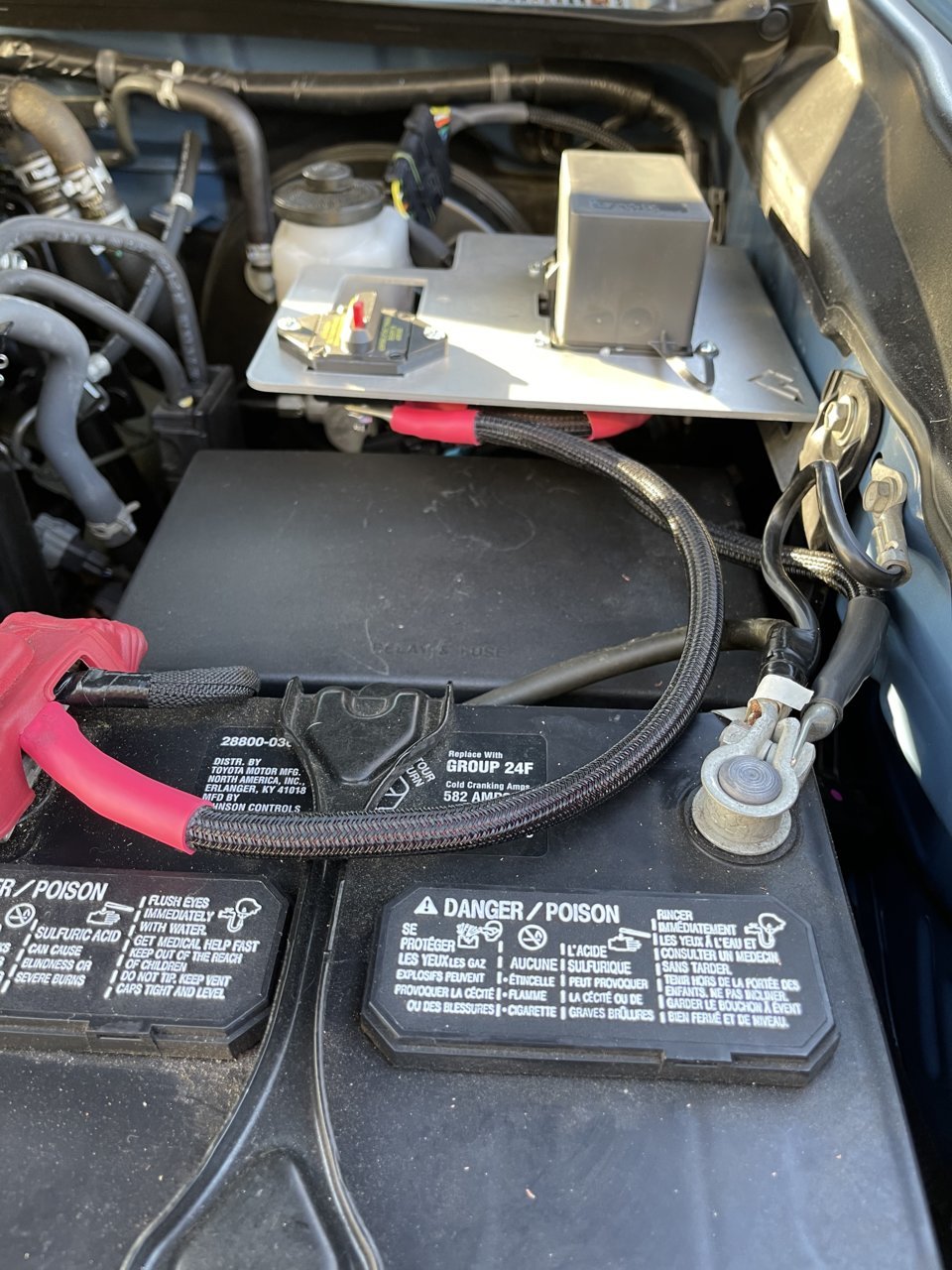

    Well, at least I knew what I was doing with the wiring. Fuse box goes in tomorrow and at last a test of the bumper light.

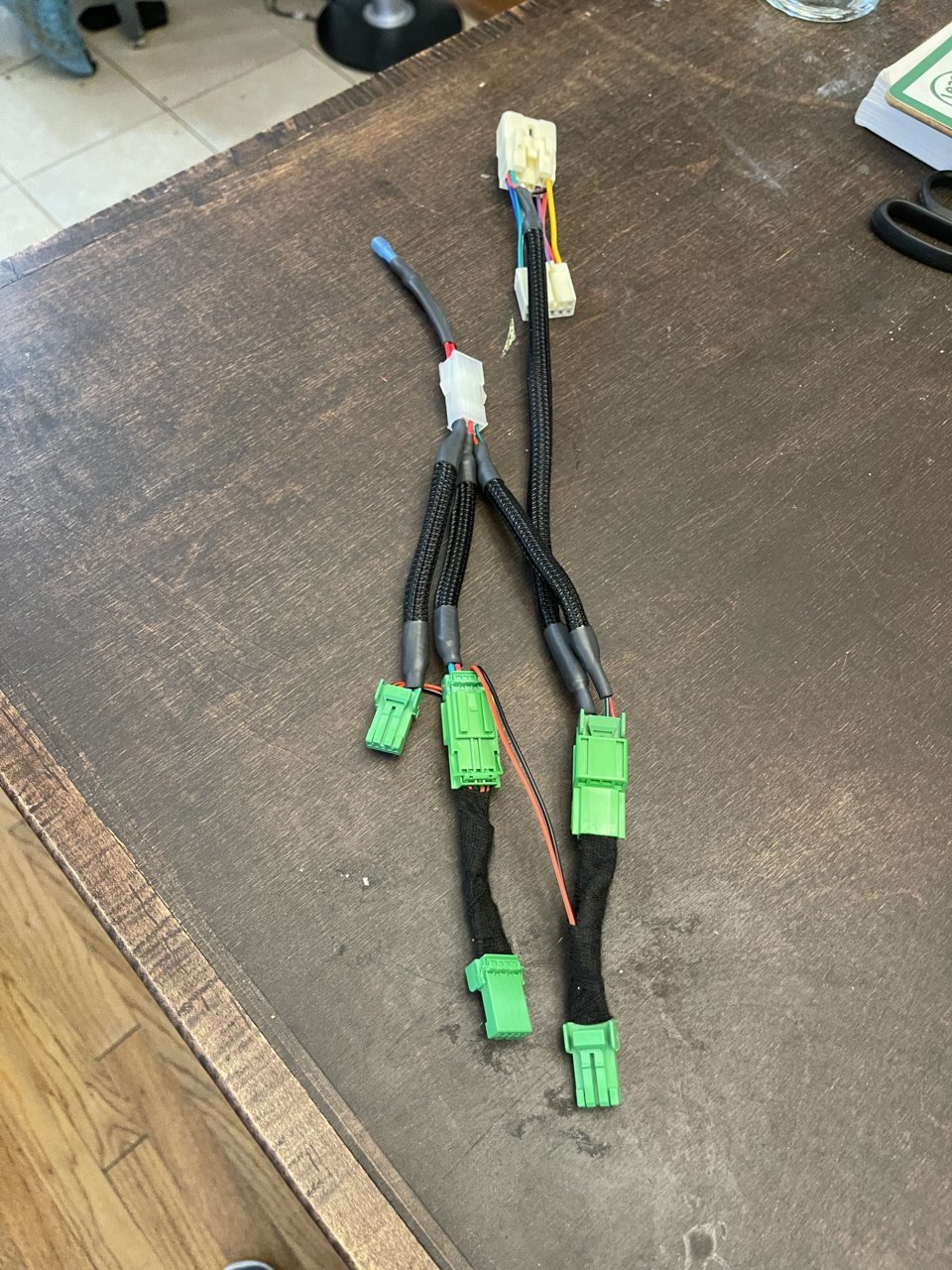

    I had a fairly hard time getting through the firewall grommet. I used an awl, a pair of scissors, but it was like the rubber was healing itself. Then I got out a drill and that finally opened things up. I used butt crimps to divide the 12v ACC signal wire to both switch locations, and then again at the switches themselves. I used some great wiring harnesses from @kmorgan3 and also some great advice via PM. Temporarily placed the two switches in the lower dash panel until I can get a MESO cubby pocket panel.
    Today should bring install of the Bussmann, finally. Need to put it in, then cut to length the positive and negative wires. Then hopefully there is enough daylight to approximately wire up the bumper light to where it will be installed and finally test that out.

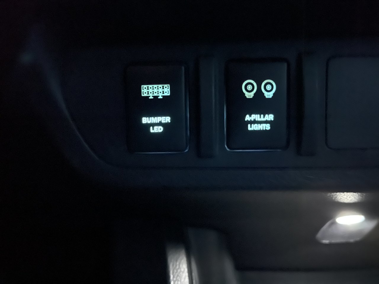

    The install is finally done.
    Temporarily hooked up the bumper light for testing, and that works too. Hooked up to the wrong button, but that's okay.
