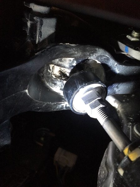

    My clutch pedal squeaks horribly. Anyone have the same issue?

    There is a ball and socket connection attached to the pedal. Its the clutch pedal sub assembly. There is a hole on the passenger side of the socket. Stick a spray can of lithium grease and give it a shot. Don't over grease, or it will just be pushed out.
    The round piece is the bottom of the socket. The actual ball is about 3/8" round, which sits on top of that piece. The socket is the piece on top, with grease smashed in to it. Mine failed, thats why it looks like shit in the picture
