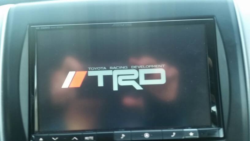

    Follow up to the stereo install now that I have received everything for full factory integration. This will be a generic post for most aftermarket heads units. (not specific to my Alpine INE-Z928HD)
    Parts I used for factory integration in my 2012. (From what I can tell, 2013+ will need different wiring harnesses, but they are available):
    -Metra ASWC-1 for steering wheel controls
    -Metra 70-8114 steering wheel wiring harness and aux input jack
    -Metra TOY-USB-2 for USB plug (2013+ needs TOY-USB without the -2)
    -Generic USB extension cable
    Metra has made this super easy to do! The 70-8114 requires you to attach it to the switched +12V (red) and ground (black) from the main stereo wiring harness and everything else is ready to go. It plugs into the ASWC-1, the OEM steering wheel control harness, and the back of your aftermarket head unit using a 3.5mm jack for the steering wheel controls and red and white RCA's for the auxiliary input (3.5mm headphone jack by the factory USB plug).
    The toughest part was figuring out where the USB adapter went. If you remove the glovebox, there is a "multimedia panel" to the right of the cabin air filter with a bunch of connectors going into it. Find the brown one (only one that looks at all like it will fit in the TOY-USB-2), unplug, and instead connect to your USB adapter (pic below). The adapter cable isn't long enough to reach the USB port on the back of your new aftermarket stereo, so you'll have to use a generic USB extension cable. Run the USB cable through the dash to the stereo and plug it in.
    Button everything up and you're good to go. The ASWC-1 automatically detects which vehicle it's in - no programming necessary. You now have an awesome aftermarket stereo with full use of your USB plug, aux input jack, and steering wheel controls.
    Pic of stereo (I was actually on the middle of the river. GPS is correct):
    I have been trying to figure out how to change the splash screen on my INE-928HD as well. The default Alpine logo doesn't do it for me. I found a how to on a porsche forum with the following steps, but my stereo seems to hang on the "please wait" screen. I'll post an update if I figure it out. If anyone has the same stereo, let me know if it works for you.
    How to change splash screen image:
    1)Get a picture you like, resize to 800x480 and save as a BMP with file name apn_pa_opening.bmp
    2)Put that file on a USB stick and plug it into your trucks USB port (turn stereo on)
    3)Go to the FM radio screen and hold the "band" touch screen button for at least 2 seconds
    4)Press the nav/audio split screen button
    5)Press phone hard button
    6)Press volume down hard button
    7)"Please wait" comes up on the screen, stereo reboots and new splash screen should be there.

    I just resaved my image file in paint instead of using a file converter and the steps above worked perfectly. It seems the head unit is just very picky about the file.

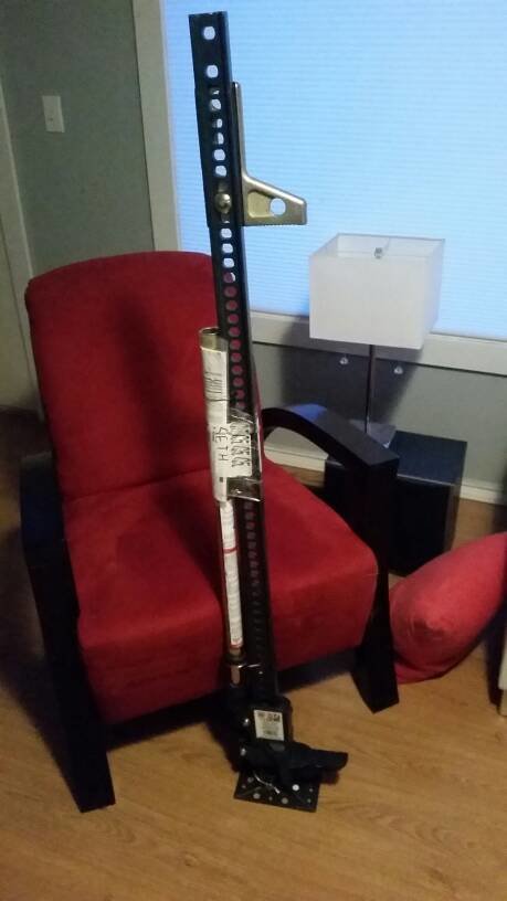

    Christmas finally came! My mom got me a 60" hi lift xtreme. I just got it today due to some online shopping mishaps. Amazon was pretty darn good to deal with though. Now to figure out mounting the sucker.

    You should check out All Pro's hi lift mount for the bed rails! Love your truck man! Black is the best color!

    Nice! I have a hi lift extreme and I welded some grade 8 1/2" bolts into my bedrack and have it mounted on the side like so. Just an idea for ya.

    X2
    Easy access that you don't need to unload your bed for.

    I like it. Do you lock it up? I guess a cable lock could tie it to the bed rack pretty easy

    Just a little cable lock around the bed rack, it'll keep honest thieves honest but that's about it.

    I actually drilled a couple holes in the ends of the bolts and have a small master lock on each bolt end. Like @ckeene9 said, it'll keep honest thieves honest. I mean if someone reeeeaaallly wants it, they could take it. But that's the same with a lot of light bars and stuff too. But a cable lock would totally work too!
