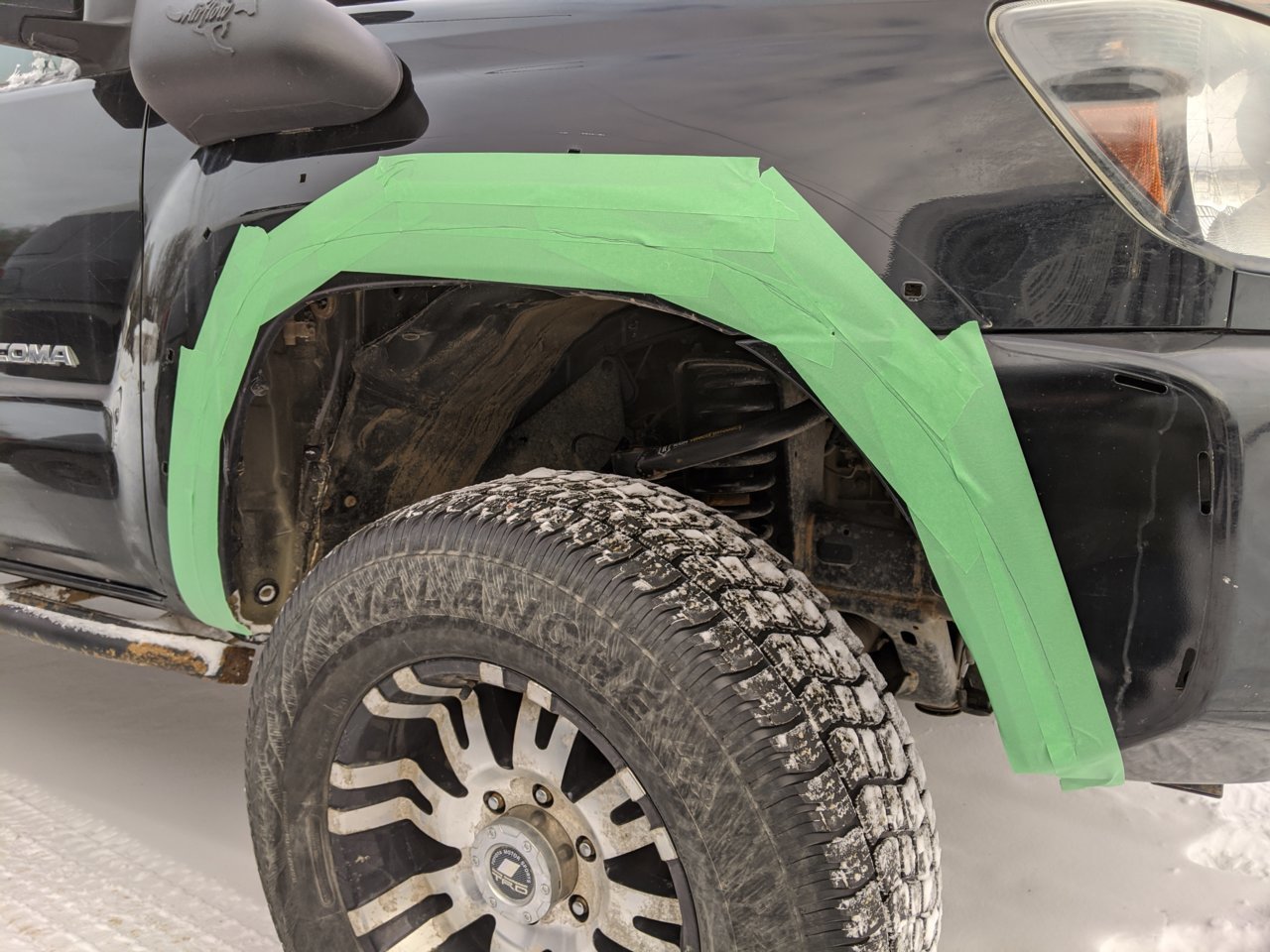

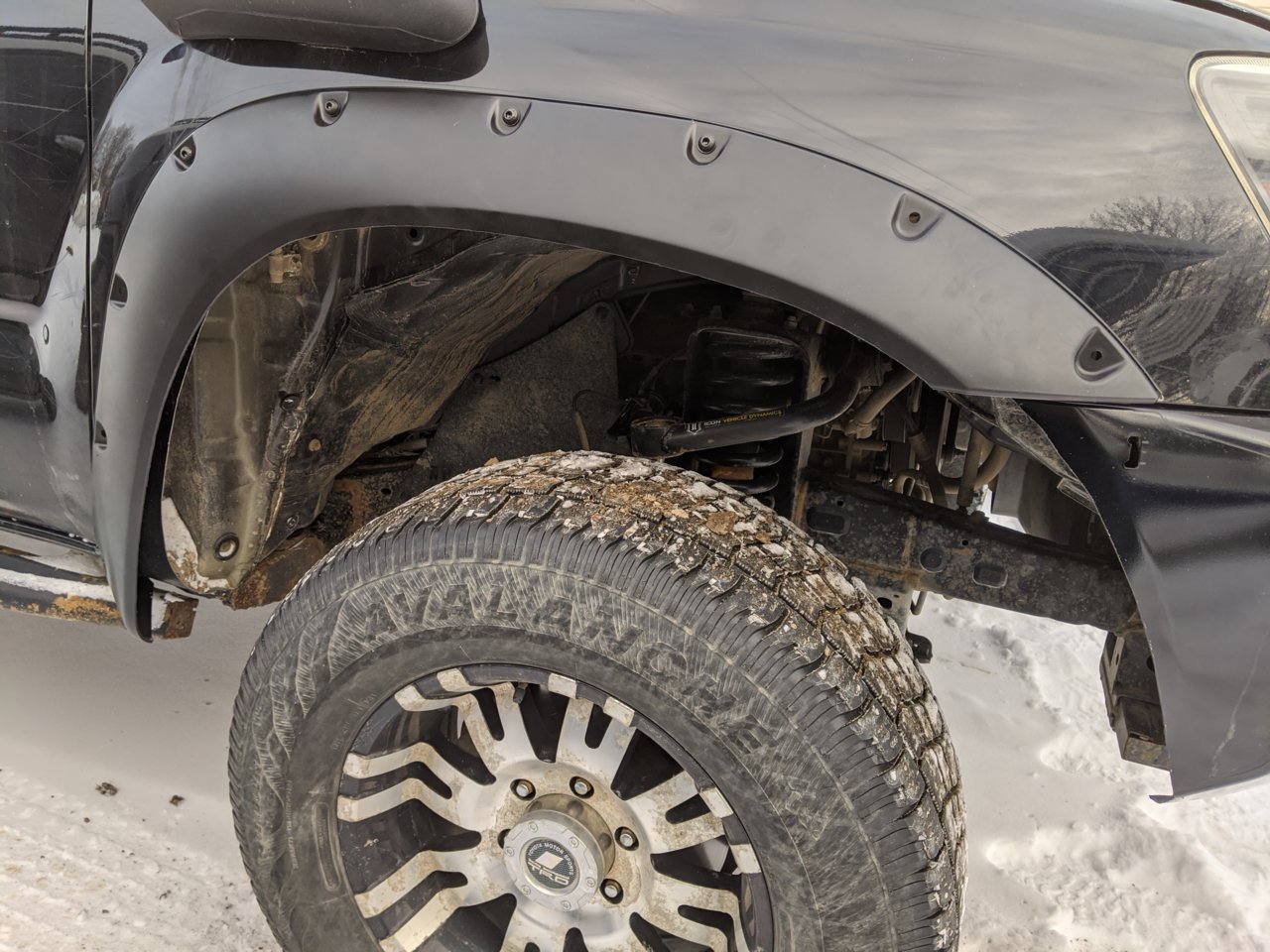

    Got some time to work on my fender flares today. Imitation Bush Wackers. Trimmed them 2+ inches and test fit the drivers side. Gonna be sweet! I got some black nitride hardware to mount them to the fenders. Bedsides are already cut (did it way back when I installed the high clearance rear bumper), but I'll have to cut a couple inches out of the front fenders before I bolt the flares on for good. Might give them a coat of paint too.

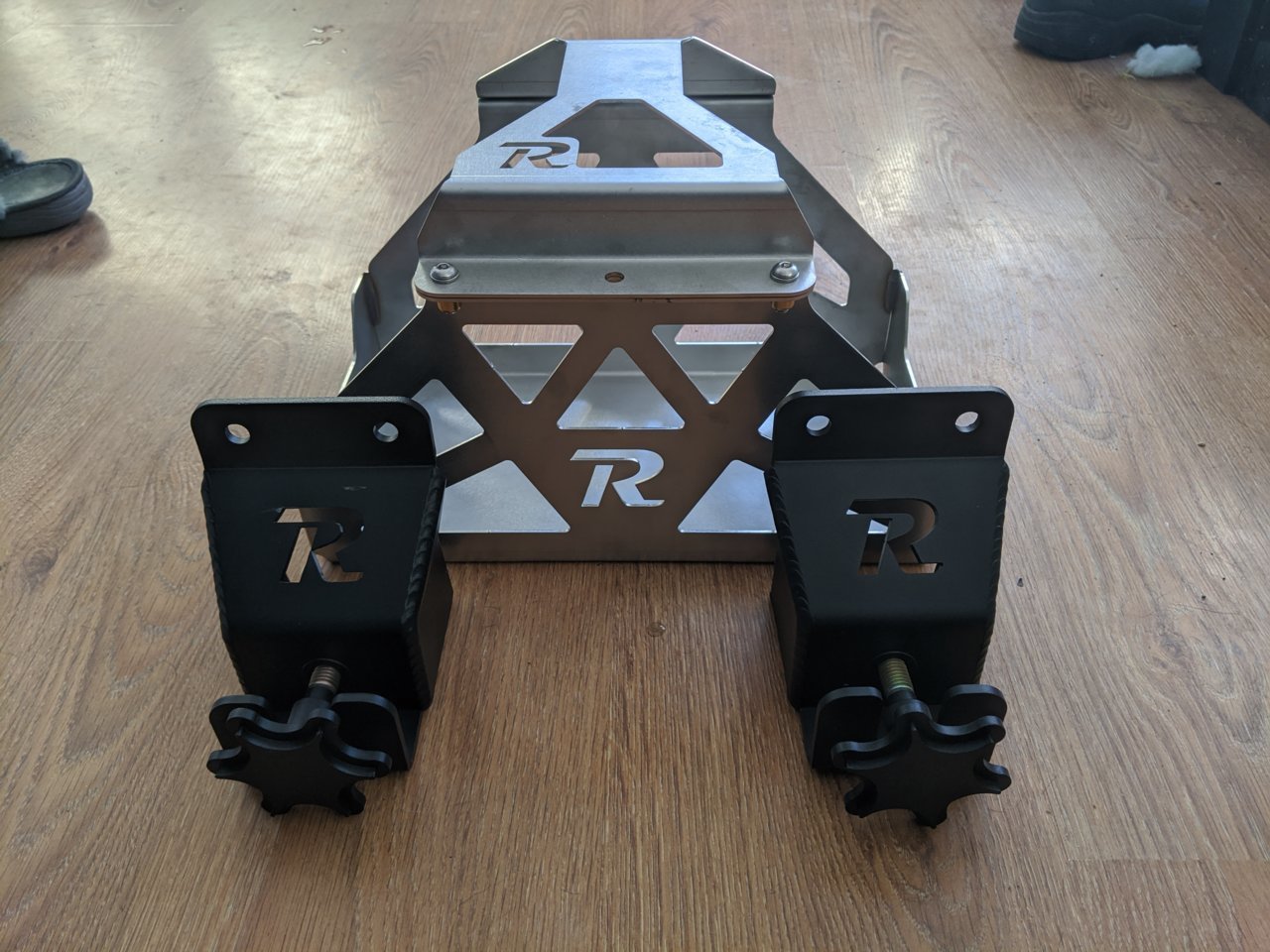

    Battery cage showed up today. I'm waiting on the Slee battery terminal extensions in the mail and I haven't ordered the battery for it yet, but progress?
    I also got the bed rail hilift mounts from Rago. I planned on DIYing something simpler, but after years of not getting around to it I thought I'd cave and buy these. They are incredibly well made. I'm really impressed.. which is good considering they cost a small fortune. They didn't seem that bad when I decided to order them, but our CAD/USD rate isn't great, they needed a bit more $ for shipping to my remote home (fair enough), then the duties at pickup sucked too.

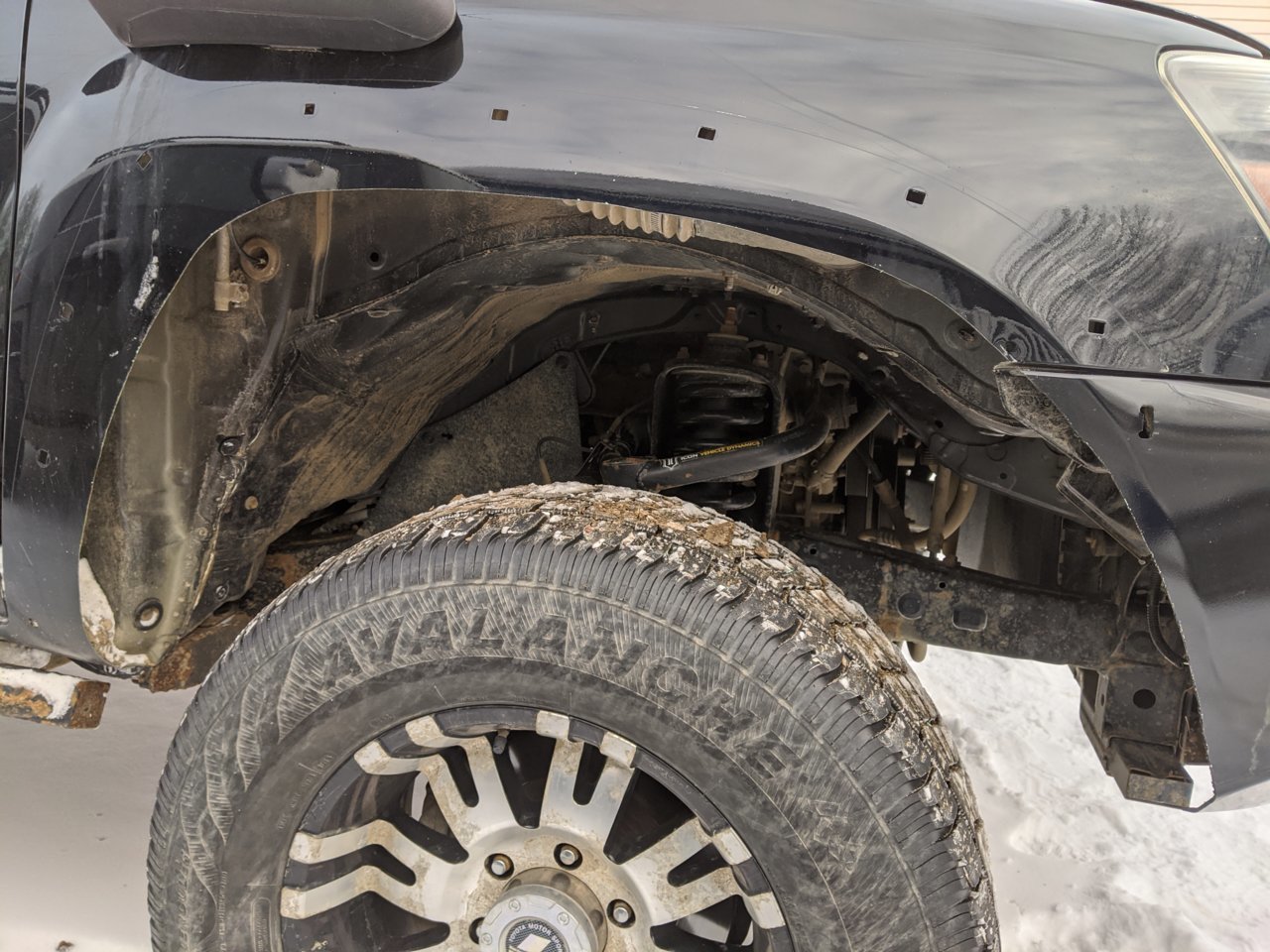

    It warmed up to -14C this afternoon so I went out to the driveway to make use of the nice weather. Cut front passenger fender back 2 inches and mocked up the fender flares that I had also cut 2" out of. Painted the exposed metal from the cut with a touch up pen and marked a couple holes that I need to drill because they didn't line up. Perhaps tomorrow will be the day they finally get bolted on...

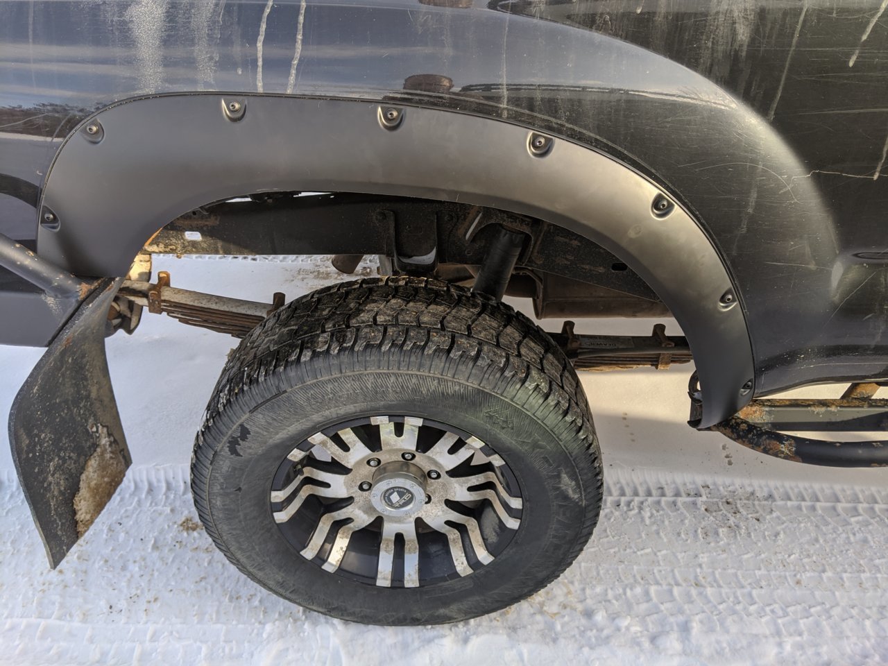

    Got the passenger side bolted on today! Would have liked to do driver too, but I'm short some M8 nyloc nuts so it'll have to wait.
    I was going to paint them... But I kind of like the look the way they are.

    Drivers side finished today. Finally, a project I can mark as complete!

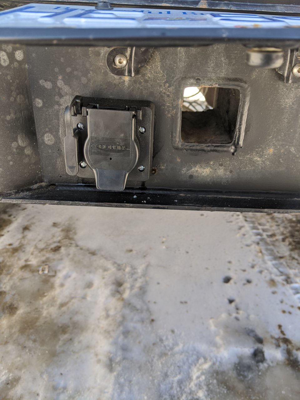

    Replaced the 7 pin trailer plug with a nicer aftermarket one. I've had an aftermarket one on the truck since I smashed the original almost right away, but it held the trailer plug kind of loosely. New one is much nicer quality and also has a 4 pin connector so I won't need an adapter anymore. Cleaned the wiring connector out too as it was looking slightly corroded.

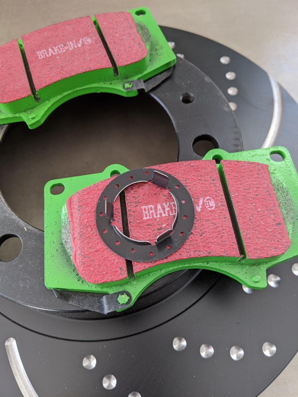

    Ordered EBC brake kit w/ green stuff pads and drilled/slotted rotors. I kind of wanted the yellow stuff pads and plain rotors, but they weren't in stock on Amazon and this way I'll get to install next weekend.

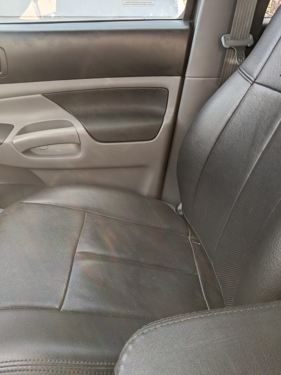

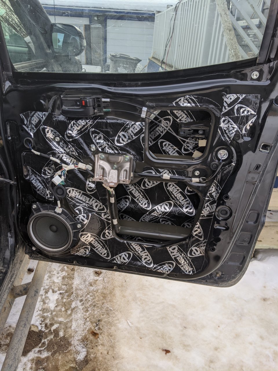

    Working my way down the mod list and parts pile and I hit one that has been collecting dust for 5-6 years. When I ordered my Clazzios I got some extra matching fabric to do the arm rests in the door panels. Well, I pulled all the door panels off and got mostly done the new arm rests, but I haven't put them back in yet. I drove to grab some food part way through and HOLY CRAP the road noise was terrible without door panels. If that plastic makes that much of a difference imagine what some dynomat will do. So.. tomorrow afternoon's activities are planned.

    IMG_20200322_141755.jpg I forgot how time consuming this is. This time I left all the access holes and bolt heads open so it would not impede future maintenance, shooting for 50-75% coverage of inner and outer. Not exactly performance audio level work, but it did a hell of a lot of good. The tap test results are amazing. But... I still have one door left to do. Because slow and lazy.

    New brakes came! So fast! They specifically say -not- to use grease on the back of the pads with their little cup things. Seems a bit strange to me, but I guess they probably know what they're talking about.

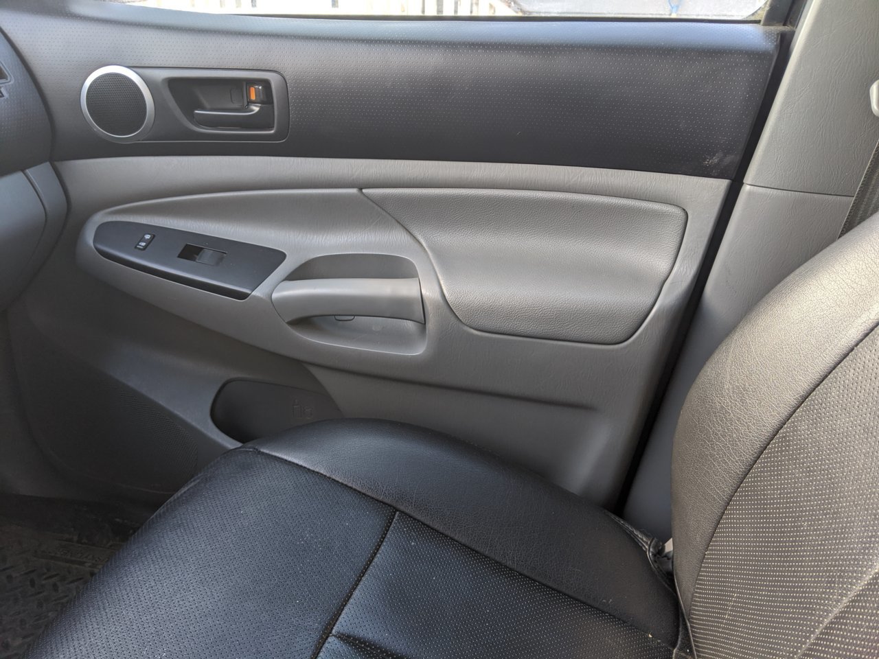

    Finished the arm rests a few days ago but forgot the pics! I put 2600 highway kms on in the last couple days (wife's flight home got cancelled and I had to go pick her up) and got to test the sound deadened doors. They're noticably quieter, but a lot of road noise is getting in the floor and from the rear seat area so overall impact on cab noise wasn't as much as I hoped.
    Before:
    After:
