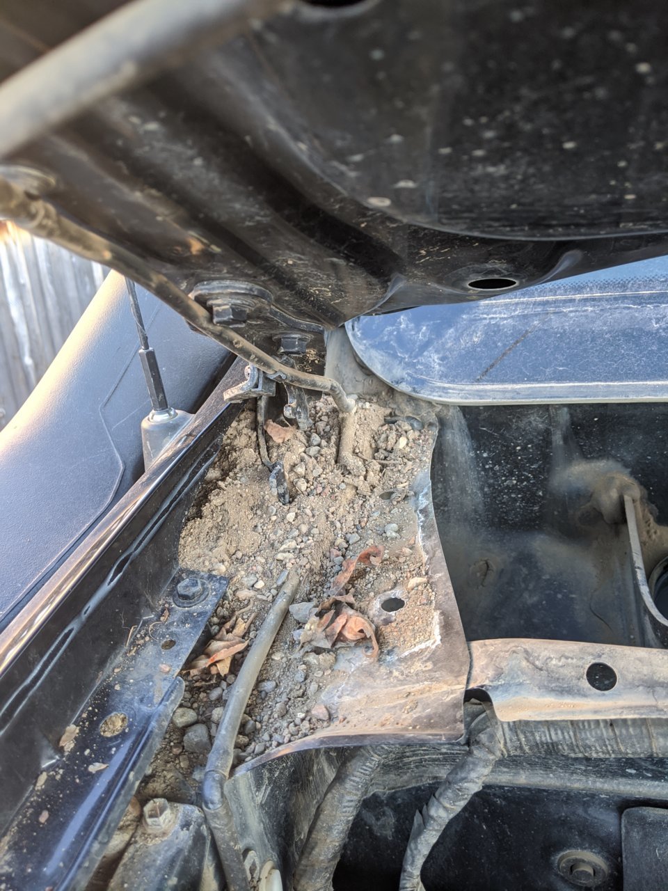

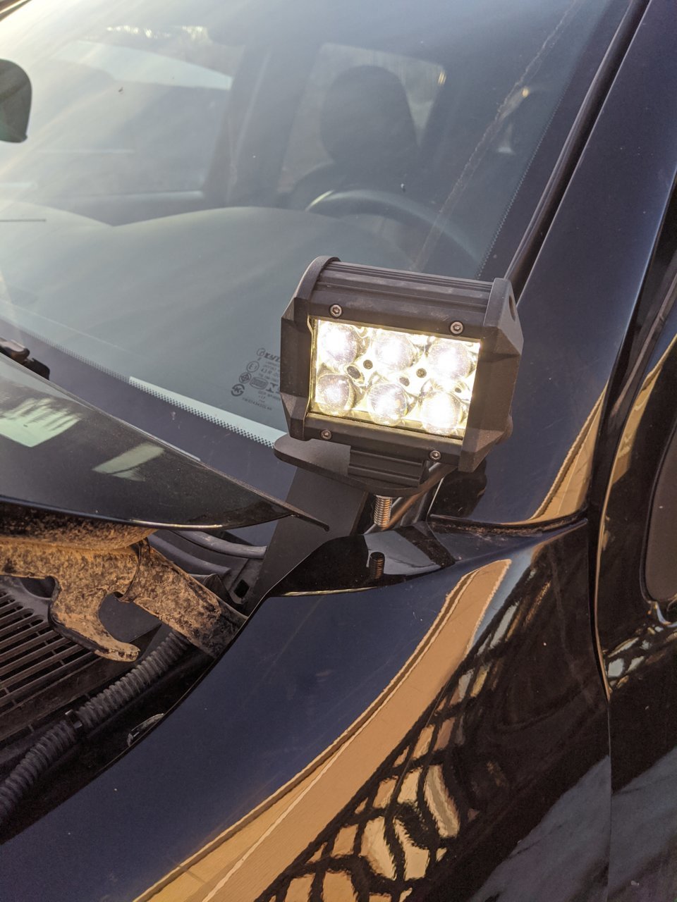

    Well... The weather really sucked for a while which kept me from working on my mod list in the driveway, and then the weather got really nice and the driveway became a sloppy slushy mess I didn't want to lay in.
    Today I found something in the parts pile that I could install standing up! CBI ditch light brackets installed. Only sat in the parts pile for 5 years, and somehow I didn't lose any hardware! Actual lights on the brackets might be for tomorrow.

    Properly functioning ditch lights are complete!
    Cleaning all the mud out to install the brackets was an unexpected delay the other day.
    But in the end it all worked out and went pretty smoothly.

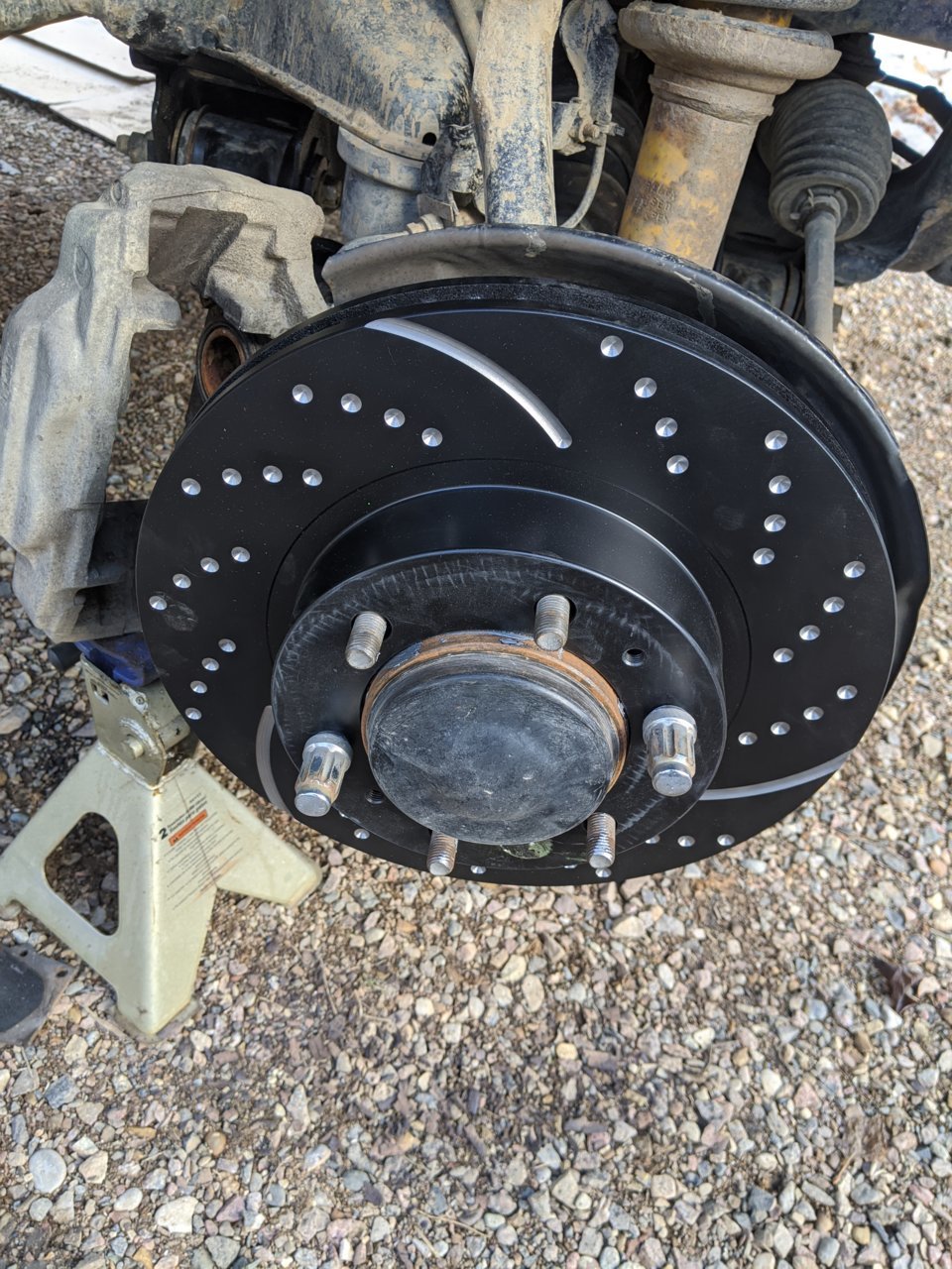

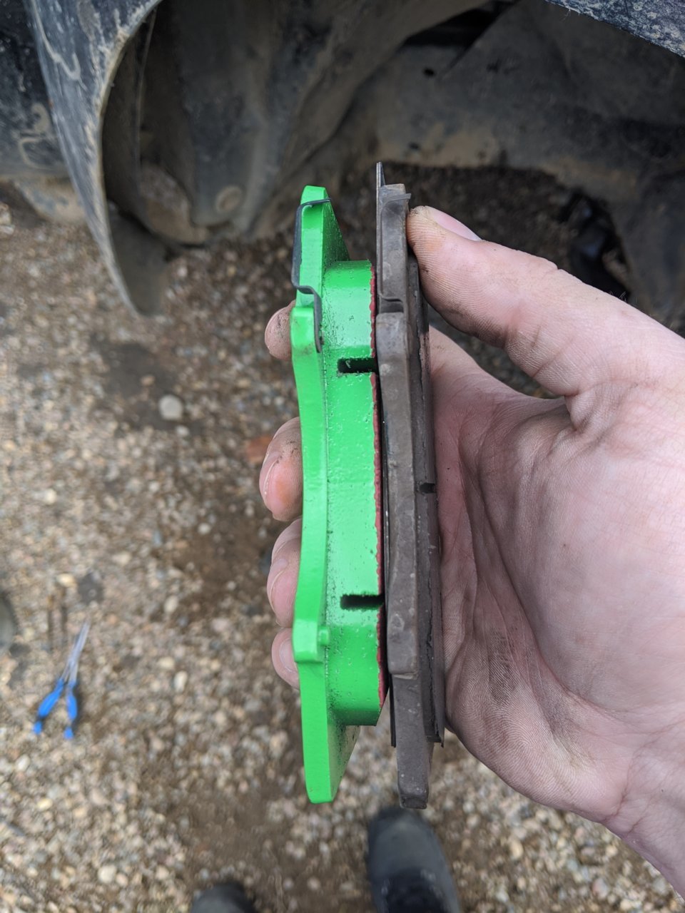

    Put the new brake pads and rotors in today. EBC stage 3 kit. They look pretty.. can't wait to get them broken in and see how they perform. The old rotors were very stuck and took a few big whacks with a hammer to break the rust loose, but otherwise it was all smooth sailing.
    Old vs new pads
    Pretty rotors. Not really sure why they bother with the black paint as I'm fairly sure it'll be worn off soon.. but they look good with zero miles

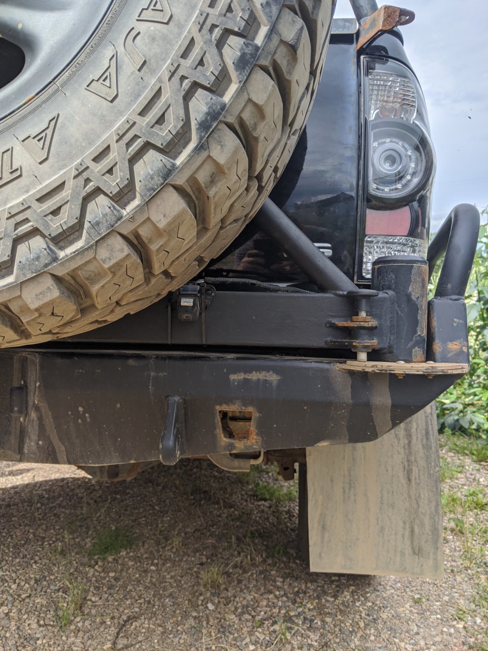

    Been sidetracked with other projects again lately. Some yard work, a couple things with the utility/atv/snowmobile trailer (flipped axle, installed superglides, rewired all lights), and my wife bought a beater atv that I've been getting trail worthy (2006 Honda 350 that has been neglected. Runs well, but no brakes whatsoever, Ball joints are all shot, lights have something funky with the wiring, and one of the hubs is shot. Some other cosmetic/convenience things to fix too that aren't as important. Waiting on the last couple parts in the mail and it'll be good to go).
    But... I finally ordered an AGM battery for the truck that is in the mail. Also replaced headlight bulbs again, got a part to fix my VHF antenna mount, and started relocating the rearview camera.
    For the camera, I only had enough wire length to reach the passenger side of the swing out. It's just zip tied in place while I decide if I'm going to make a bracket to put it there permanently or extend the wire harness and find somewhere more towards the center to mount it (middle of the spare perhaps?)

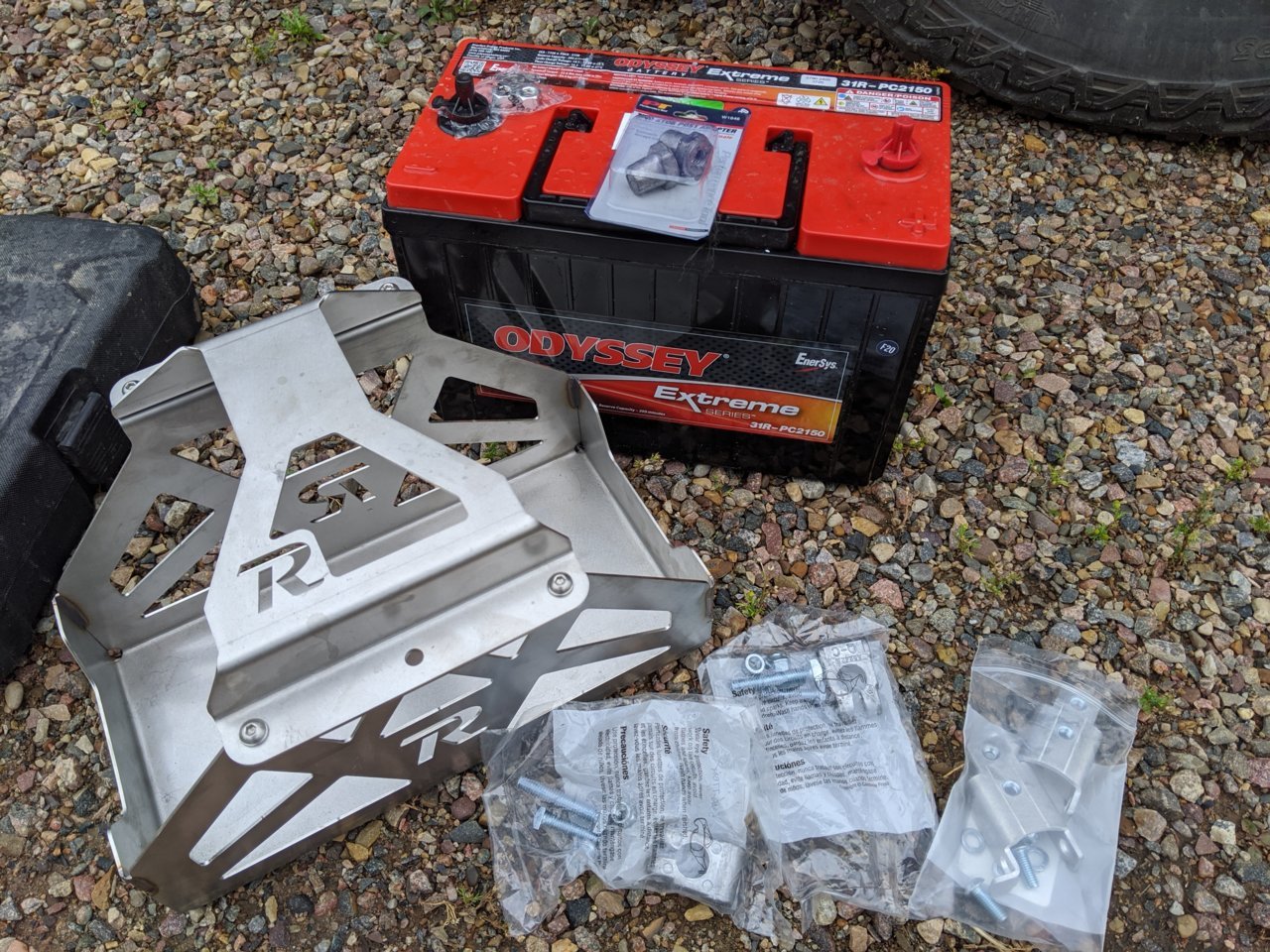

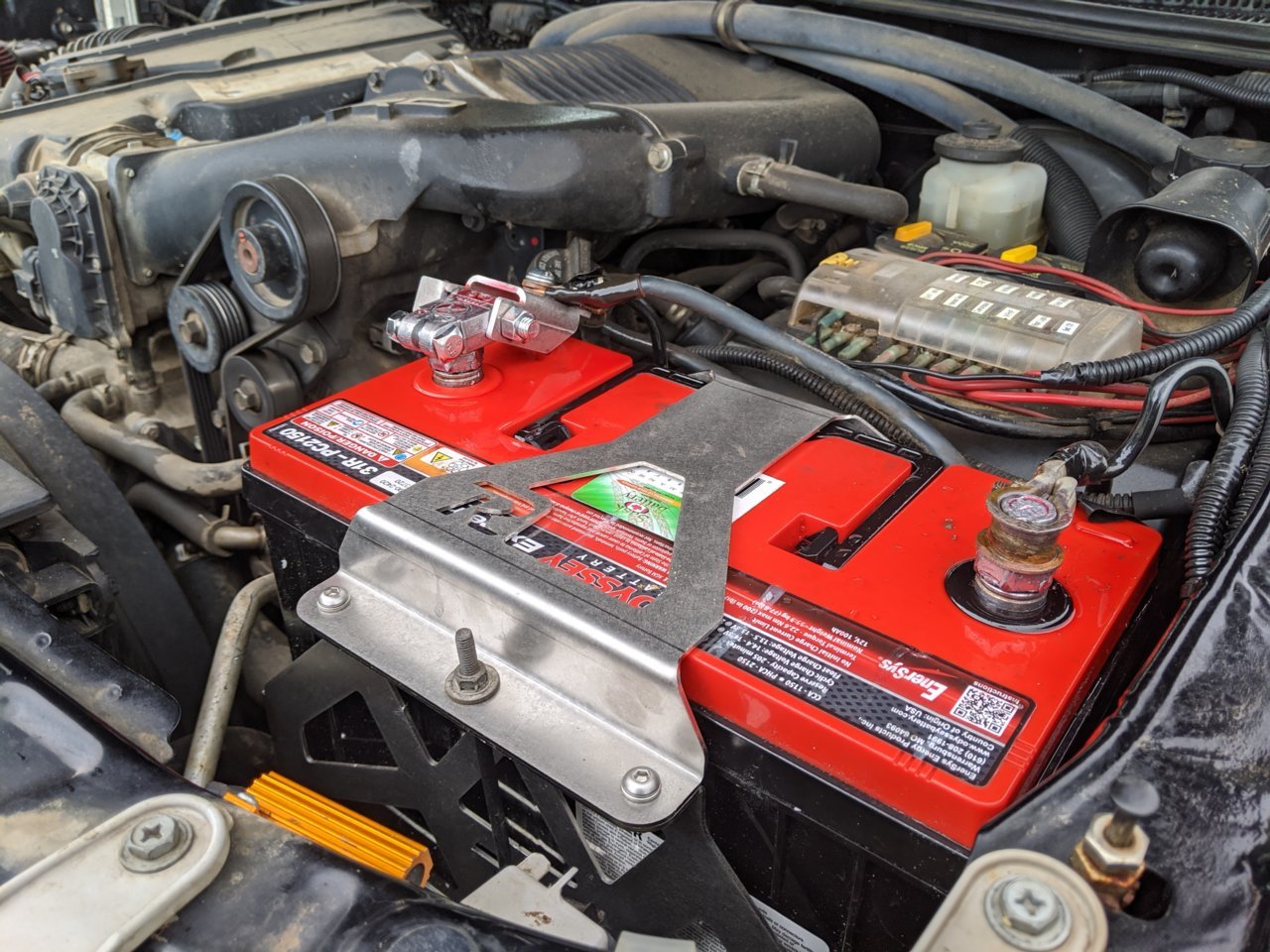

    Installed this stuff. Not pictured is the HKB adjustable voltage booster.
    It was a much longer journey putting this together than I expected. Military battery terminals and extensions from Slee and battery cage from Rago Fab in the US, HKB voltage booster from Australia, battery terminal to post adapters from Amazon, and battery from Saskbattery in Canada.
    I originally ordered a Northstar battery but the retailer said they were still on the website by mistake and asked if they could send me an Odyssey instead. I had to add the terminal to post adapters to make that work and it seems like an excessive amount of connections on connections, but at least the negative reached without having to use the extensions. With the voltage booster at the default setting (+.6V) I was at 14.5V cold and 14.1V warmed up.

    That's a nice looking setup!

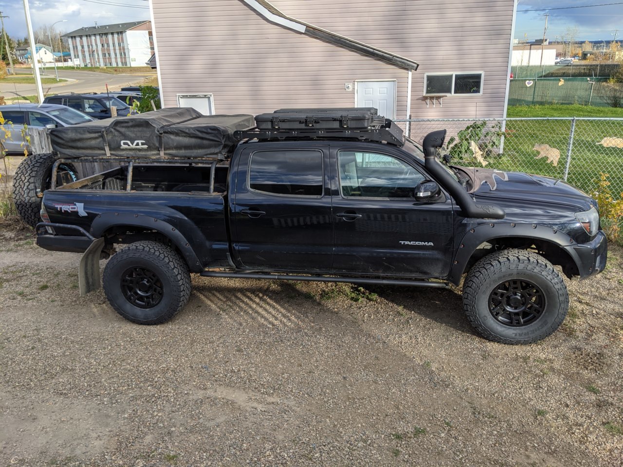

    Got the sliders finished and tires on the truck. I still need to do it's pre-winter paint maintenance and there are some other rusty accessories, but she's looking a lot better.
    The new tires fit well enough for my commute but I'm going to need to do some work. At lock they hit the (already trimmed) cab mount and may rub the (already beaten back a bit) pinch weld/firewall when the suspension is compressed. Full lock the other way they gently rub the UCA. There is extremely little clearance to the spindle too, which will be a problem when I finally get around to welding the spindle gussets on. I'll need to order spacers to get the tires off the UCA and allow clearance for the gussets, then either trim the cab mount more or do a relocation.

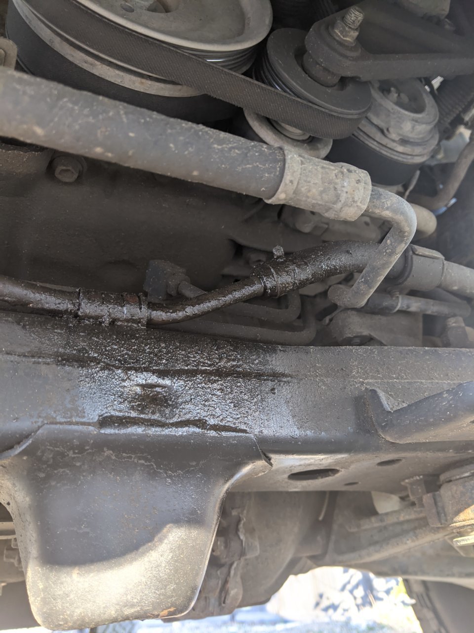

    And... Fix one leak and find another. This connection on the line from the power steering reservoir to the steering rack is leaking a lil bit.
