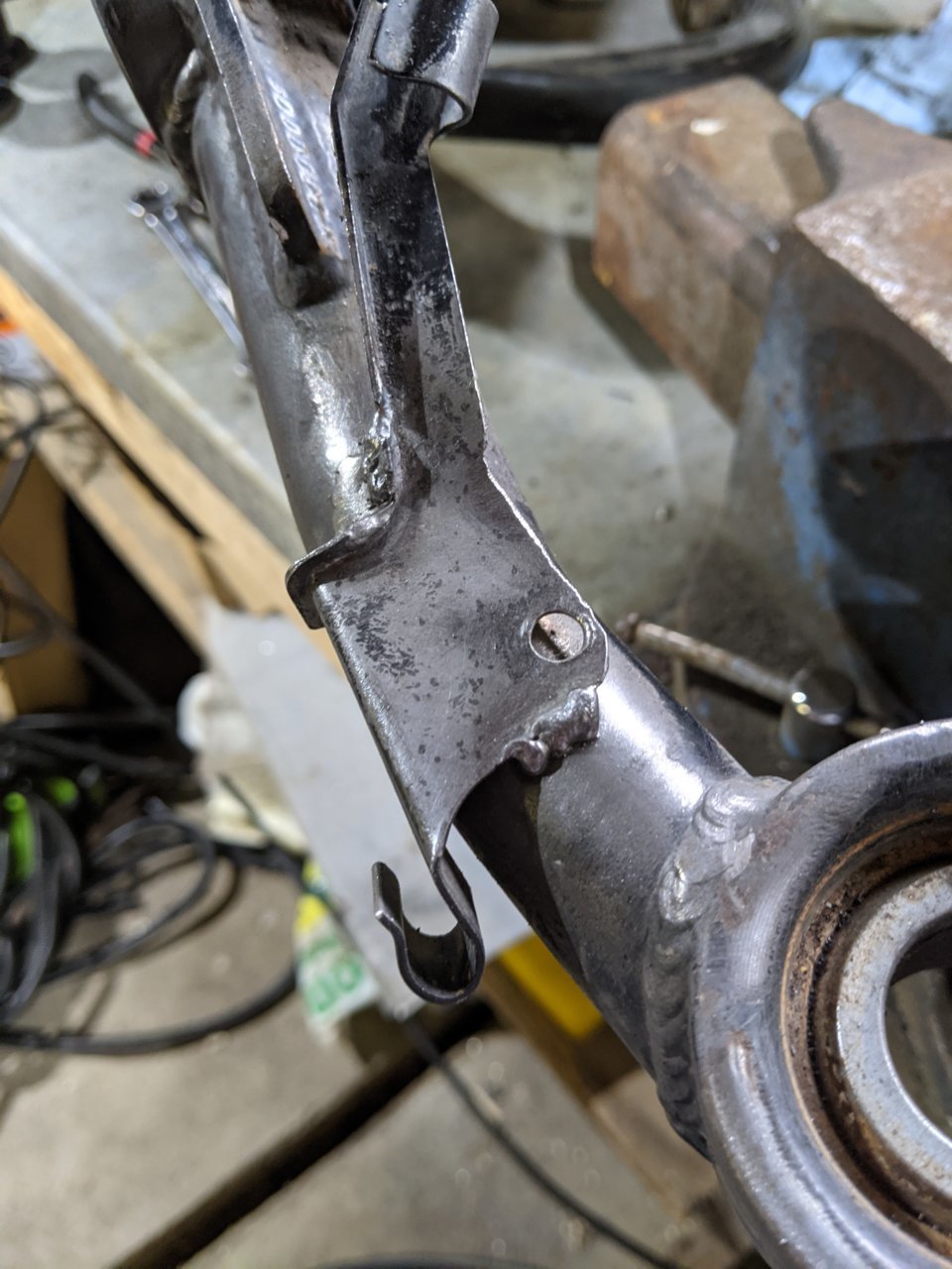

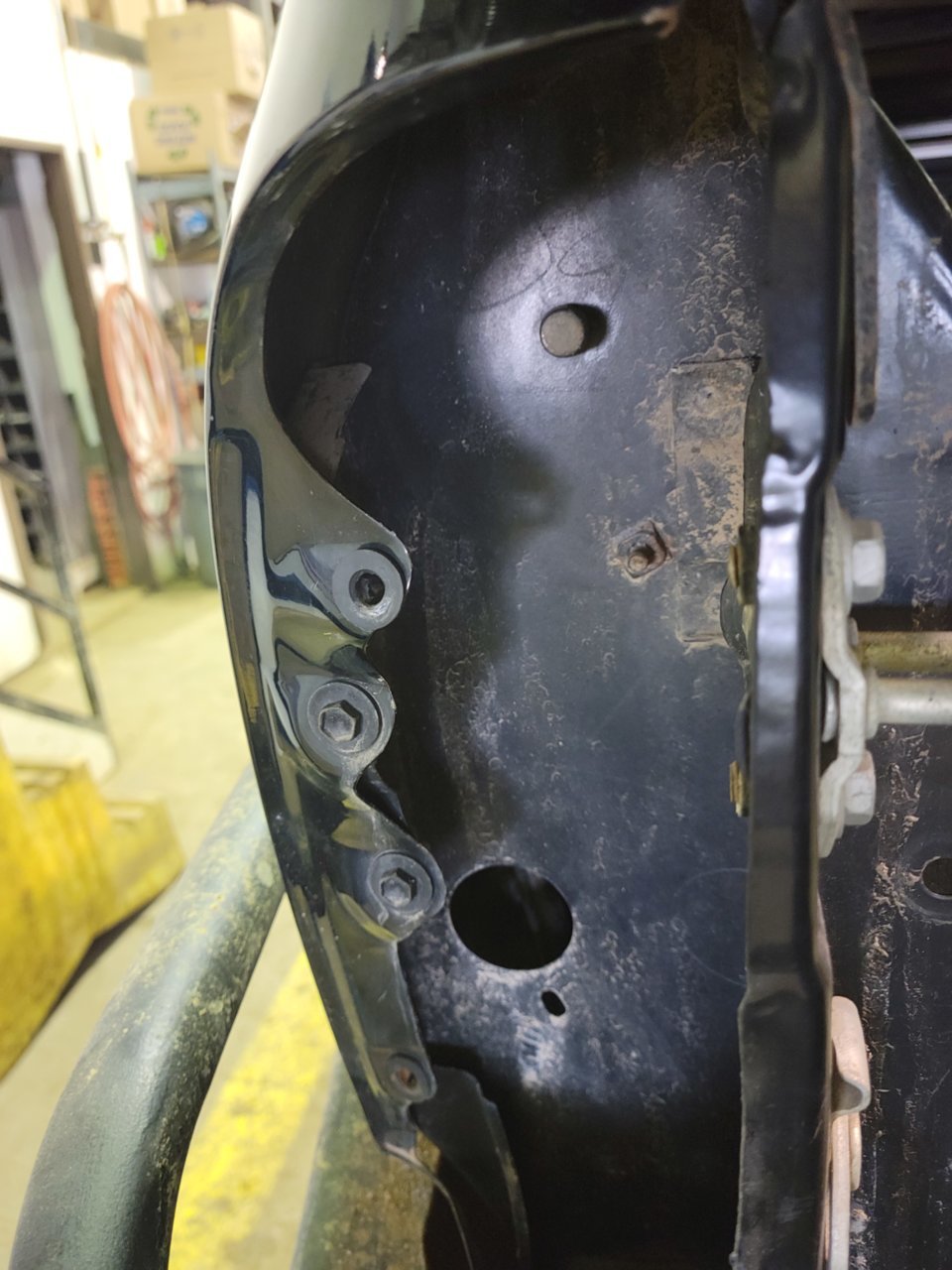

    I also just did something a little unnecessary but I feel good about it! The OEM control arms had a bracket bolted to them to hold the ABS sensor wire. It's always bugged me that the Icon UCA's had the bracket mounting location in the wrong spot and I had to zip tie that wire. Well... I trimmed some extra fat from the lil bracket and welded it to the UCA for proper ABS wire holding. It's in the details...
    Also I'm not very enthusiastic about doing this project so I'm procrastinating by writing about it.

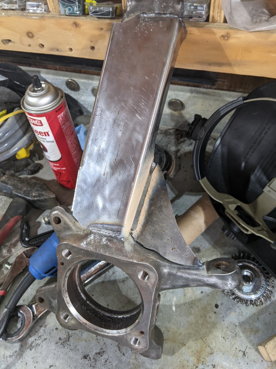

    Went on a vacation for 3 weeks and left the truck on jackstands. But now...
    Cam tab gussets welded in
    Driver CV replaced
    One spindle gusset welded in (one to go)
    Steering rack removed and stock bushings pulled
    Stock LCA bushings removed
    Passenger lower ball joint removed
    Just need to weld in the other spindle gusset, prep everything for paint and paint it, then put it back together.
    Progress pic during spindle gusseting

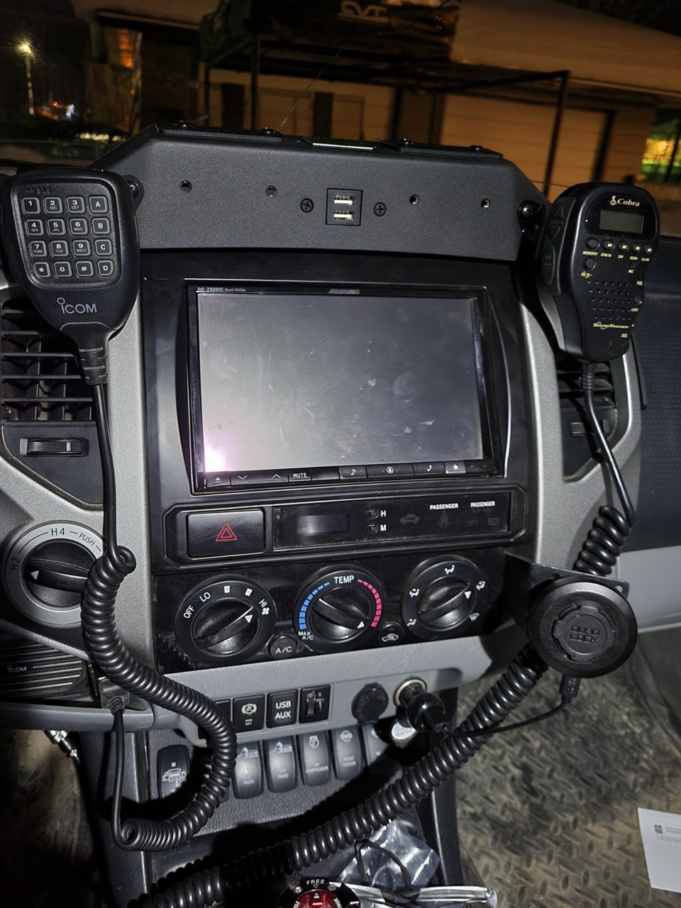

    I've done a little tinkering lately. I re-wrapped my center console switch panel in fresh clazzio vinyl because it was looking a little ratty. Also installed this dash accessory mount called 2TPAM. Lastly I pulled the air compressor I had mounted behind the rear seats and put some Dynamat on the rear cab wall. The Dynamat made a huge difference. I am planning on moving the compressor under the hood now that I don't have rear seats to hide it behind in the cab, but I haven't gotten around to wiring it up yet.

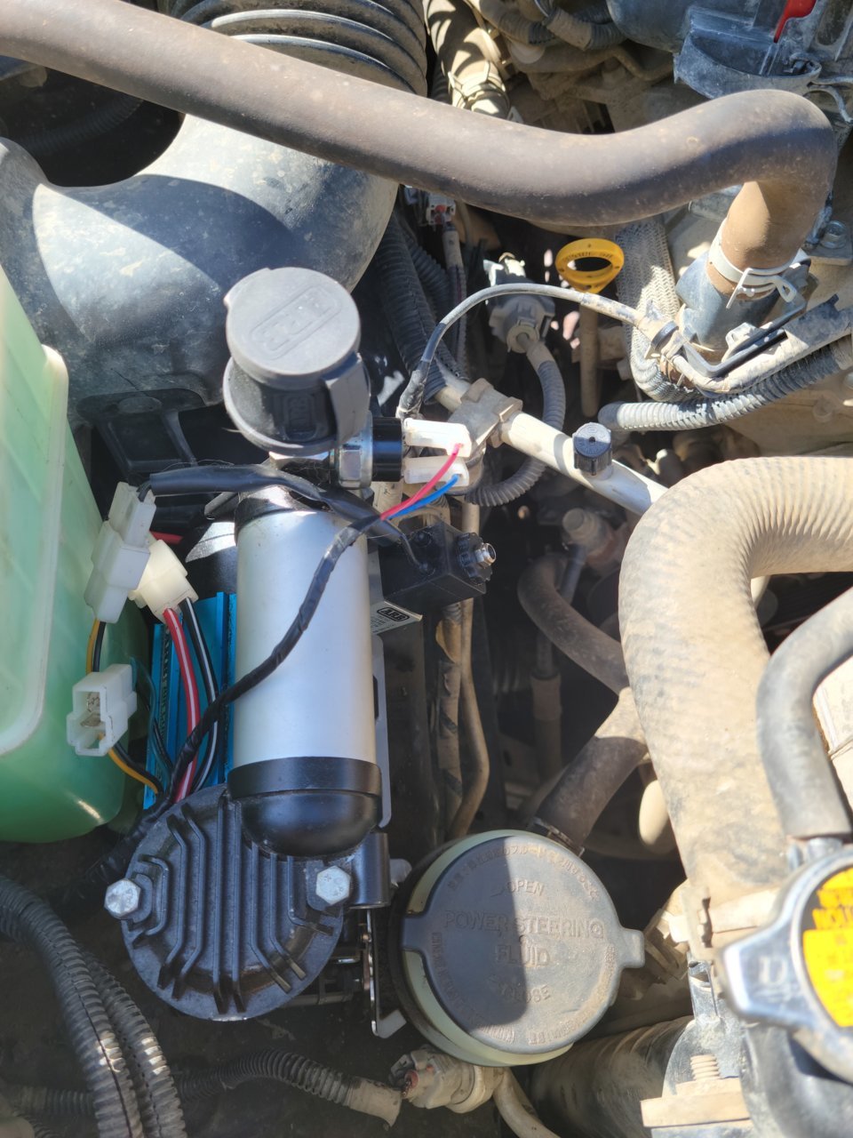

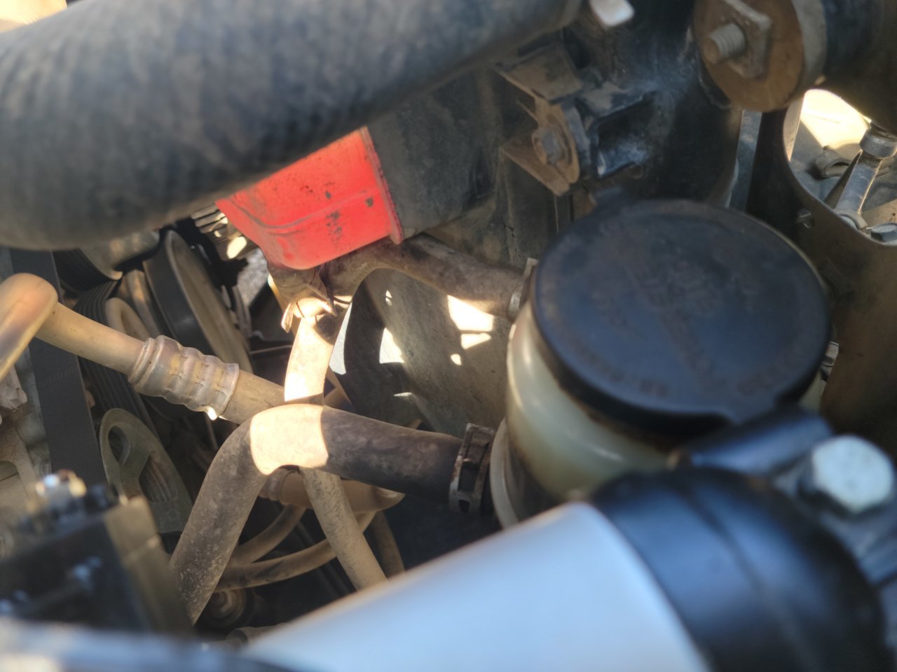

    I haven't had an air compressor for a little while. Removed it when I did the seat delete but never got around to installing it under the hood... until now. I still need to actually wire it up and get a longer air line for rear locker (the 12' stainless braided one I was using doesn't reach), but it's a start.
    New compressor location:

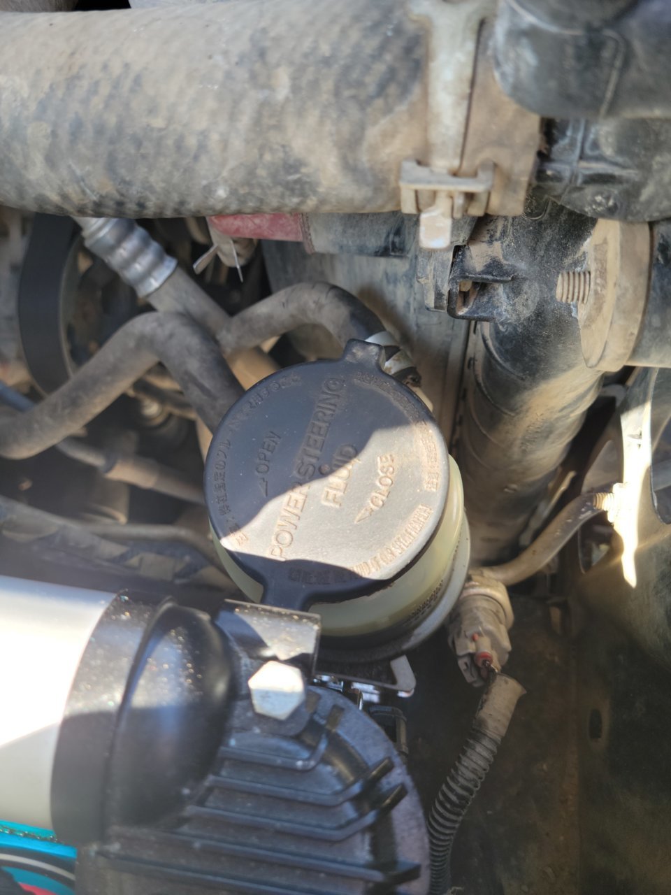

    I used the slee bracket that relocates the power steering reservoir to make room for the ARB compressor. Fit was meh. Mounting holes didn't line up super well, but made it work. The hoses from PS reservoir were rubbing on all sorts of things, so I cut a bit off the end of one and rotated it a bit. No longer touches anything.
    After bracket installed:
    After hose trimming:

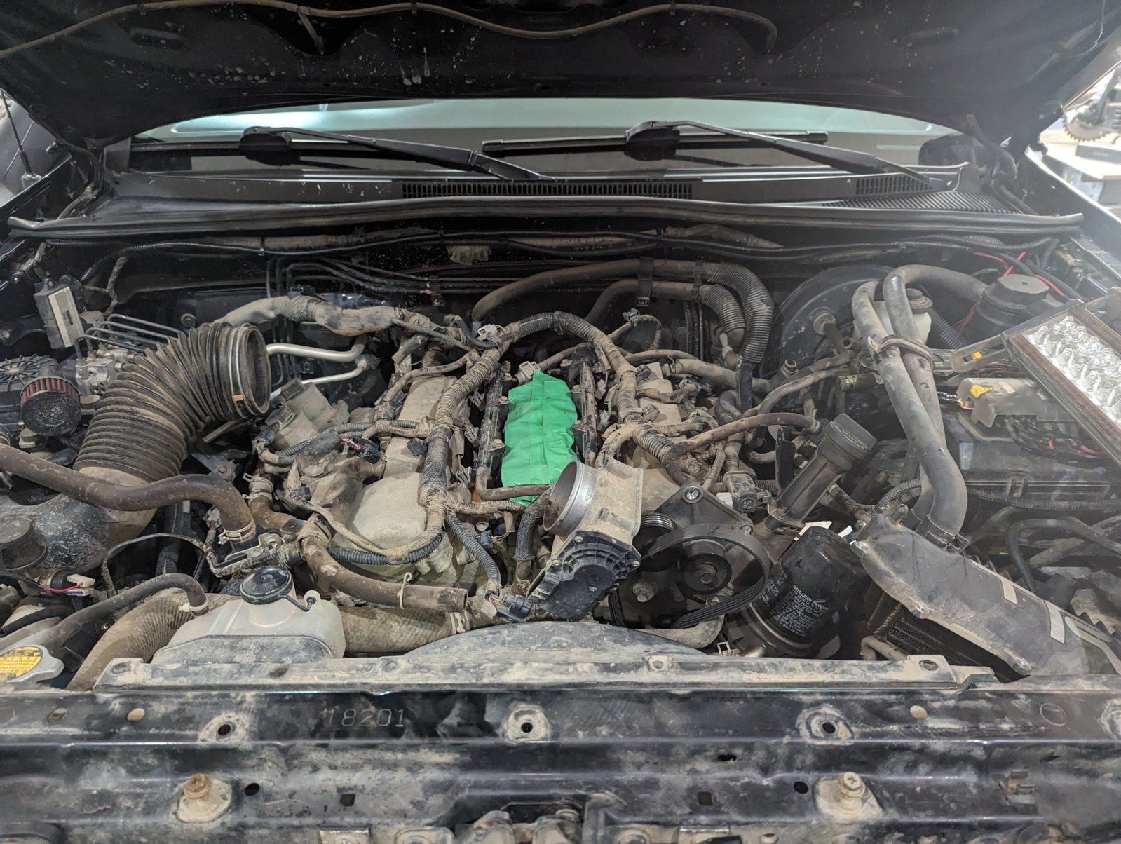

    Also, I have noticed some bearing noise at startup on cold mornings recently. I thought it was an idler, but while I had my head in the hood I listened around and I think it might be the needle bearings in the back of the supercharger. Le sigh.

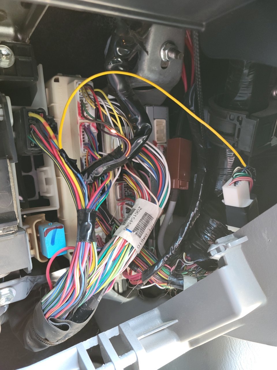

    I found a write up on how to kill the TPMS light. The pictures were no longer available so I had to do a little multimeter testing, but it is damn simple and I can't believe that's all it takes. This mutes the dash light, but doesn't actually turn off the system.
    Just add a wire behind the glove box where I have added the yellow one. It connects the blue wire in the harness on the left (which is a +5V) with the blue wire in the harness on the right (which is the signal to turn off the light). Dash light gone.

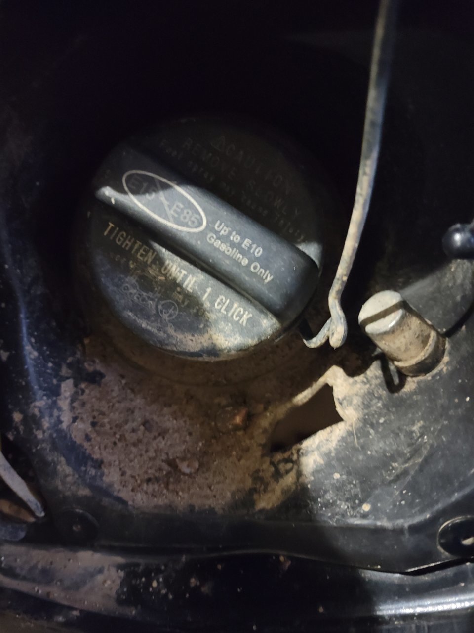

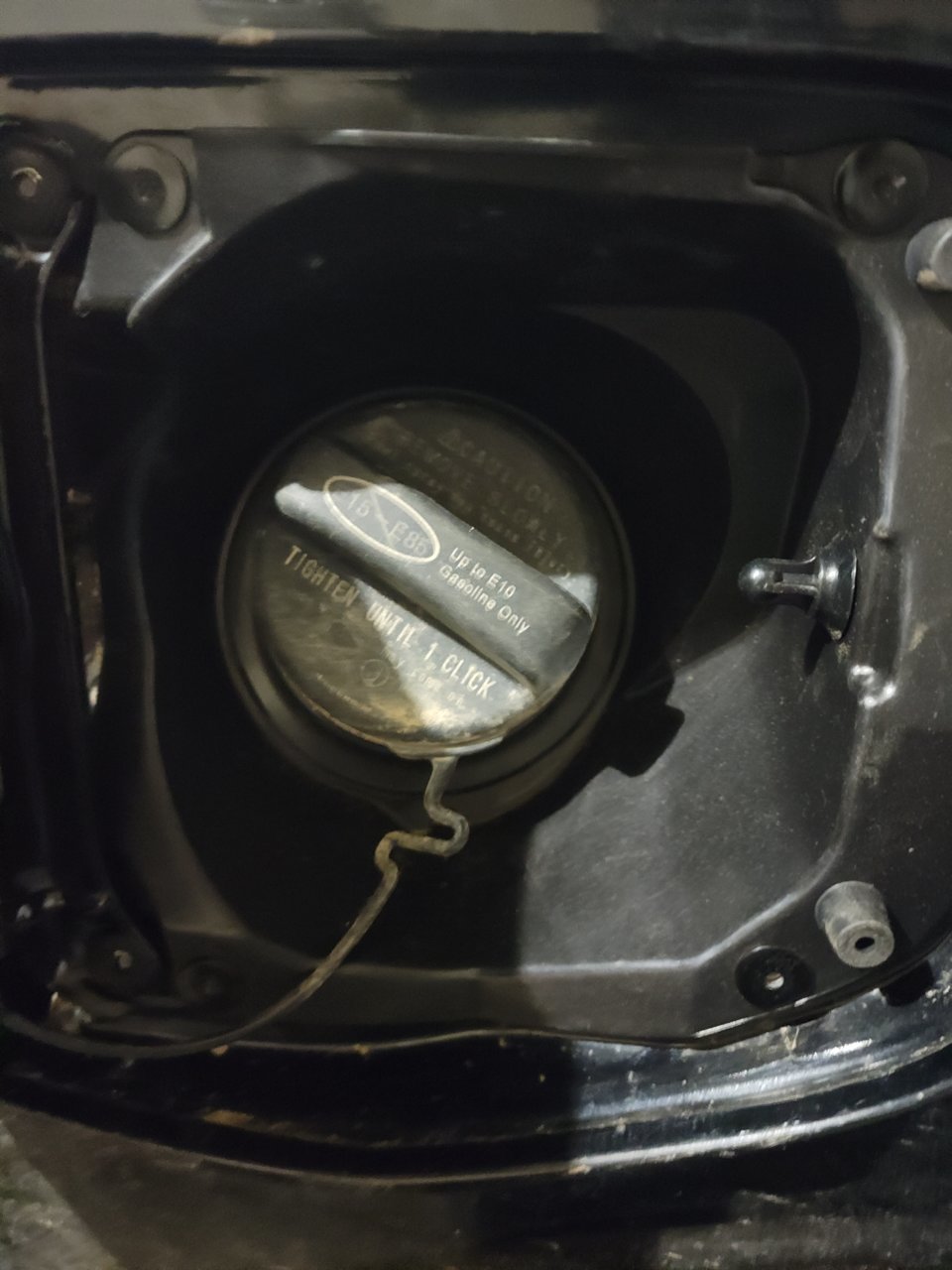

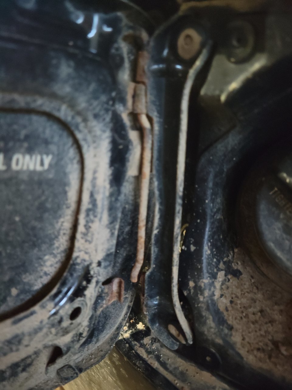

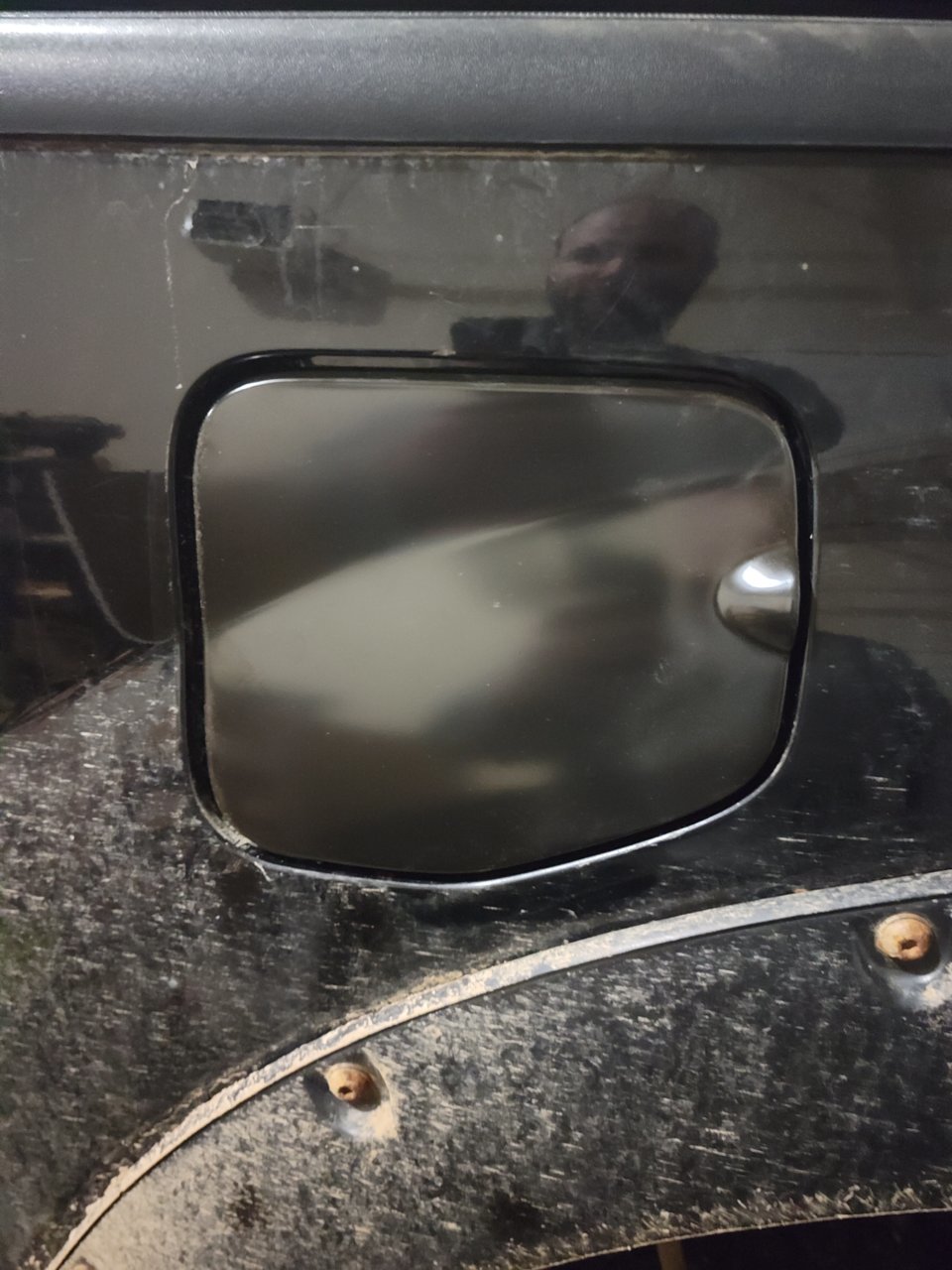

    Finally replaced the old fuel filler door with rusted out hinge. The plastic shroud must have caught a rock at some point; it's had that hole in it for a long time. I also had my diff breather there and moved it to the tail light bulkhead.
    Old:
    New:
    The new fuel filler door is just primer black, but I think I'm going to get some vinyl for that and the fender flares.

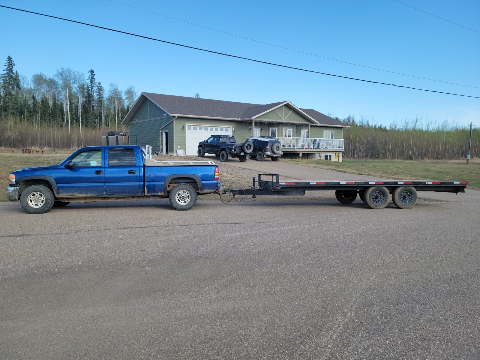

    Couple changes over the last year. First, I bought this old Duramax and trailer to haul my stuff around. Only costs slightly more in fuel to run this down the highway with a loaded trailer compared to a loaded down Tacoma (without a trailer). It needed a little TLC to get it in a condition I was happy with so it consumed a few of my weekends.
    I also did a little maintenance and repair on the Tacoma over the last year. After I decided that I really liked the space and capacity of the heavy duty truck, I decided to pull the supercharger off of my Tacoma and sell it this spring. I was only running the Tacoma around unloaded, really not using the blower at all, and I have been hating the need for premium for years. It's just hard to find at small stations here. Poor fuel economy, small fuel tank, and the need for harder to find premium fuel makes for much less enjoyable trips. So, it went back to stock about 2 weeks ago. Commuting I don't really notice the difference. Hills on the highway are less pleasant, even unloaded.
    Most recently of all, I got another new to me truck. New diesel emissions and the crackdown on deletes do not interest me, so I went gas this time. (The Duramax above is a 2004, before DPF). This 2022 F350 has the gas 7.3L V8, and within a rounding error of the same power to weight ratio as the supercharged Tacoma (with armor etc). It's also very spacious and comfortable. Commuting mpg is about the same as Taco, highway is much better (at least until it starts to see some modding). The 180L tank and running on 87 should make my road trip life much better.
    So now I have too many trucks. Anyone want a 2004.5 GMC Sierra 2500HD with the LLY Duramax? It's an SLT with a surprising amount of creature comforts for the year, 333km on it (just over 200k miles)
