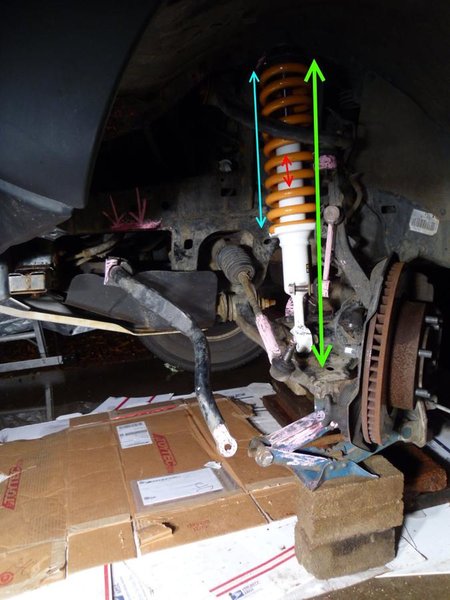

  15. Feb 18, 2014 at 8:36 PM
    teamfast
    teamfast Get busy living, or get busy dying.
    Jul 6, 2010
    #39840
    925
    Winnipeg, Manitoba
    '10 DCLB
    BFG AT TKO2s 34 x 10.5 x17, Leer 550 Tonneau cover, weather tech digi fit liners, Viper 5901 remote start/security, 2" fr spacer, 3" TC AAL, All Pro IFS skid plate, Trans skid plate & Transfer Case skid plate, 12" roof mounted flip down dvd player, In channel vent visors.
    The only thing that is getting forced down further is the lower control arm and everything attached to it. The coilover assembly acts the exact same way as stock. Its just 2" lower. No amount of droop is going to cause damage to it. Now your ball joints on the other hand will have to deal with more angle due to the further droop, as well as cv's. Extending your bump stop yes limits travel but also protects the shock from being busted as this picture shows.

  16. Feb 18, 2014 at 8:41 PM
    #16
    teamfast
    Jul 6, 2010
    #39840
    925
    Winnipeg, Manitoba
    '10 DCLB
    The bump stop need only be shimmed the difference of a before and after measurement from the stop to the LCA. For my 2" spacer I had to shim the stop 1/8". This is due to the fact the stop sits closer to the pivot point of the lower control arm.

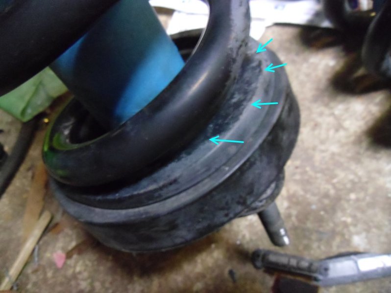

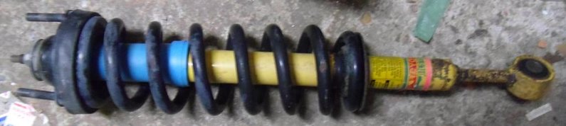

  18. Apr 26, 2014 at 1:50 PM
    #18
    discoy2k
    discoy2k Well-Known Member
    Oct 14, 2012
    #88956
    346
    DISCO
    NOLA
    05 TRDSport 3" Iron Man Coil, Stealth
    2005 to 2012 Front End Replace,2010 TRD Interior,6x Escort Shifters, Escort 9500ix, Escort LIVE w/ 4G Data, 100% Stealth on Interstate,De-Badged Completely,5% Tint Blacked out,Iron Man lift,InfraRed military Humvee Spots, Drive in 0lite,Lexus/Fujisu NAV, dual 8in lcd sun visors, 2 10" kicker solobaric dvc 2ohm, phoenix gold 2000 watt, lunar 100watt @ 1/4 ohm,3 farad cap kicker 250watt,2800watt ,TRU-SINE inverter, dual HID bulb+HID fogs w/ mod, Roof rack,Westin Bull Bar, Manik Side Bars, Sirius/XM (HACKED) Undercover Bed Cover, bosch Wipers, Iridium Plugs, Undercover Bed Cover
    this is an old set that had spacers in it, there was also about 1.5in spacer on top, its a little hard to tell in the pictures but you can see where the coils would collapse and hit each other. i guess raising the bump stops could help with that, but then you lose more travel.
    cheers,
