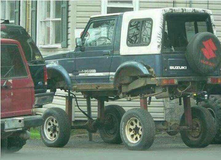

    Yup, crazy short wheelbase. Saved it though! The real question is what is the hissing sound that started right after it came down? Probably jostled the carb adapter plate or something like that. It’ll be this weekends fun project!

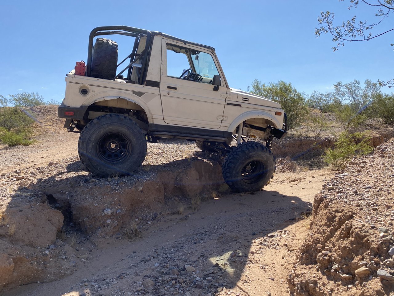

    The Toyota 3k Carb actually has been GREAT for heavy incline and decline. I'm about at the limit of a full body build though so I'm going to start looking into building a tube front clip with room for a Chevy 4.3 and auto trans. People do the swaps in full body Samurais but this thing is QUICKLY turning into a trail only truck.
    Also went ahead and bough a BUILT Toyota front axle. Its set up for links which I am not ready for, so I'm going to gut it and install all the parts on my leaf sprung front housing. Just need to get one of the knuckles to a machine shop to have a broken wiper seal retainer bolt extracted/drilled and tapped.
