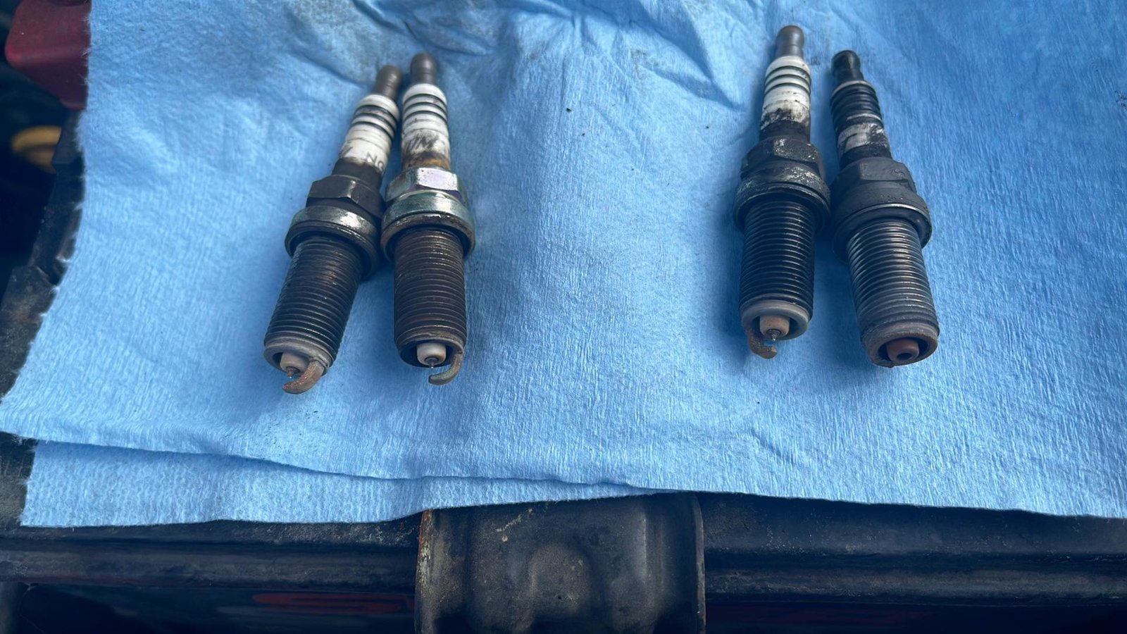

    Original spark plugs:
    Plug 4:
    Second Plug 4. Notice the dings and dents all over, not a crushed ground strap, I don't think it's from contact with the piston:

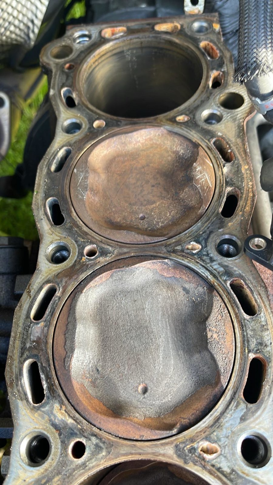

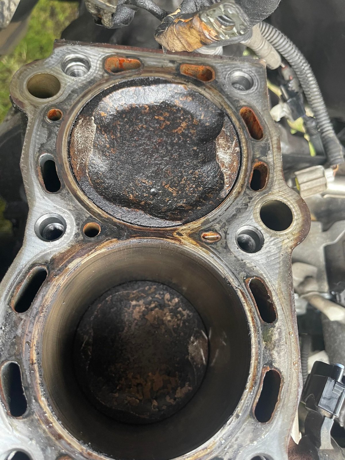

    Pistons 2 (carbon but no dings) and 3 (no carbon and dinged up):
    Pistons 3 and 4, both dinged up.

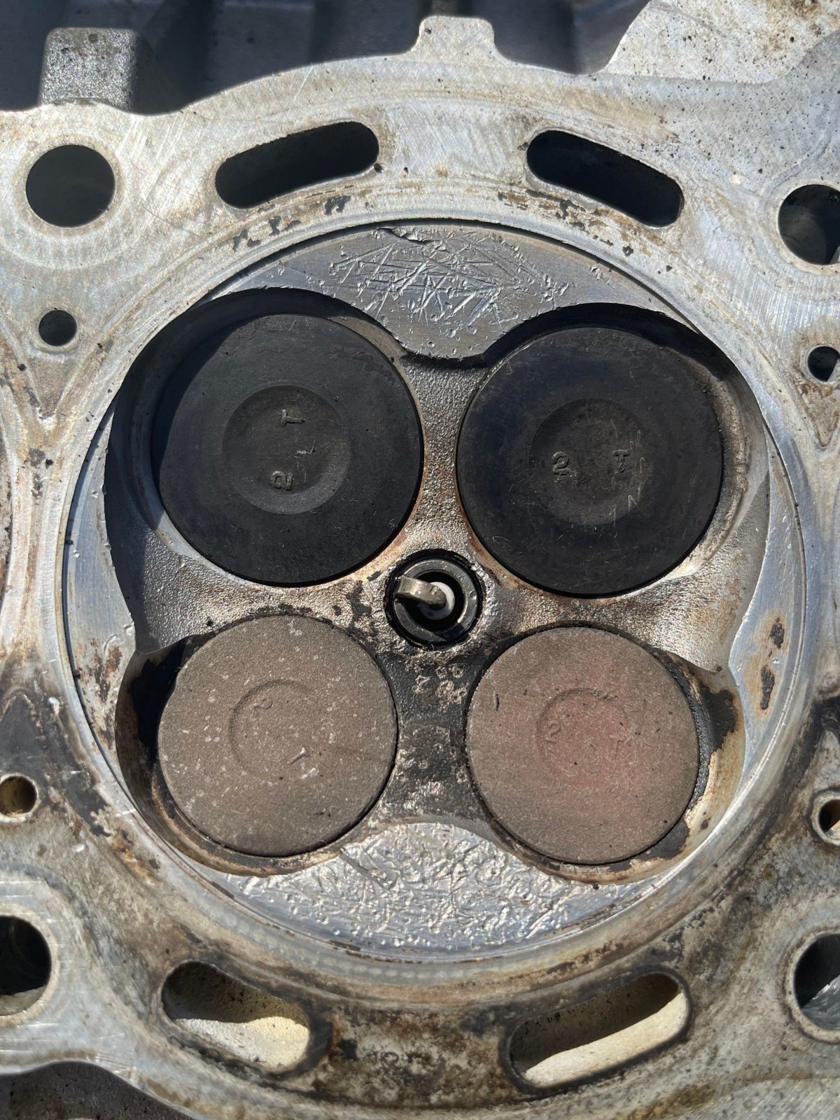

    Head of Cylinder 3:
    Head of Cylinder 4:

    I've decided I'm pulling the head again. If this little piece bounced around and hid from me last time, but is stuck in the head or piston now, I'll have to pull the head again anyway.

    bad rod bearings, excessive play, piston to spark plug contact.
    A single piece of metal isnt going to bounce around between difference cylinders.

    Rod bearing would put forbidden glitter in my oil, and when the piston was on the downstroke it wouldn’t be rock solid when I tap on it with a hammer handle. Also, all of the piston vs. spark plug fights I’ve seen have had much more trauma to the spark plug. Other than missing the electrode itself and the grounding arm, it was pristine, not a single chip in the ceramic.

    Any chance the plugs are Amazon counterfeits?
    It certainly looks like something got in there. My guess is a nail or nails. Look at the top of the picture titled head of cylinder 3. Look very closely, kinda looks like the imprint of a nail.

    I thought that might have been the electrode from the electrode itself, which seems to have just fallen out of the center of the plug.

    Based on the impact marks whatever is (was) in there is pretty decent sized. Cant imagine it can hide too many places.
