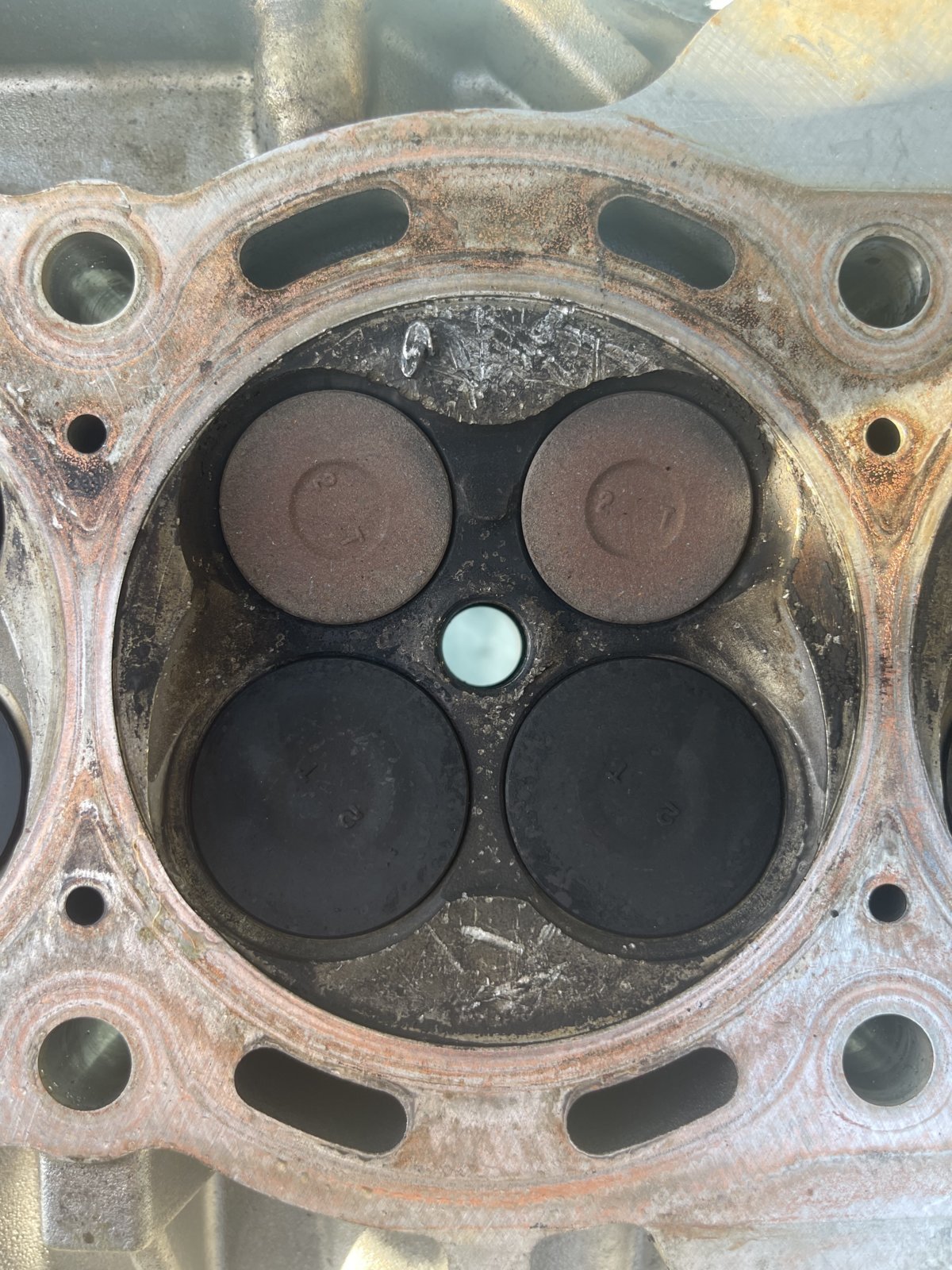

    I just don't think the spark plugs are that close to the piston. The valves would be touching before the piston came close to the plug

    Right. Unless you had massively long spark plugs for some reason and then the issue would be in all cylinders. Instead, we are looking at two cylinders with marks from something bouncing around inside, one spark plug that has been damaged, and another that is actually missing its electrode. Impressively confusing

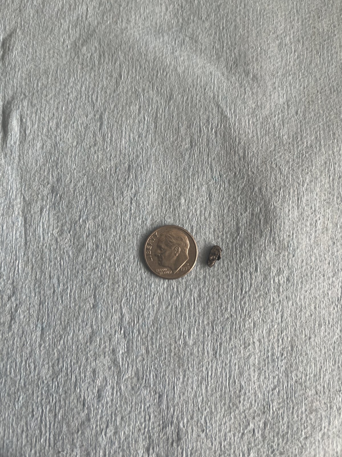

    It looks like One spark plug that is missing the ground strap and electrode.

    It was the spark plug of cylinder 4 missing the strap and electrode. When I bore scoped and found nothing the first time, I put new plugs in and the one in cylinder 4 was damaged again.

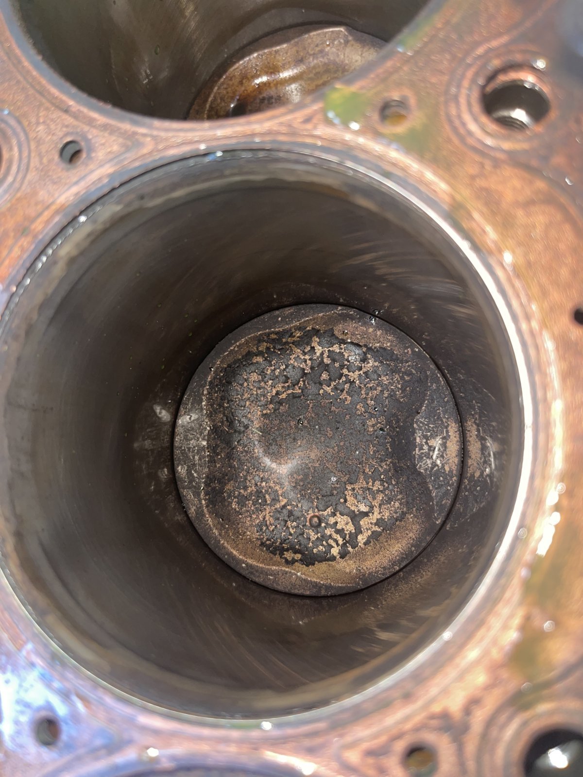

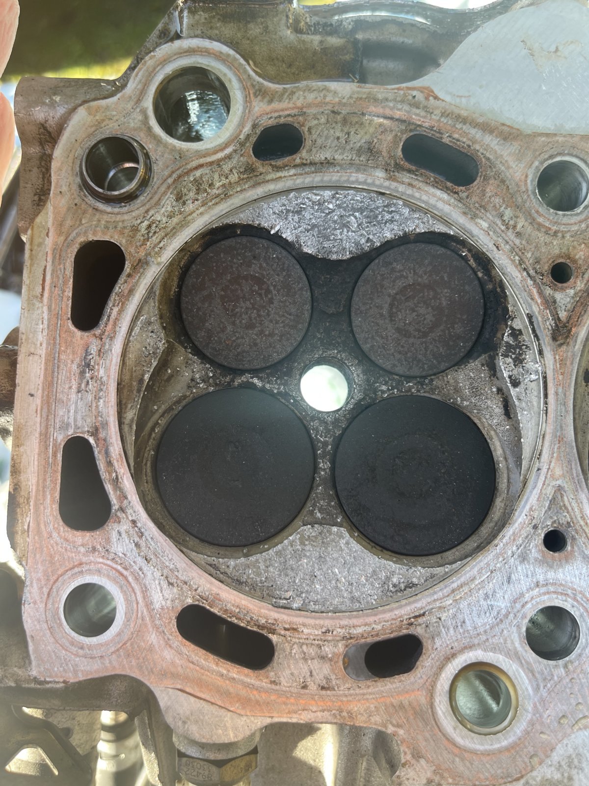

    I passed judgement on my truck yesterday, and carried out the sentence today: OFF WITH IT’S HEAD.
    Cylinder 4:
    more beat up than before.
    Cylinder 3:
    about the same as before.
    Cylinder 1:
    Wait, that was clean before, no marks at all..
    What? I skipped Cylinder 2!?
    Yeah. Notice the matching mark on piston 2:
    left side.
    I’m 100% sure that was not present on the head or pistons last time I put it back together.
    It also went through all 4 cylinders this time.. at least 1, 2, and 4. Piston 4 looks like it’s been sandblasted now.
    Hopefully, in a week or two when I can put it back together .. it should be done with this crap.
    I’m done for the night, I’ll scope the cat and see if the electrode is in there. Pretty sure this guy is the strap.
    Is there an emoji for pulling one’s hair out?

    Looks like moderate to severe detonation to me. If it had progressed to pre-ignition, there would be far more extensive damage. Most common cause is ignition too advanced for conditions. Excessive heat with a failure of the knock sensors could also do it.
    this causes chunks to break off the piston crown and then bounced around causing what you see on the heads.

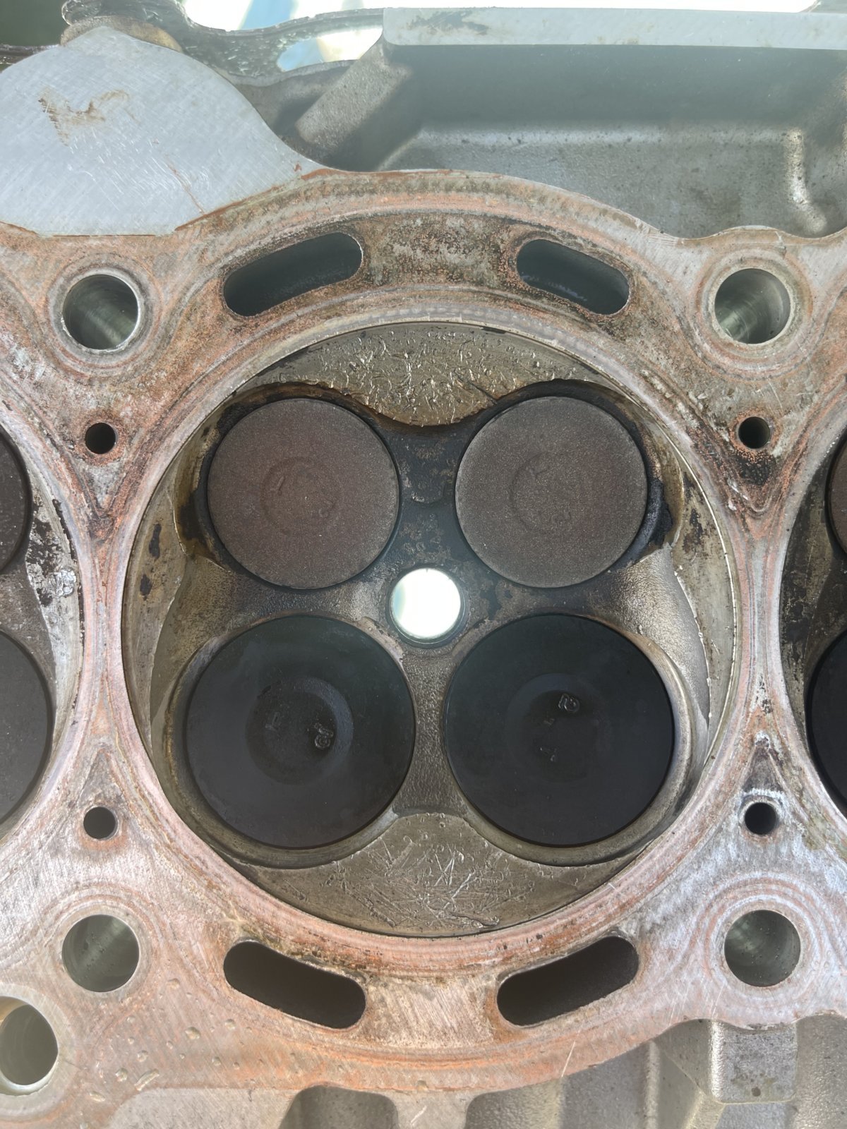

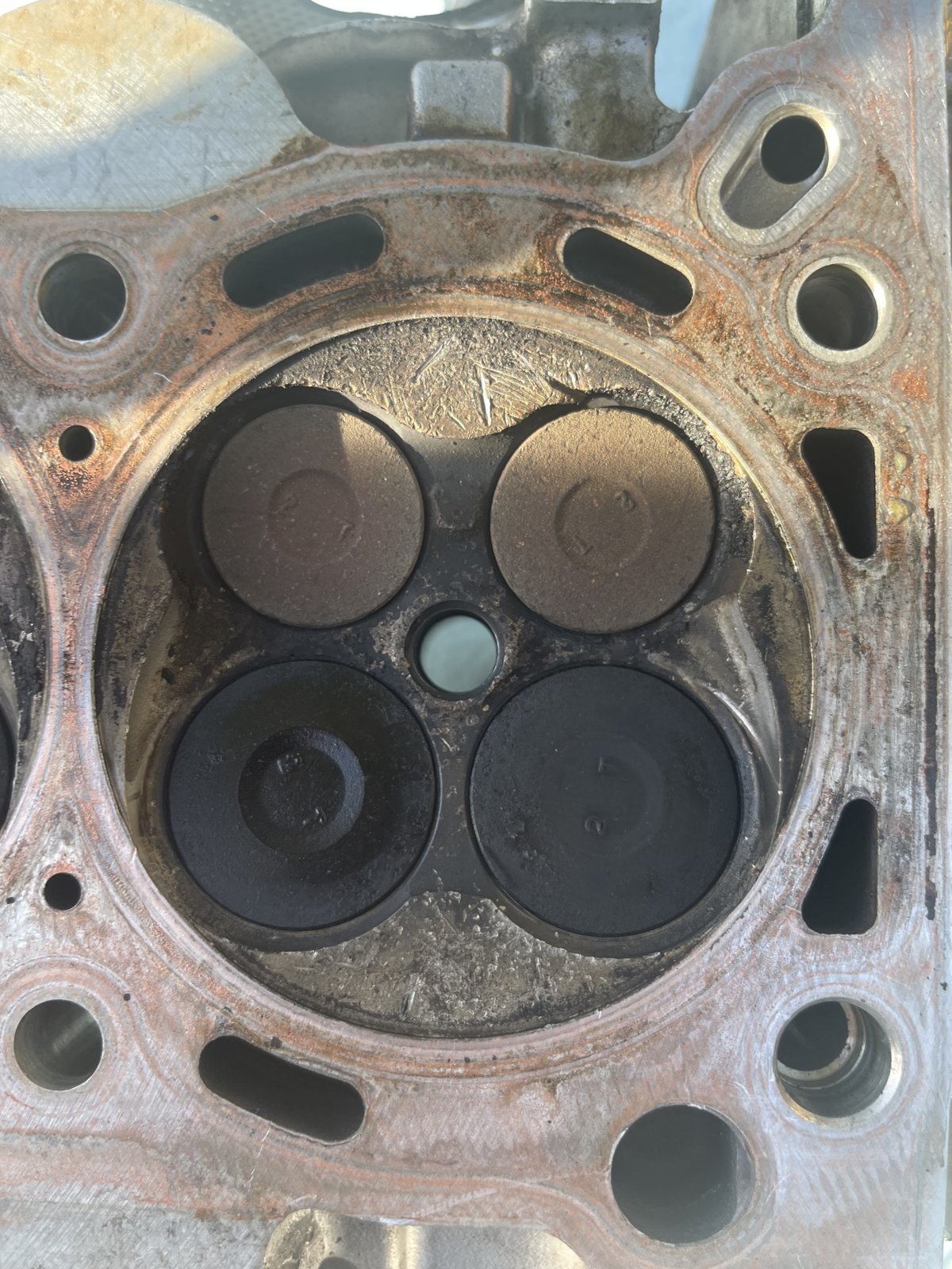

    Well.. I put it back together. Again.
    I'm still getting a misfire, although in cylinder 1 this time. Some intermittent rattle too.
    I'm going to pull apart another of the NGK spark plugs to see what the electrode looks like. I found some pieces in the catalytic converter when I used the bore scope before putting this back together the 2nd time, I had assumed the electrode was there. I'm tired of throwing in $12 spark plugs, so when I put it back together I used the same ones I had used last time. After getting the misfire, I pulled the #1 plug again and it had some small impact marks .. so I'm not sure if something is still in the cylinder or not, although I'm not sure where it would be from or what it would be, the head was clean, all of the ports were clean, and there was nothing in the intake when I put it back together.
    I know what I have to do. Going to go buy more spark plugs (again...) to see if there's any material in the cylinder somehow, and play musical chairs with the injectors and coils, to see if the misfire follows any one component.
    I'm on a shoestring budget at this point, so telling me to go replace all four coils and injectors isn't going to help :)
    .. Am I the only one that wishes the air box didn't go over the top of the valve cover so one could access the plugs easier? Although I must admit, I'm getting to be quite good at pulling that part (not sure of the actual name for it) off and putting it back on.

    Hard to tell with all the gouges of debris now in the cylinders, but the pictures look like detonation to me. Everything looks sandblasted.
    Excess heat and cylinder pressure breaking plugs.
