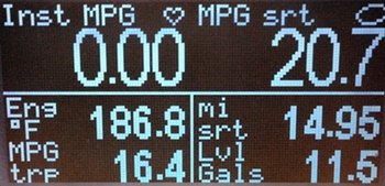

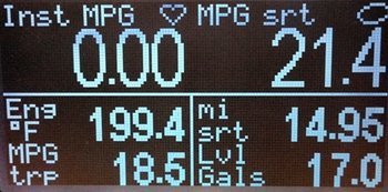

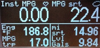

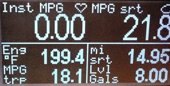

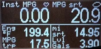

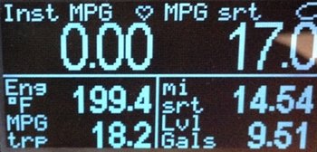

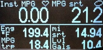

    I've read about the jiggle valve phenomenon for a while. I am a skeptic by nature, but there were WAY too many guys reporting a pretty big temperature difference to write it off.
    So, I did what in my opinion was a pretty controlled experiment. My commute to work is very consistent, so I recorded the engine temperature when I pulled into a parking spot at work several times by taking a picture of my Ultragauge as soon as I pulled the parking brake.
    Last Saturday, I pulled the thermostat and noticed it was at 2 o'clock. I assume that the tech that did the timing belt at 90K reinstalled it in a random position. I put on a new gasket, reinstalled the same exact thermostat (not a replacement) with the jiggle valve at 6 o'clock, put the same coolant that I drained out back in and made no other changes.
    Here are the Ultragauge images from several trips to work before the change, one trip home, and one trip to work after the change.
    Trip to work #1, jiggle valve at 2 o'clock:
    Trip home, jiggle valve at 2 o'clock:
    Trip to work #2, jiggle valve at 2 o'clock:
    Trip to work #3, jiggle valve at 2 o'clock:
    Trip to work #4, jiggle valve at 2 o'clock:
    OK, so are you convinced that my truck runs at 199.4°F yet? I hope so. :)
    Trip to work this morning, jiggle valve at 6 o'clock:
    Second trip to work, jiggle valve at 6 o'clock:

    If you don't have a scan gauge, how do you tell your engine temp? My temp gauge stays in the middle once it's up to operating temp and has never gone over that position. So am I good?
  20. Jul 25, 2016 at 10:17 AM
    #40
    Gooch
    Gooch Well-Known Member
    May 8, 2009
    #16962
    775
    Orange County CA
    2000 Tacoma SR5 V6 4x4
    The analog gauge doesn't provide enough resolution to be able to see a 10-15 degree difference. You would have to borrow a Scangauge, Ultragauge or maybe a scan tool.
    There's no danger in running at 200. Some guys would rather run cooler for several reasons though. Some people just want to have the thermostat installed the way the FSM tells you to.
    For me, I'm mostly interested in seeing if running 12 degrees cooler will cure my pinging problem.
