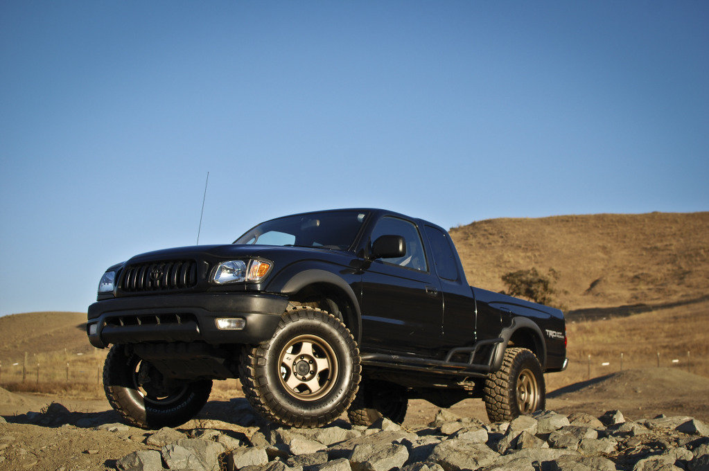

    Moe, have you checked out our F5 model? It's somewhat similar to what you posted above, but our wheels are alloy and they only come in 16x8. They're lighter, stronger and are hubcentric.
    We have them available with either 4.5" bs or 3.5" bs.
    3.5" bs Deep Dish
    4.5" bs
