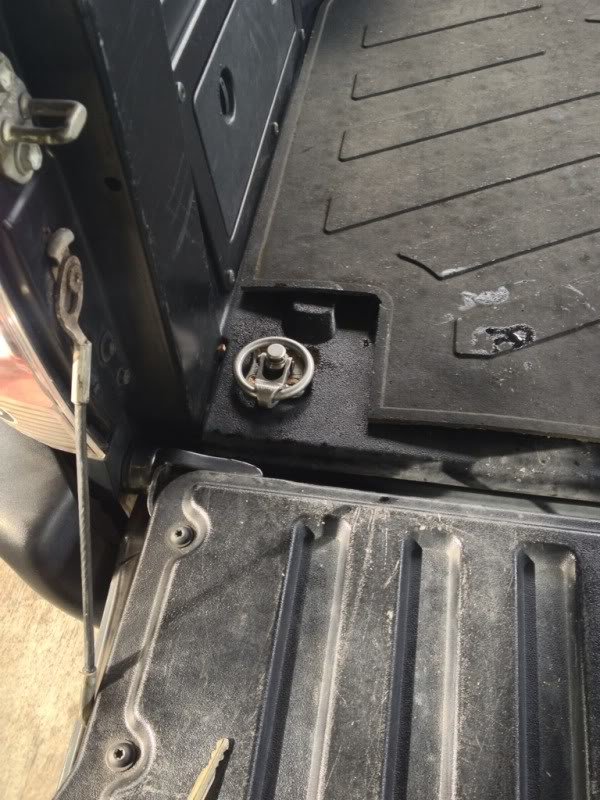

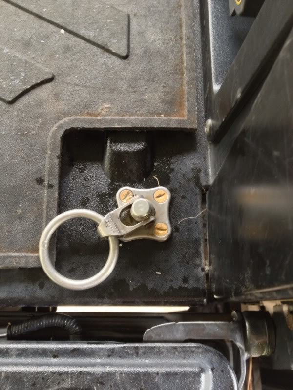

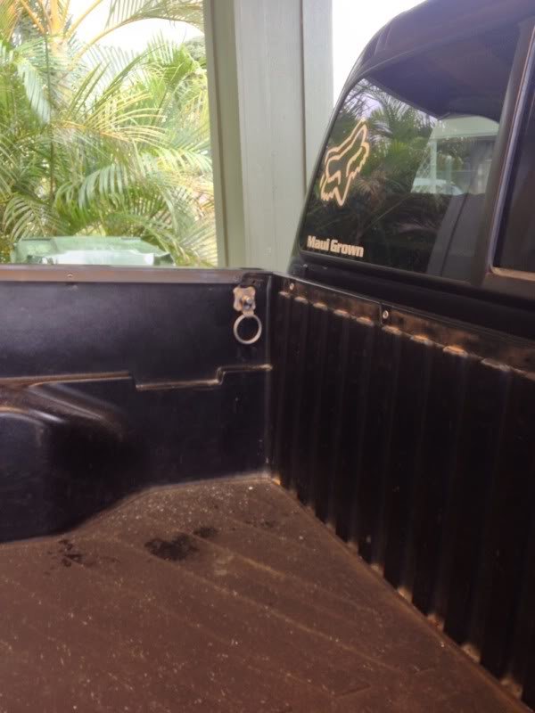

    So I yanked the bullshit bed rails and rear tiedowns. Put these in and made a plate to distribute the load. Who can tell me what they are from??

    looks like something from an aircraft

    They are just mounted into the bed material ?

    figured you would say something about the type of screw head

    i really hope those are not brass screws holding those down. they look kinda wimpy to me

    look like hoodpins kinda

    Those looks like they would give out before a factory D ring would...
    Just buy a T55 torx bit, and 2 more d rings and there ya go.

    Definitely don't look as strong but an A for effort and thinking outside the box :)

    Those look really crappy..
    The stock bed rails are rated at 600 lbs. Any more than that and your things would just rip out the bed material..
    I love the bed rails.. I think you yanked one of the better features of the truck out to put in out dated stuff that won't hold anything... I don't feel sorry for you, but I do for whoever you sell your truck to..

    They look like hangers that go in a firetruck's storage box. I bet they would work well on bed rail for light loads .

    Please put the bed rails back where they belong!

    x2 why not just add a set on the front that uses the existing bed bolts instead of removing the bed rails? They can be handy sometimes, but you shouldn't be securing heavy items to the bed rails anyway.

    Rated at 600 lbs?? Yeah they flex like hell. And take off the plastic cover sometime. See how distorted the metal is.
    No they aren't brass screws lol those are close tolerance hi shear screws. 95,000"lbs shear strength.
    I am putting the plastic top cover back on.
