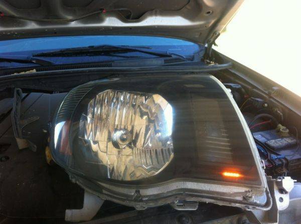

    Well a couple weeks ago I was looking at my truck at night (parking lights were on) and it bugged me that it only had ONE amber light and it was off to the corner in a weird spot. Not a problem for newer Tacos that have the DTRL's and yes I could have done the DTRL mod but....I didn't want to;)
    I looked at my headlights any chance I had ti figure something out and noticed the spaces above and below the signal light and began to search for a light small enough to fit there.
    I came across superbrightleds.com and started browsing. There were a couple options but I went with this one
    The height was perfect although I wish it came in a longer size (thought about wiring two in there but decide one on each side would do.)
    Did the routine BHLM steps. Drilled a hole on in the bezel and headlight housing to run the power wires for the LEDs then sealed the holes with silicon. Sorry, no pics of these steps as I didn't think it was going to work.
    Quick test of the lights
    Spliced into the corner markers
    YES marvel at my glorious tape job:p
    I also put quick disconnects to allow headlight removal if needed.
    Bolt the headlights back up and plug the light in and voila!
    And of course I gotta Instagramize it:rolleyes:
    All in all it wasn't that hard to figure it out. I know it's not an extravagant mod but it's different and I ended up liking it a ton!
    Difficulty rating: 4/10
