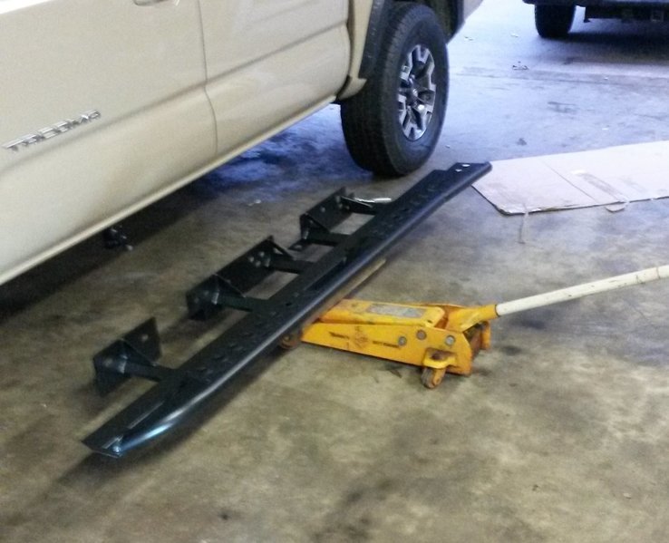

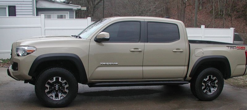

    OK, got them back from being powder coated - $100 each. Did the install by myself, as I find that when I have someone helping me, it just slows me down!! Balanced the slider on a 2x8 on a standard floor jack. Pushed in close to get holes aligned then jacked up into position against the frame. Installed hardware. Most difficult part was the nuts on a stick on the driver's side - probably due to the brake lines being in the way. Used rubber hose to cover(protect) the 2 small lines where they go over the crossmember(driver side). SldDone1.jpg sliders5.jpg

    Awesome! Thats great you were able to balance them and install them by yourself!

    Sliders are still looking great and performing as intended!
