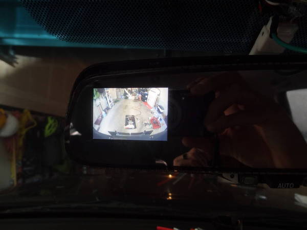

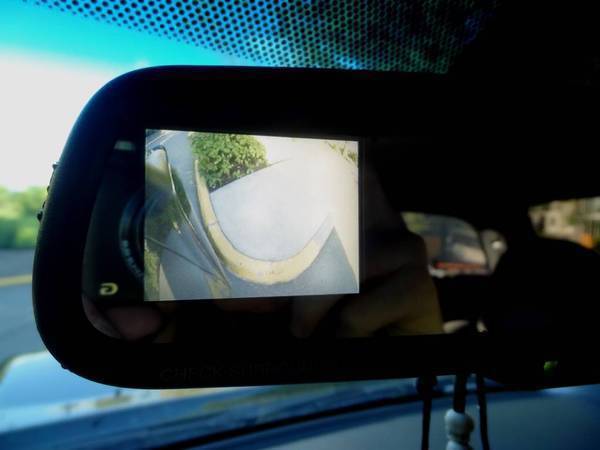

    Here is the next big mod I did to my Taco....

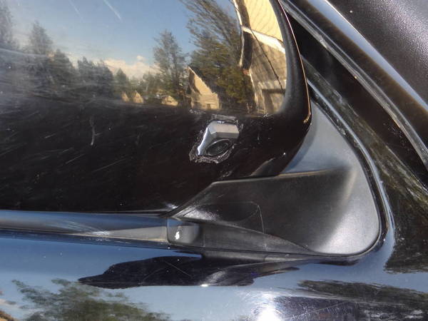

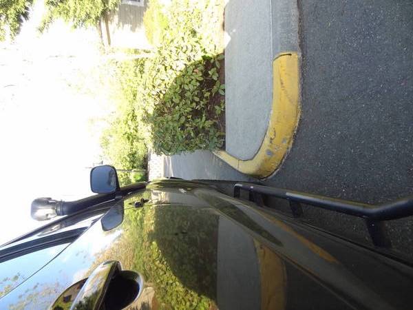

    So having a back up camera is nice...but having a backup, front, and right side camera is even better! I figured if you dont have someone riding shotgun then the hardest side of your truck to spot is the right...so I put a camera in the right mirror so I can see just how close that tree rock etc really is.

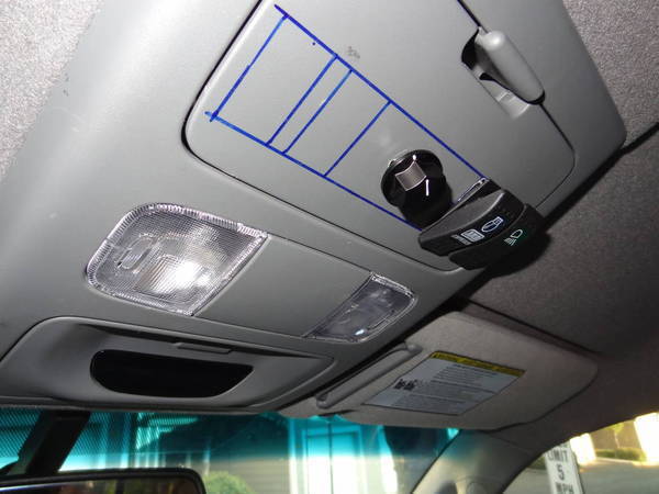

    rotary switch for the camera
    Camera in the mirror (I need to redo the RTV around the camera cut out)
    front view

    subbed, i like the camera in the mirror, a rental (infiniti qx56) had them and it was nice to have when we had to park that tank.

    I originally saw a land rover with 5 cams and got the idea

    That mirror camera is dope man... This is why I hate/love TW lol.

    Where did you move the dimmer to, or did you just hardwire it to max setting?
    I'm thinking of doing 2LO mod and locker anytime, but running out of blanks.

    Heh yea I ran out of blanks so the dimmer switch is just stuffed in my dash behind the pull out change drawer. I am thinking of either mounting them in my sunglasses holder or cut some new blanks below all of the switches there on the left.
