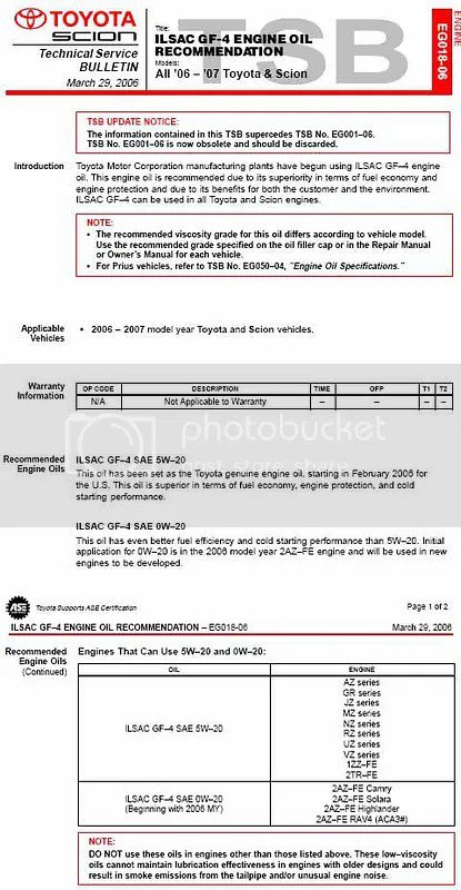

    You can use 5w-30 or 5w-20 on a V6 Tacoma. There was a TSB back in 2006 that cleared 5w-20 on all GR engines. 0w20 was not recommended for any GR engine as far as I know. It only warns you to stick with 5w30 if you are having some engine problems.

    This one dated 2015 is showing different information?
    https://static.nhtsa.gov/odi/tsbs/2015/MC-10111400-9999.pdf

    In that case wouldn't 5w30 synthetic be the best choice?
