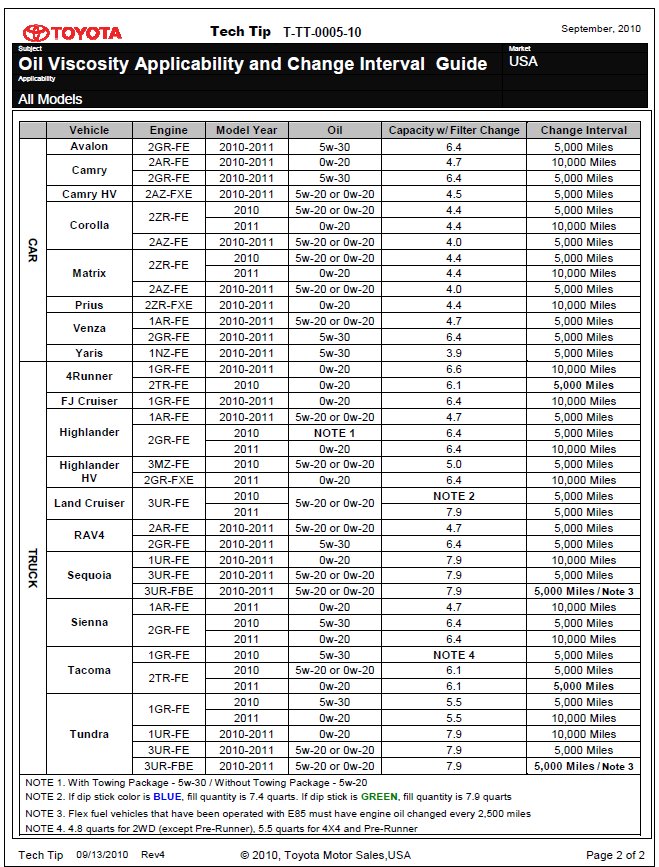

    Here's straight from the horse's mouth

    Odd to me that 0w20 is recommended for fj and 4runner but 5w30 for tacoma and tundra.

    perhaps it has something to do with dual VVTi?

    While I agree that 0w20 will do no harm, the single VVT-i 1GR was never back spec'd for it. The dual VVT-i 1GR was.....but it's also a different animal aside from the 60° block and bore. I would personally want 5w30 in mine. But 5k miles on 0w20 will hurt nothing
