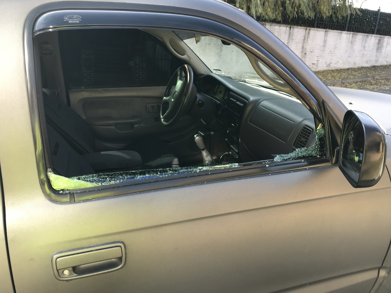

    EDIT/ installed a new window from a 1996 Tacoma and now the window rattles like crazy when rolled down a little bit... does this mean the thief fucked up my weather stripping and now it’s stretched and doesn’t hold tightly anymore?
    EDIT again: going to try to adjust the channels tonight. That may tighten it up.
    EDIT AGAIN: 1996 window is 1/32" thinner. This methinks is what is creating the rattle. Therefore the part #s are different for different years for a reason.
    2004: 68101-04110
    2003, 2002, 2001: 68101-04070
    2000, 1999, 1998, 1997, 1996: 68101-AD020-83
    So this happened today on broad daylight when I was only gone for 30 minutes. Happened in front of my house. Only thing stolen was a radar detector. Don’t really care about that... more pissed about my window, and now I have no time today to replace my starter, fix my seat or redo some furniture.
    The part # for a new window is (2004 Tacoma)...68101-04110
    There is a 1996 Taco at the local pull a part. Will an older window fit? Which windows fit?
    When I look up the fitment by part number only, it says it ONLY fits a 2004, which I don’t believe at all. The part numbers may be different for each year, but I highly doubt the actual part is different, especially for 2001-2004.

    Hmm...the glass looks the same from any power window single, ext and double cab. Will wait for more to confirm or flame me.

    Sucks brother. I had a window busted in my regular cab. I would remove the seat on that side and start the long process of removing all the broken glass. Two years later I still find a piece once in awhile. I'm assuming the windows will all be the same at least for power windows since the door is the same part number for all models 96-04.

    Make sure you clean/vacuum like crazy to clear the track. remove the door panel and vacuum more. I would think the years were interchangeable but just don't know.

    Yep I know, I’m gonna just do it myself. Vacuuming up all the glass from hidden areas will be the hardest part. Thankfully my tint held together most of it, so it wasn’t quite as big of a mess as it could have been.
