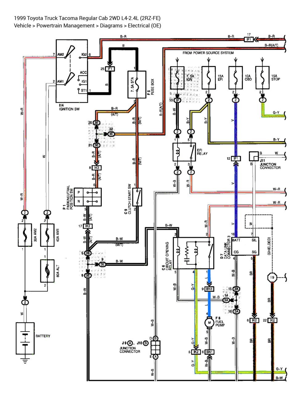

    Fuel pump killswitch is what I did, I used 12GA wire and a 30A toggle switch in-series with the fuel pump. I used the blue wire at Pin 1 of the Circuit Opening Relay, before it terminates at connector BN1. This effectively cuts power to the fuel pump with the switch toggled, and the truck cannot be started no matter what you do.
    If you do not want to toggle a high amperage wire such as the fuel pump power wire, you can also toggle Pin 2 (ECU Signal). This is a very low amperage wire that activates the coil in the relay, for example.

    Suggest to interrupt the power on the SIGNAL side of the relay.
    There are several prime relay candidates. Fuel pump, starter, EFI ..........

    The crisfix one just interrupts the relay signal....looks safest way I seen so far....and easy...

    I like this one
