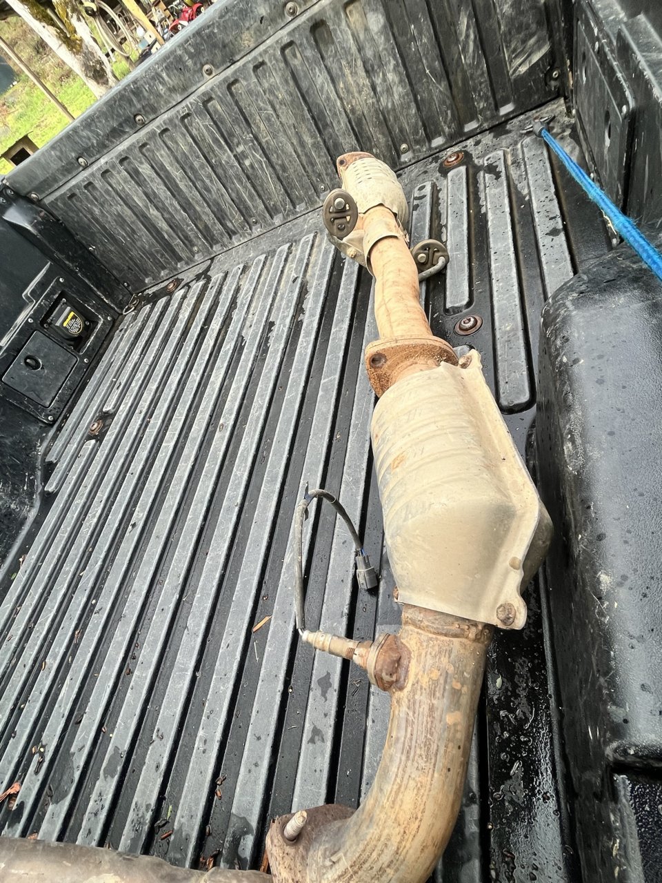

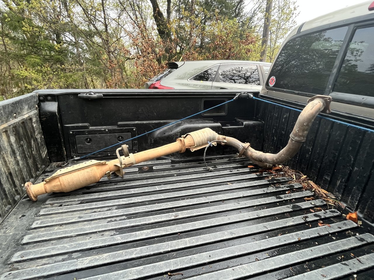

    153EC388-EF5A-48FE-8EFF-6E63A26E5649.jpg Just talked to my friend again and he said he wasn’t sure if they’ve been cut or not? He left the 4Runner on the campus where they were stolen which is an hour and a half away. He wasn’t sure if he could drive it like that? I told him to go ahead and drive it home… so until then I won’t know where the damage is? After looking at the Tacoma CATs I have here it would be stupid for them thieves to cut it behind the flanges? I think they’re only after the recycled value of the precious metals? I’m hoping we can just bolt it right in? Here’s the Tacoma 3.4L CATs I got

    I'd be surprised if the Tacoma cat bolted right up to the 4runner. Pretty sure the chassis length is different. But I could be wrong

    the 1st gen Tacos and 3rd gen 4runners are very similar, but I don't know if they share the exact same exhaust. I'd be surprised if they did

    Easiest way without pictures is to go to a Toyota dealership parts website and put in the info for both vehicles and compare the part numbers.
    What is needed for the repair will be determined by what was cut out. Some parts, like the Y pipe, are probably double walled and need to get replaced as a unit rather than just welding a piece of pipe on.
